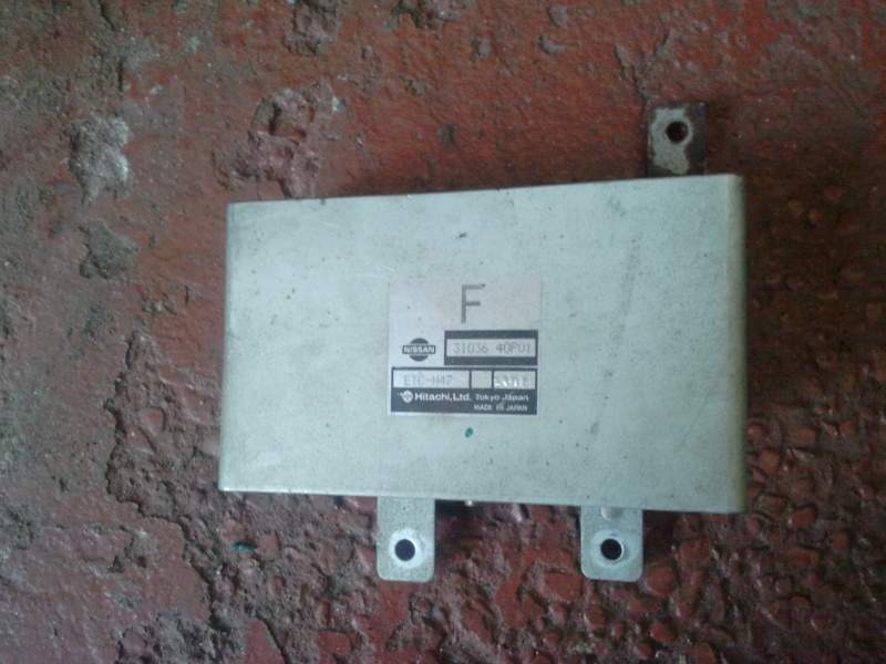

  10. If you pull the autobox ecu out that should stop the light flashing...........and no spark could be alarm problem. take this little bugger out of passenger footwell :)
