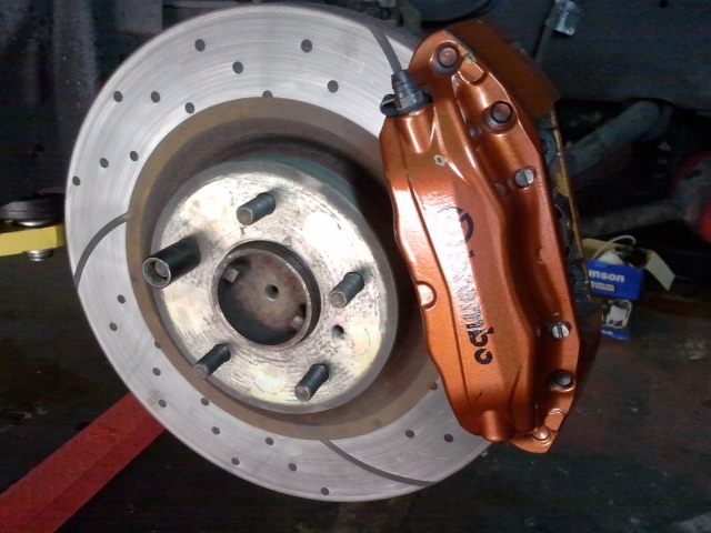

I've got the Movit set up which is Porsche 996 callipers and discs
Only thing you need to do to fit 350z front brembos is drill the caliper bolt holes from 12mm to 14mm as the 350z bolts are larger diameter
Forgot to mention that. The same applies for the R34 GTR version. The R33 GTR version is straight bolt on without drilling though.
