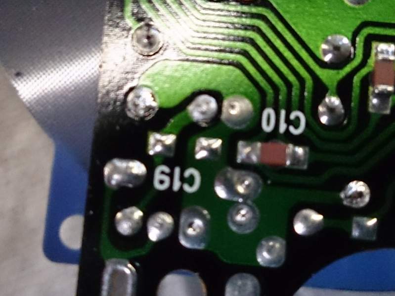

  16. Just out of curiosity, the three filled holes around c19 have nothing on the other side. Do they need to be filled to work?
  17. Ahhh ok thanks, I never did the other of the board, will check that now.
