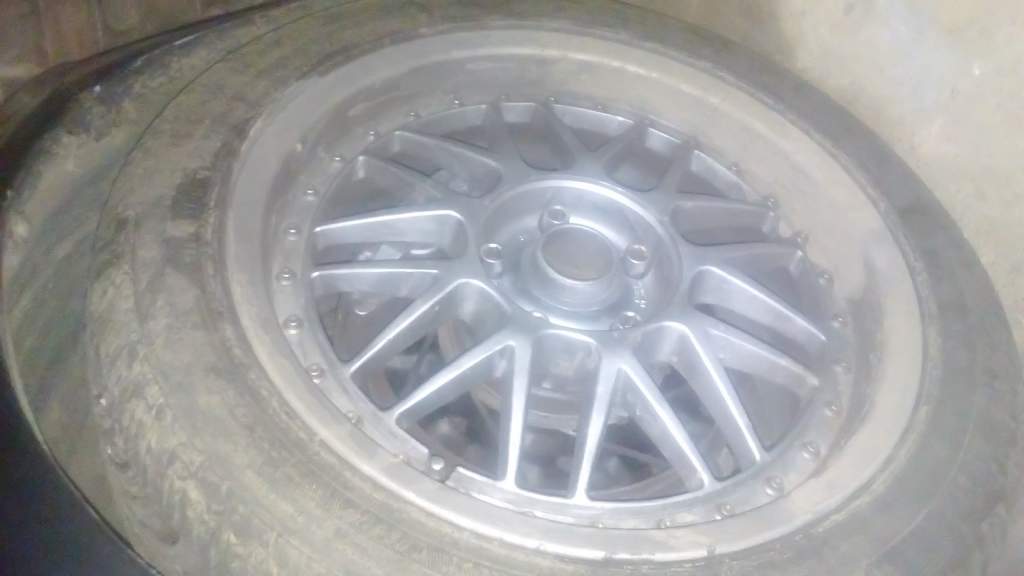

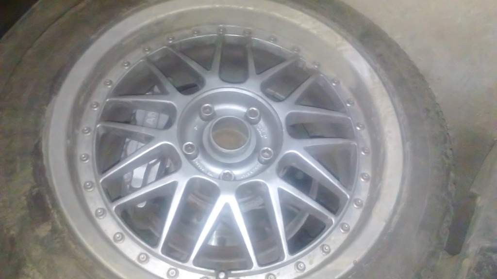

  7. That's why I wanted to know, I need a full set of caps. But I think my wheels are slightly different.

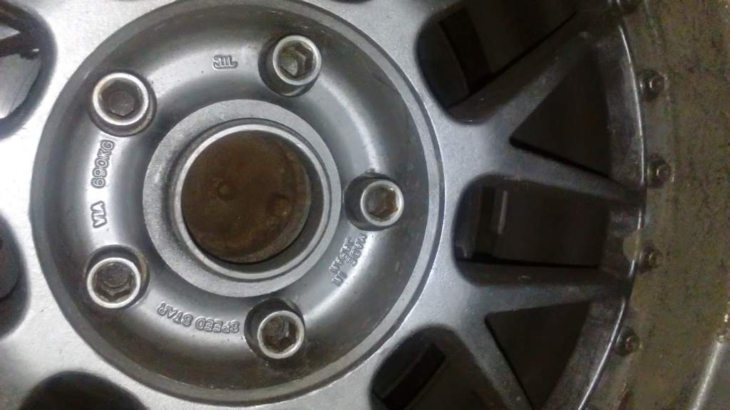

  8. Hi Torrent, Welcome to the club mate. The best place I have found for any advice you'd need. However, you may be able to help me first....;) Can you tell me if there's any writing stamped on the wheels around the studs please? Cheers
  9. Brickyard red, the best of those photos imo
  10. Hmmm, the caps on the link look like they'd only cover the hub nut hole, the original ones would have covered the wheel nuts as well.
  11. They are a split rim, two piece, from what I can see.
  12. Here's the writing, can't see any in the inside rim. I've been searching, but can't find a lot.
  13. I'll go down the garage in a short while and have a read, I can make out "made in Japan" from the photo.
  14. Stamped on the inside? The reason I'd like to know is to see if I can get centre caps.
  15. Hopefully someone knows what these are, Thanks.
  16. I didn't realise the picture was so poor, doesn't look at blurred on my phone. I'll post a pic tomorrow.
  17. Does anyone know what wheels these are? I will post a better pic tomorrow, just thought I'd test you properly ;)
