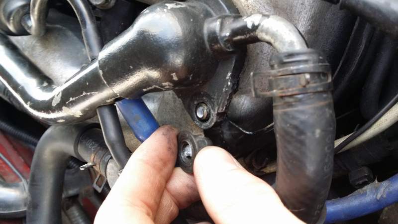

sheared bolt on plenum
Changed my spark plugs for the first time myself rather than a garage. Bit fiddly as you know all went well strut brace off ballance bar off and replaced again.
Quite pleased with myself I fired it up and it ran lovely on all 6. But with a whistle from the ballance bar on the drivers side. I had used some black gungey liquid gasket stuff but it was sucking a bit. I decided to go a bit tighter on the 2 bolts and snap! I did not feel I was tightening particularly hard.
Defeat snatched from the jaws of victory!
What do people reckon. It's definitely a garage job now.

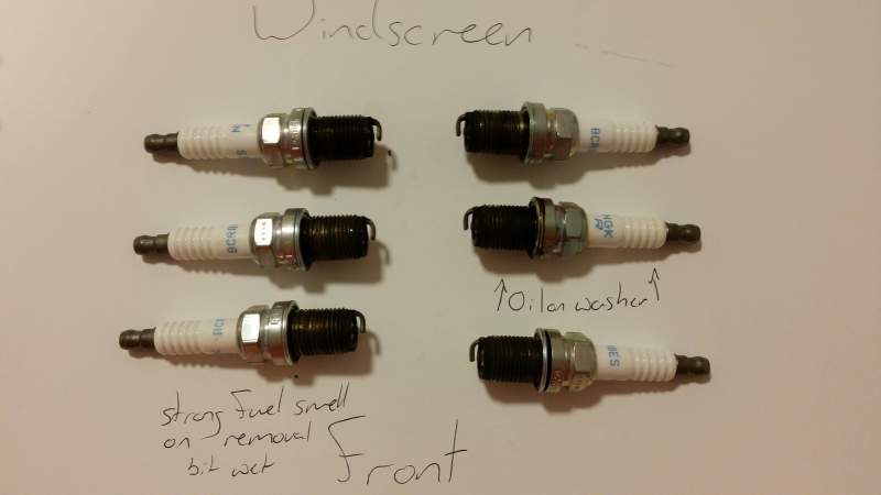

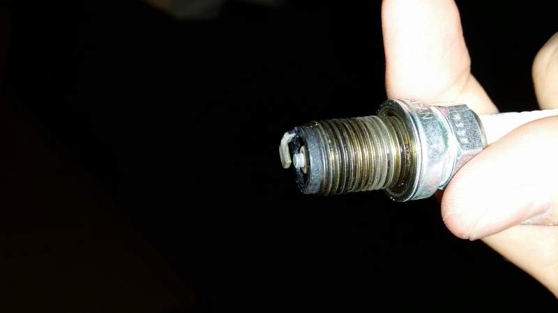

The plugs looked good to me..
Other than the fuely one and the one with a bit of oil on the washer they all looked like...
plugs look ok from the pic ... they may smell of fuel depending on how long u just ran the engine before taking them out
regarding the stud .. get some mole-grips on the rest of it and take it out of the plenum and then just use a Bolt
Good news then. I shouted *****cks very loudly shut the bonnet and got in out the cold so didn't do much investigation. The car had stood a week but I think they were fine. Hopefully a straight forward fix tomorrow.

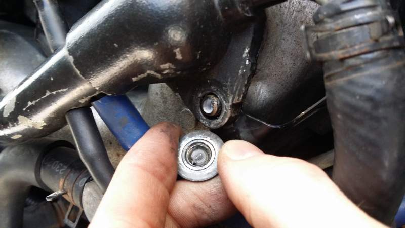

Liquid gasket of or should it have rubber rings. It seemed to have flush flat rings in there. And looking into the plenum there was some oil in there. Some not loads.
the sealing rings are Round formed but over time they do get a flat spot on them ...
really u should replace ... a little sealant isnt going to hurt
as for the oil in the plenum ... long as its not sloshing around and only like a residue it be fine
Personally, I would go for new O rings mate. Sounds like yours have collapsed.
Worth it in the long run.

na .. its only a stud thats threaded in to plenum .. it will come out
Yeah, as mark says, get some mole grips on it and it will come out. Well worth replacing the o rings as well :)

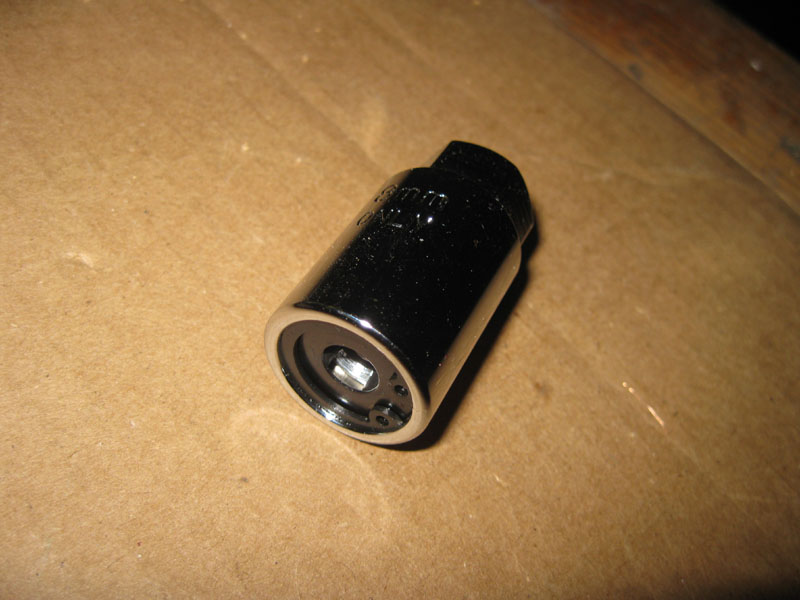

There metric size O rings and can be obtained by the bucket load of mixed for pennies via the bay of pigs...as for the stud ide use a roller stud extractor as iff you chew it up with vice grips then its a drill out job...i use this type and there worth there weight in gold..
That's good advice mate, don't really know my way around Elgin yet ill try and find the local motor factors and that tomorrow.

Think I have sorted it. Got loads of o rings from a hydraulics place and a new tube of gasket. They were all imperfect fits but pretty close. Got the stud out and replaced it with a regular bolt. A combination of new rings old rings and gasket seems to be working.
