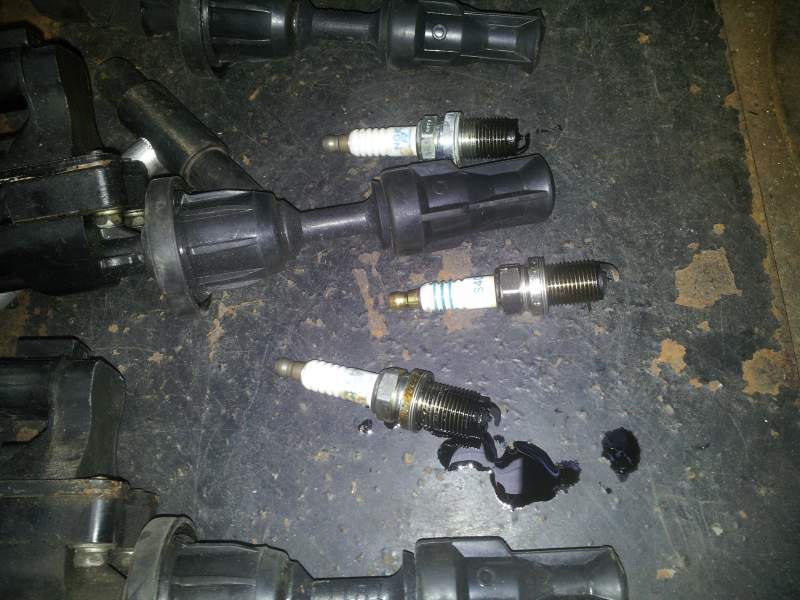

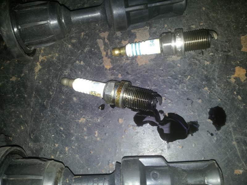

  3. It is oil wet - because it has sat like that since it was removed yesterday and is still wet, fuel would evaporate wouldn't it? @taff Re mix of plugs - it is possible as when I first had a problem with cylinder4 (plug was wet and black) I took a coil pack and plug off my old engine and put that it

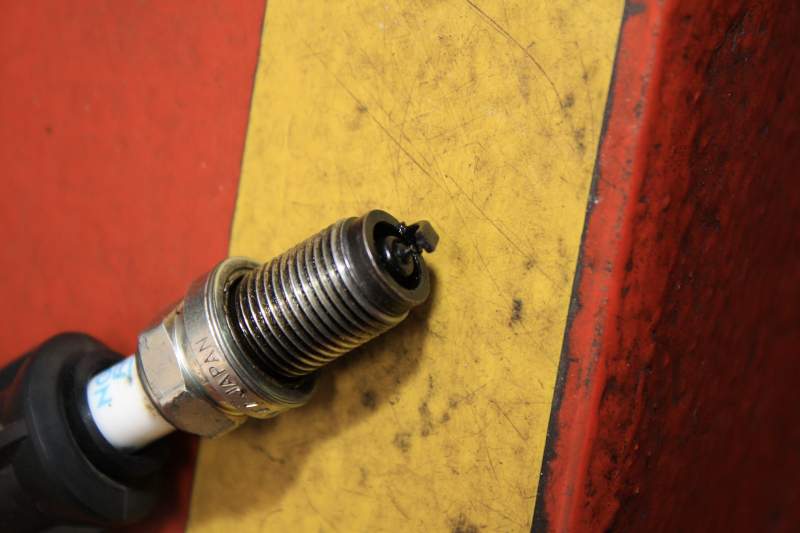

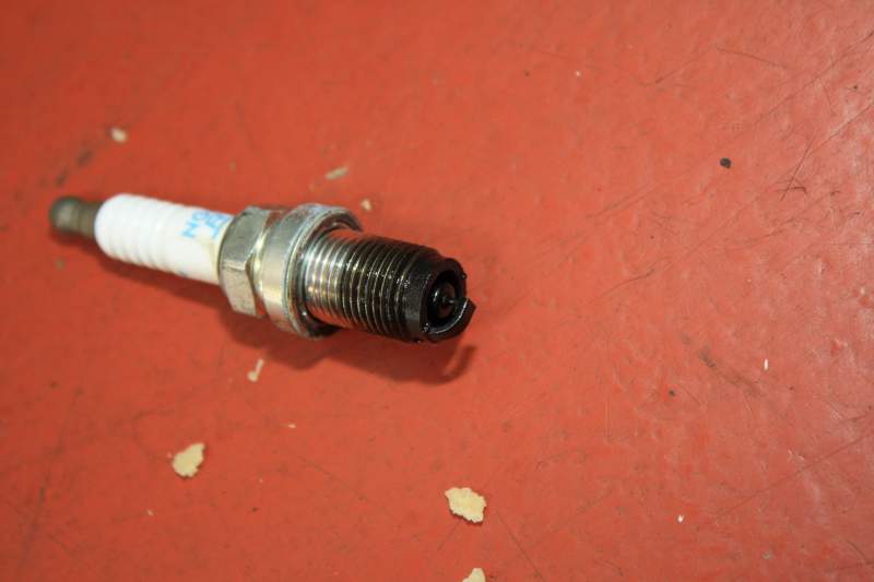

  4. Mark I just took a couple pics of other plugs removed from the engine. These have a different appearance to that one with the oil pool but a dry blackened end The ends on these look wetter (but nothing really rubbed off on my finger when I tried the one still attached to the coil pack) Do these pics shed any more light on this? Cheers Rich

  8. The local garage (who specialises in Jap cars actually) had a good look for me today, so now there are some facts to go on The compression result is 180 for every cylinder - which he tells me is perfect There is a lot of oil getting into the nearside bank of cylinders, especially the rear one (cylinder 6 I believe now someone pointed out the correct numbering) I have some pics of the some of plugs - the one from cylinder 6 is the one with the most oil as seen in the attached pics, he tells me that all came off the plug! The dry one is of the offside bank. He had a borosacope down each cylinder and can't see anything obvious wrong apart from number 6 is coated with oil and there is also some oil in 4 and 2 There best diagnosis is either valve stem oil seals or fauklty oil rings on pistons Due to the amount of oil combined with the perfect compression results he favours valve stem oil seals being the culprit. He says this is especially likely if the engine has stood for a long time. Does that sound likely? Rich PS here's some plugs to look at......
