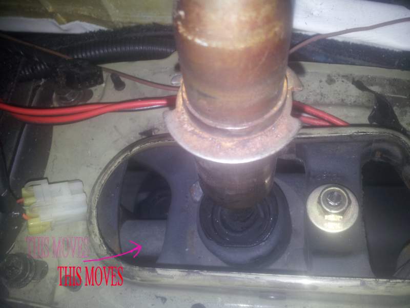

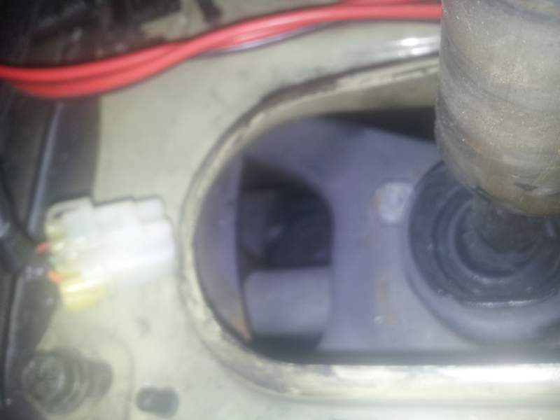

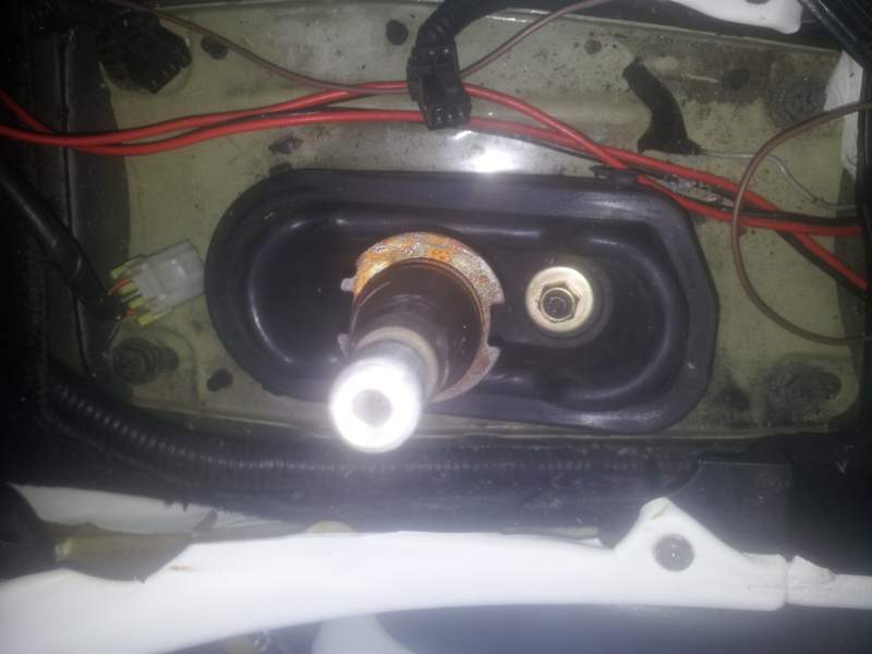

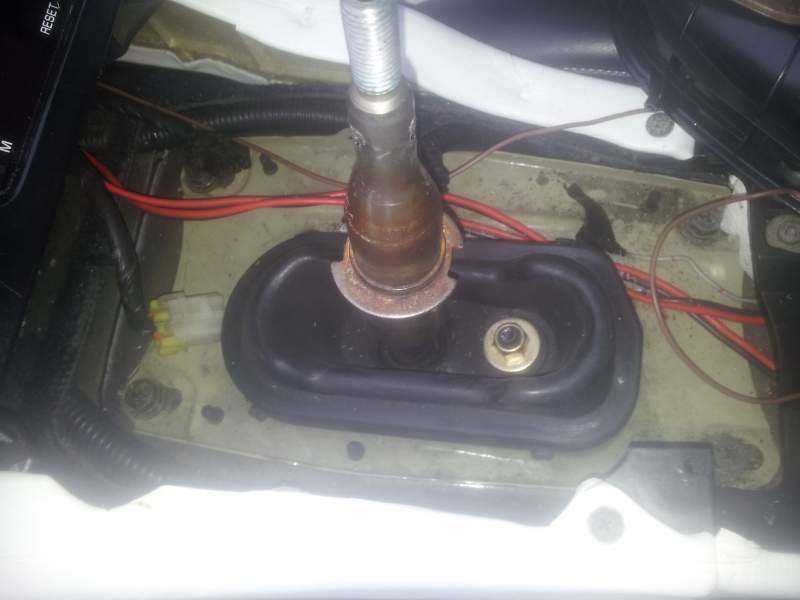

  8. OK Got it Once that nut is removed the whole whing was loose so I popped it back on once I reoved the rubber gator Can't see anything here that would stop the gearstick moving - push up into 5th selects easily, I just can't move it down past center into reverse but down into 2nd/4th is easy Rich
  9. OK cheers The two screws under the long strip were missing on mine Anyway I got there So what am I looking at and what do I do now? Rich
  10. possibly those screws used to be missing before the car was retrimmed as a lot of the centre console was loose Andy The radio panel is that just held in by clips as there are no visible screws - dont' want to break anything Cheers
  11. Err what holds the trim around the gearstick in place guys? There's a big screw under the ashtray, then all the back part unclips and comes loose - but the front end where it goes up to the centre console just under the clock is solid. Do you have to get the leather trims along the sides of the gearstick off first? Thing is I am pretty sure I've had this off before when I put LED lighting in the cigarette lighter and don't recall it was a difficult thng to do at the time before the car was retrimmed and don't think I had to get the center console panel around the stereo out to do it either Rich
