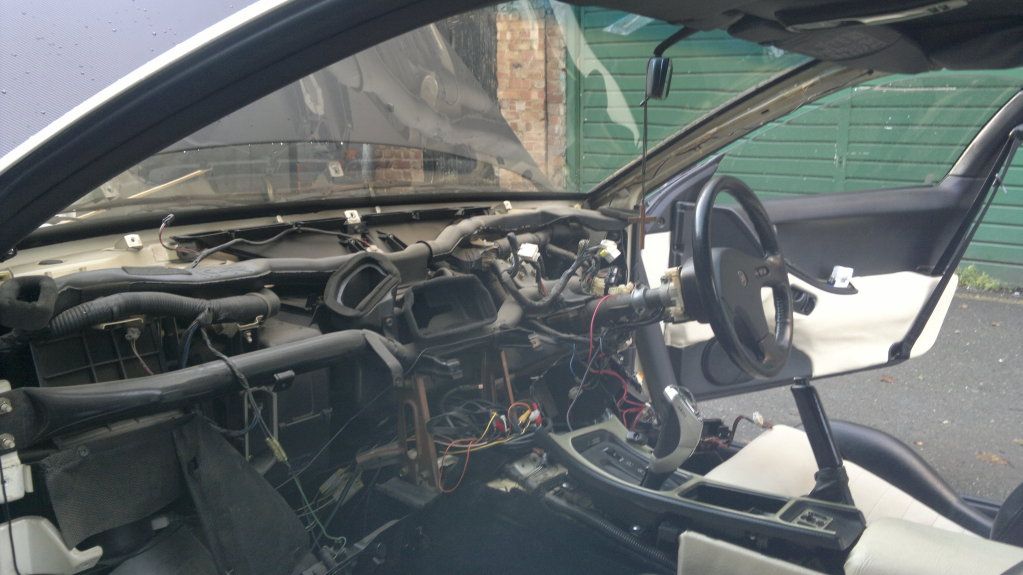

Replacing heater matrix was my first job on my zx :) you'll end up like this
It's possible to change the heater core without removing the dash. In fact my car is over at Lee Dent's in Shrewbury right now to have that job done. Gonna go pick it up in an hour

I already put the dashboard out:)),and the heater core,now i need to buy and replace

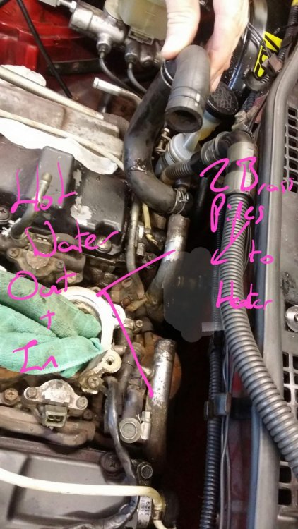

I dont know how i will connect the hoses in the engine bay,because there is no space to reach them

It is certainly tight down the back of the engine, careful use of 12" long pliers does the job that's how I replaced mine, pesky pipes.
Lots of space i know cos i done mine :)
Now,somebody can give me a photo and show where to connect both hoses from heater core in the engine bay?Because how i say ,i buy the car with them disconected.Thanks a lot for answers
If you look down the back there are two hard pipes about 16mm diameter, you connect upto these. Have you got the preformed replacement hose?
