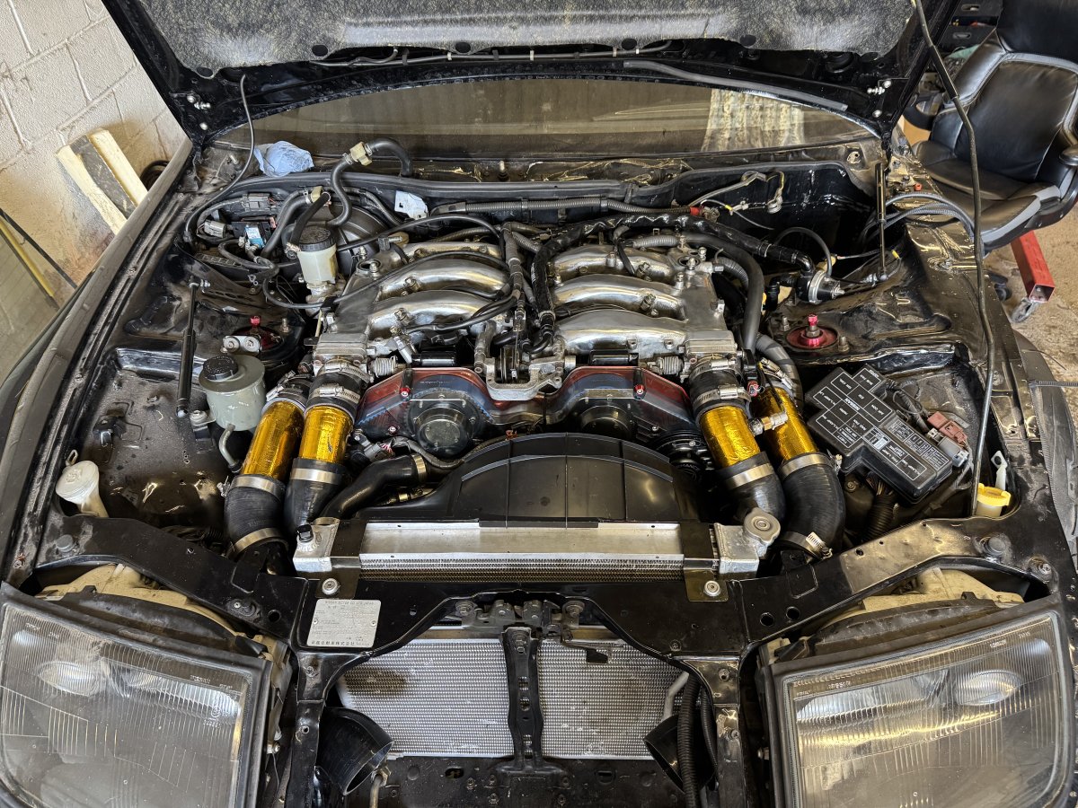

Ok, so a bit of a photo dump. plenty of progress recently, and I think the engine is pretty much ready to go back into the bay.

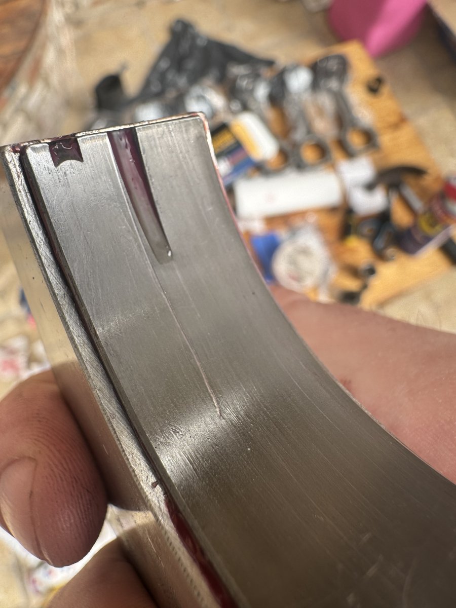

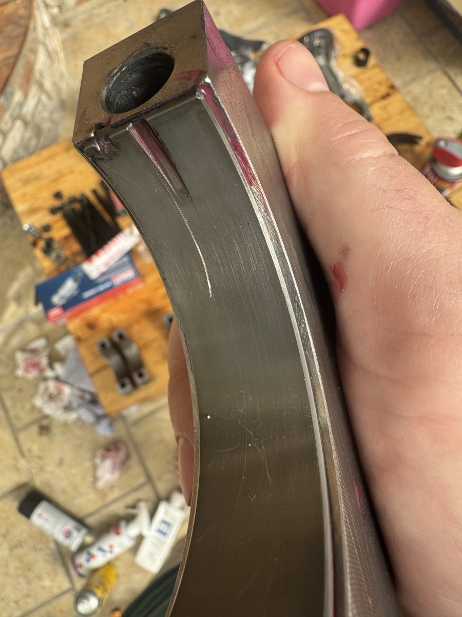

Well a rather annoying twist in the tale. Installed the crank the other day after completing all pre assembly prep. Everything seemed ok bar a slight bit of clearancing needed on the girdle plate. Took everything off and found a whopper of a scratch on one of my main bearings. Annoyed doesn’t come close! I know the block and crank were crystal clean so I can only assume that my old pot of assembly lube had become contaminated with a bit of grit or who knows what. What are the odds?!? So, yet again, a thorough clean of block and crank before sealing away on clean bags while I await new bearings to arrive….. and a NEW bottle of assembly lube by @torcousa via @nimbusmotorsport- JaiKai - MK2 - Ziggy Build

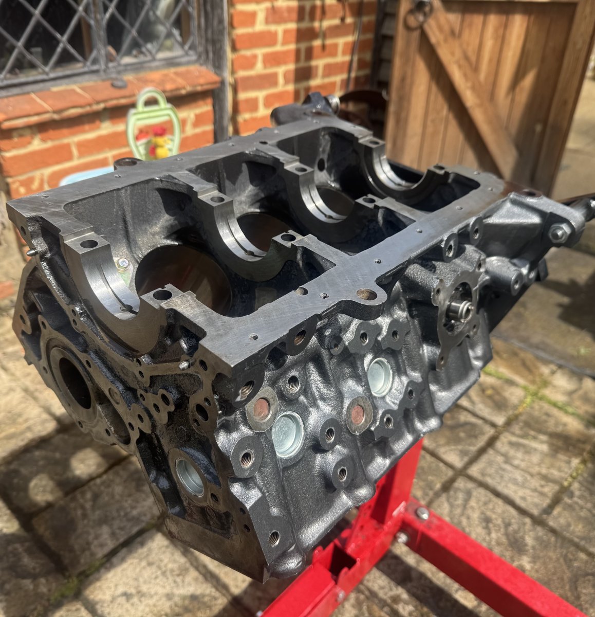

Block prep is now finished. Primered and painted in VHT Cast Iron Grey and new freeze plugs installed. Picking up a set of micrometers this eve to take post micropolish measurements of the crankshaft and then assembly can begin! - My daughter calls it Toothless the Dragon: My ‘95 TT Z
