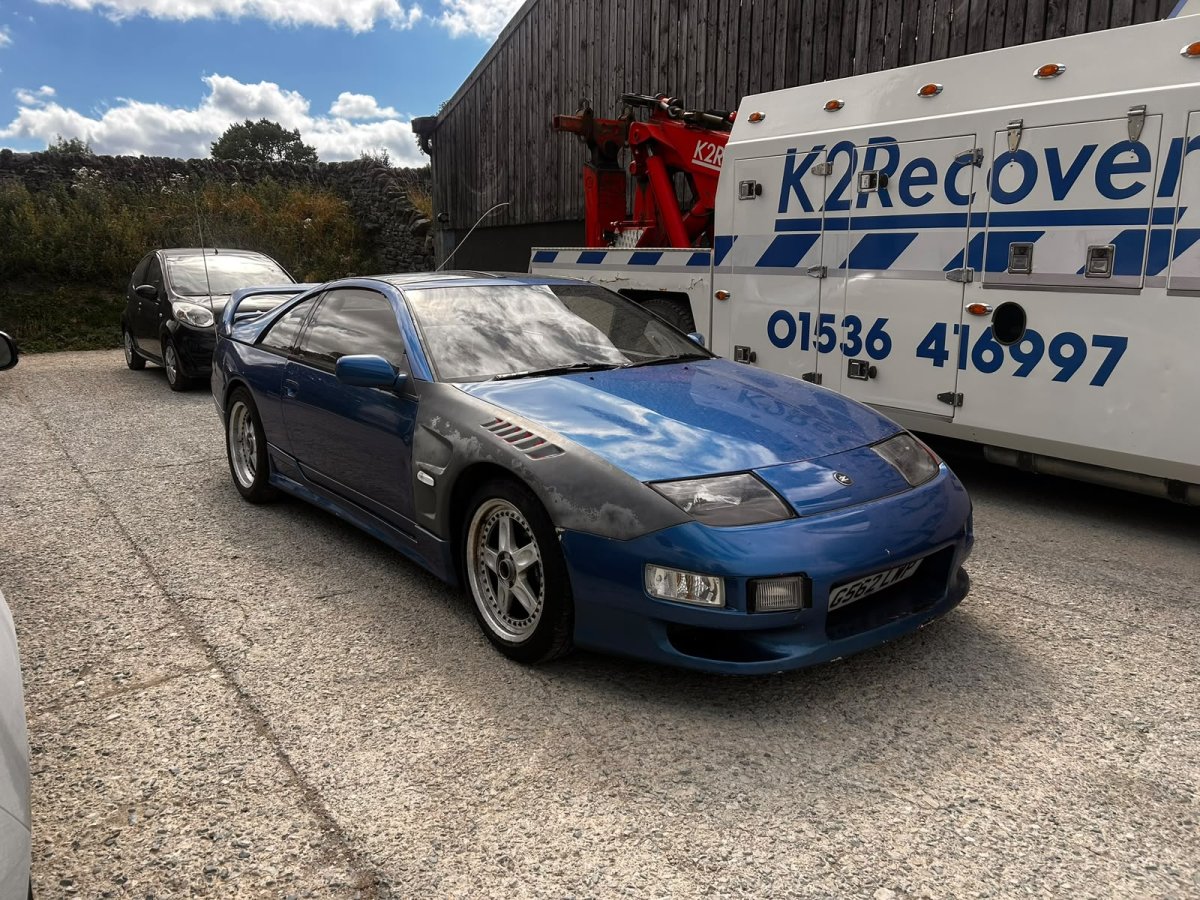

Hey so I'll make this short. A year ago I bought a sight on scene 300zx for about 6k on ebay, the seller only had 2 sales.
Now you're thinking "wow, nice shitbox" thank you! I know I'm so proud, but here's where it gets really confusing....

The car had been sat for around 6 years, there is a plate on the timing cover saying the engine was built in 2019 at around such and such miles and when it came into my possession the car only had a difference of around 200-300 miles. it ran perfectly fine although 6 years of old fuel in the tank and lines wasn't the best.

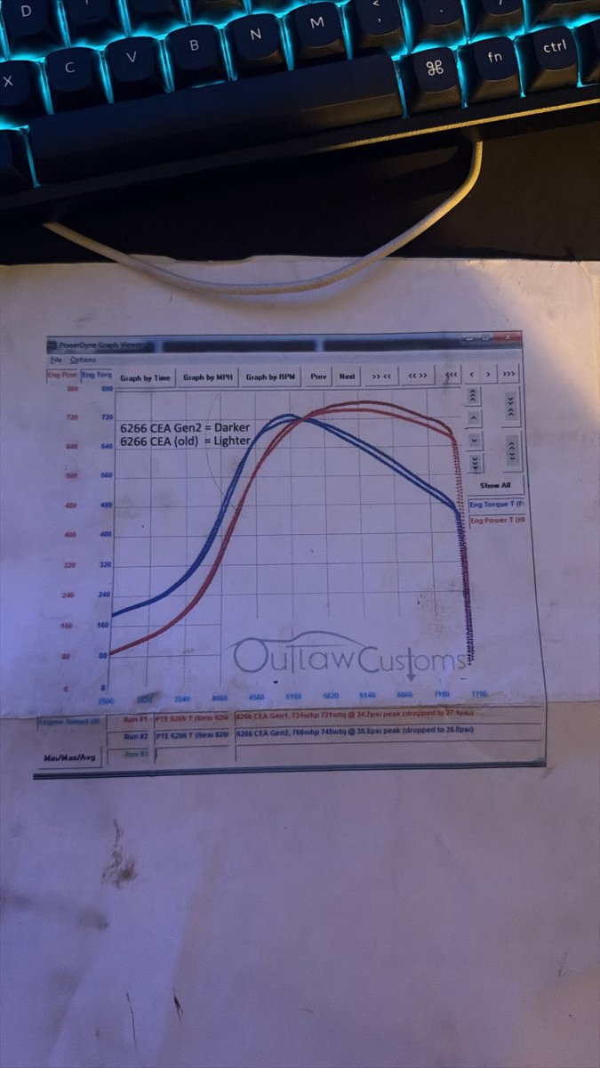

however I've yet to really test that mental bhp figure in fear that I'll send a piston into orbit without knowing more about if things have changed since etc.

Mikey Bean didn’t get himself the best wrap but when ever I met him In real life he was a nice enough guy. I expect if you can track him down on FB or something he’ll remember the car? I take it there’s no break down of what’s on the car? A set of rebuilt turbos and an engine build won’t get you those numbers, that car would need some big turbos, injectors and an ability to breathe in and out. See if you can see the turbo rear housings markings, injector colour etc.

Yeh I tried to find him on Facebook but no luck, I was really hoping to talk to the guy hence this thread. I imagine with them numbers the internals are forged and I know for a fact that the turbos are precision turbo PT6266 gen 2 CEA units (good for 800) this thing is getting detuned though to 500 because 700+ is just asking for it to get married to a tree, and better overbuilt and reliable than overpowered and regrettable
If you pop the spark plugs out and pop a bore scope in there you should be able to read the stamps on the piston crowns. Stock ones are marked 30P.
Have a look around and speak to a dyno operator, explain and get the AFR recorded and they may even be able to see the map. Do you know how much boost it’s running? I assume it’s got an EBC?

The horse power is engine rather than wheels. The business no longer exists. If you searchfaceboom for Mike Sanford, you'll find him that way
