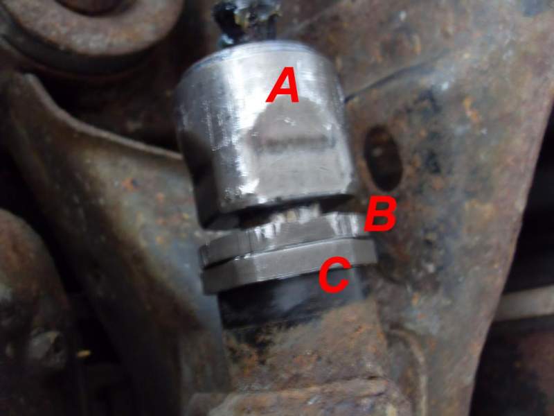

  1. Ok have use your pic to show it and marked the parts A B C So on the end that you have undone the arm from (A) you now only have B &C fixed in the steering ram, you need to release these, C is the locknut and needs undone slightly with water pump pliers or similar, once this is undone both B & C will undo as one unit and remove completely. Now you can see the ram shaft, if you look close you can see it has flats on it a 14 mm spanner will fit these, caution before you do anything else you must screw the old arm back in, not fully tight but you will see why in a moment. So back to the other hicas arm with a spanner on the A part and the now 14 mm spanner holding the inner ram shaft you can undo the other arm. Now if you had not put the old arm back in at the 14 mm spanner end as the tube is hollow it would have squashed it out of shape!! So now with both arms loose remove them both, reinstate B & C and tighten, loose fit both new arms and tighten against each other with two spanners, and that's it. Jeff TT

  4. Yes its a steering ram not a steering rack. Jeff TT
  5. You need to take the gaitor off the other side and put a spanner on that one, give the spanner on the one you want to undo a hard rap and it will come undone. Jeff TT
