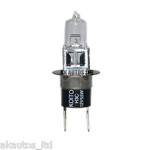

Ok so looked over the www and cant find any replacement low beam bulb, been to motormania and halfords and theyve never seen a bulb like it, its the one with 2 spades, does anyone know where to get one from otherwise ive got the part number and ill ring nissan tomorrow :bored:
cheers Tom
Dipped is H3 import is H3C, but can be modded for a H3 and main beam is H1, the bulb holder with two spades is just a carrier for the H1

Bit costly at a tenner, not long ago they were half that but if you need one quick.
