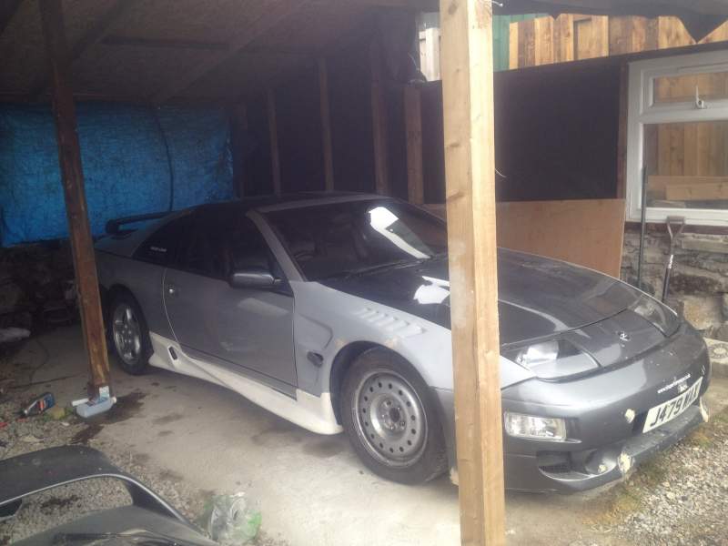

  9. Progressed a bit more tonight, all the bits fitted, side skirts, new clutch pin works a treat, handbrake now exists along with decent brakes ! Now looking sorry for its self as I've just stripped t again ready for paint !

  12. Made more progress in the few hours I've had although doesn't look much! All the lights and wiring fixed, rear strut brace fitted, one rear hub changed, brakes bled, longer clutch slave cylinder pin fitted, p/s bled and now moves under its own steam and stops! Fitted the rear spoiler, carbon from a car I'm sure you all know! Car will be white so what does everyone think of it?

  19. The passenger side window isn't working on the switch or the drivers side switch. Checked with a spare motor and hat doesn't work so ruled that out. What else could it be, any ideas?

  22. Latest news is she lives, got loads done today, brake lines, clutch line, arch liners and exhaust all on and she runs! Pics soon
