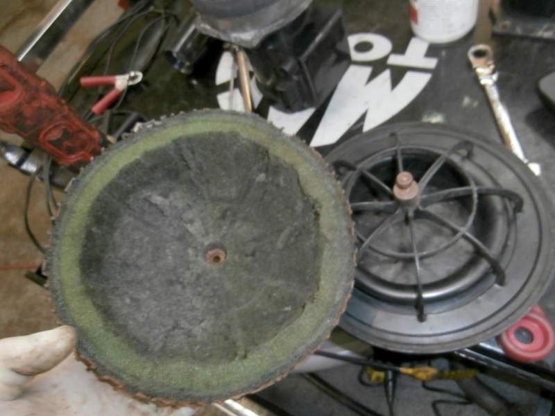

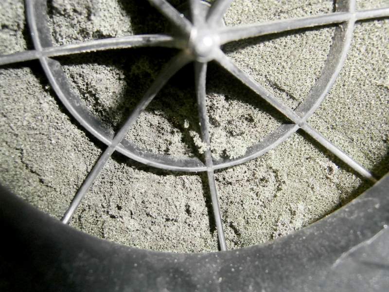

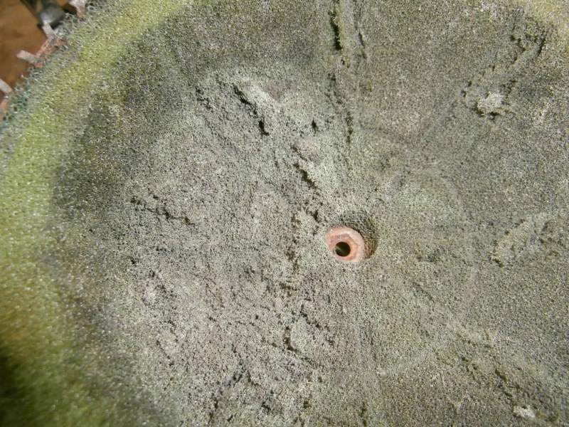

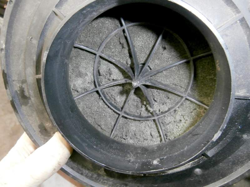

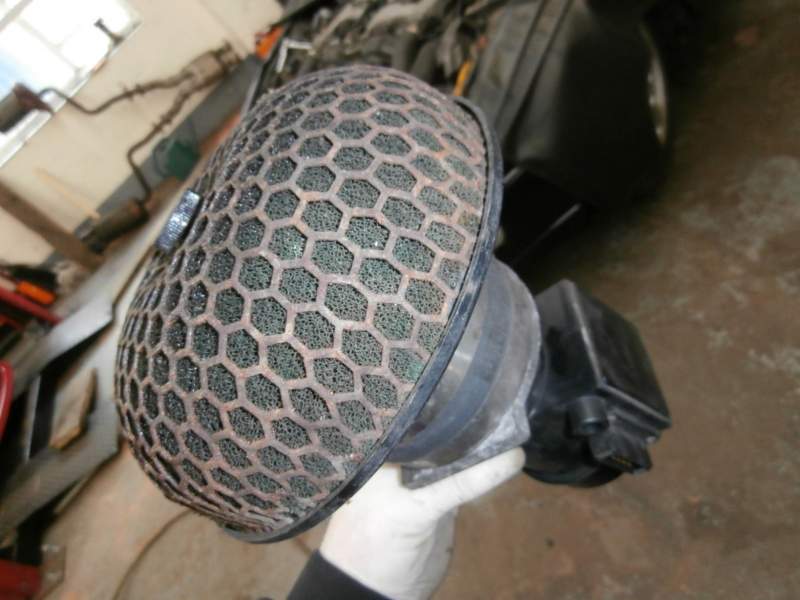

A zed came to the workshop last week presenting some odd running problems, the ConZult was showing reasonable settings but if left ticking over slowly get slower and stall,the pick up was just not right and unstable, on a hunch I removed the elderly looking HKS mushroom air filter and once the afm was seperated it was clear the foam filter had started to break up and the afm air flow was getting blocked by the foam bits, a new filter and a clean out and all was good again, worth checking if you have one of these kits fitted.
