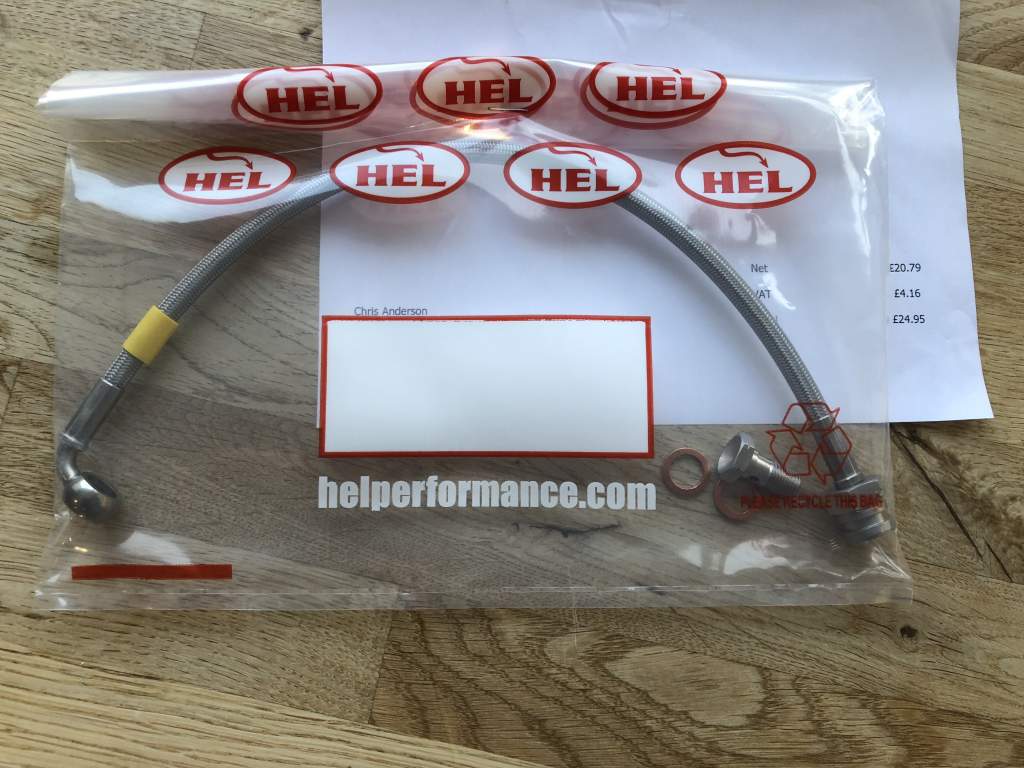

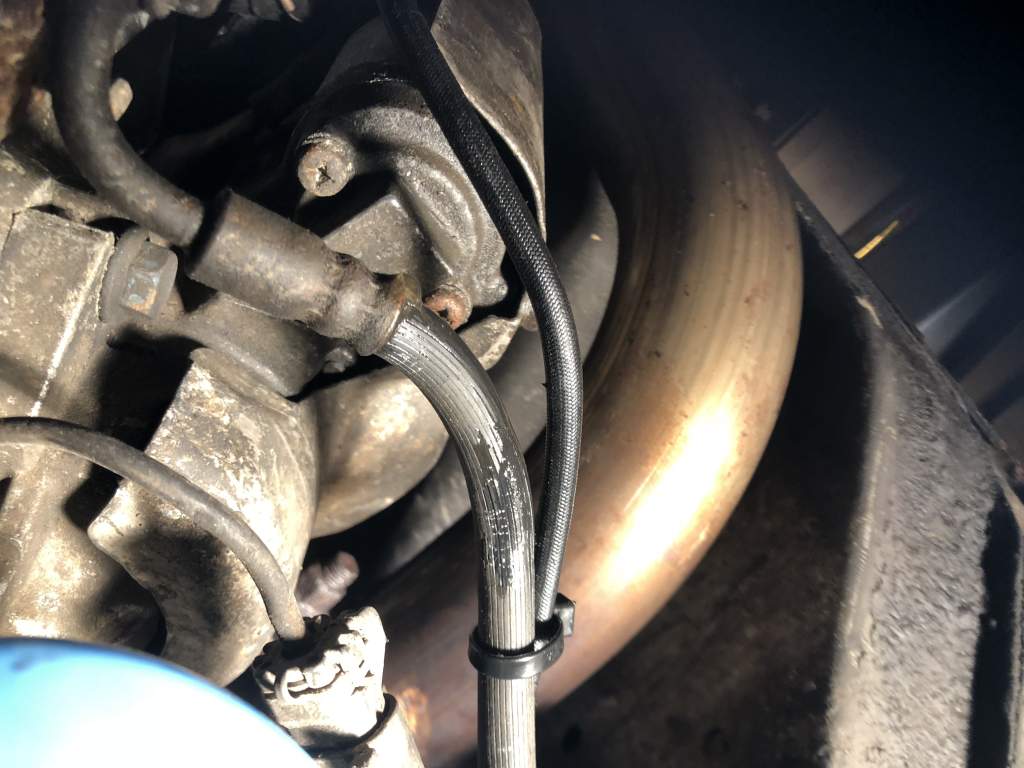

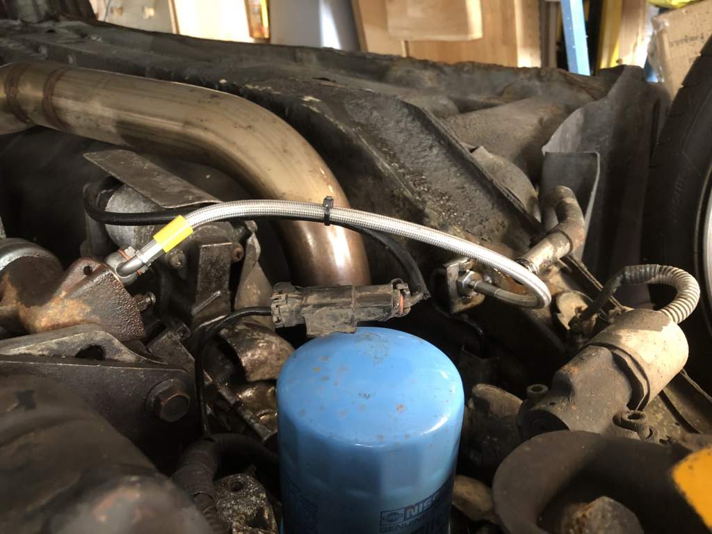

Today I finally got around to replacing my split flexible hydraulic clutch line for a nice new braided line. It was very simple to replace and the new line fitted perfectly. Unfortunately I didn’t have time to bleed the system but hope to do this next week.
Old leaking line...
New Hel line, £25 from eBay...
Fitted...

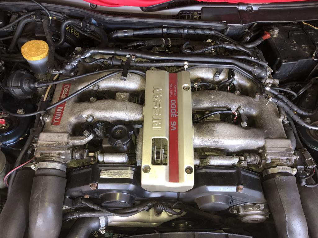

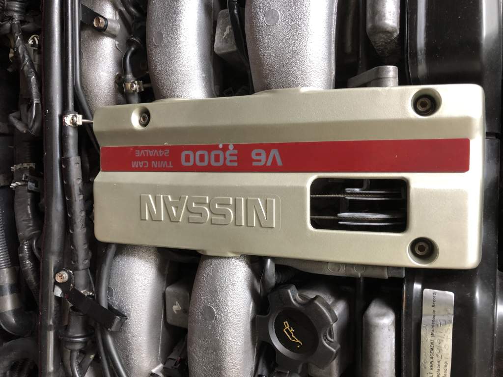

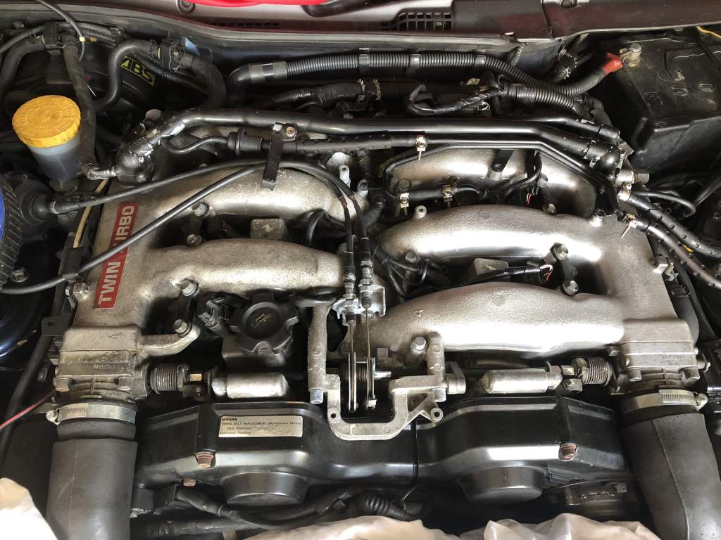

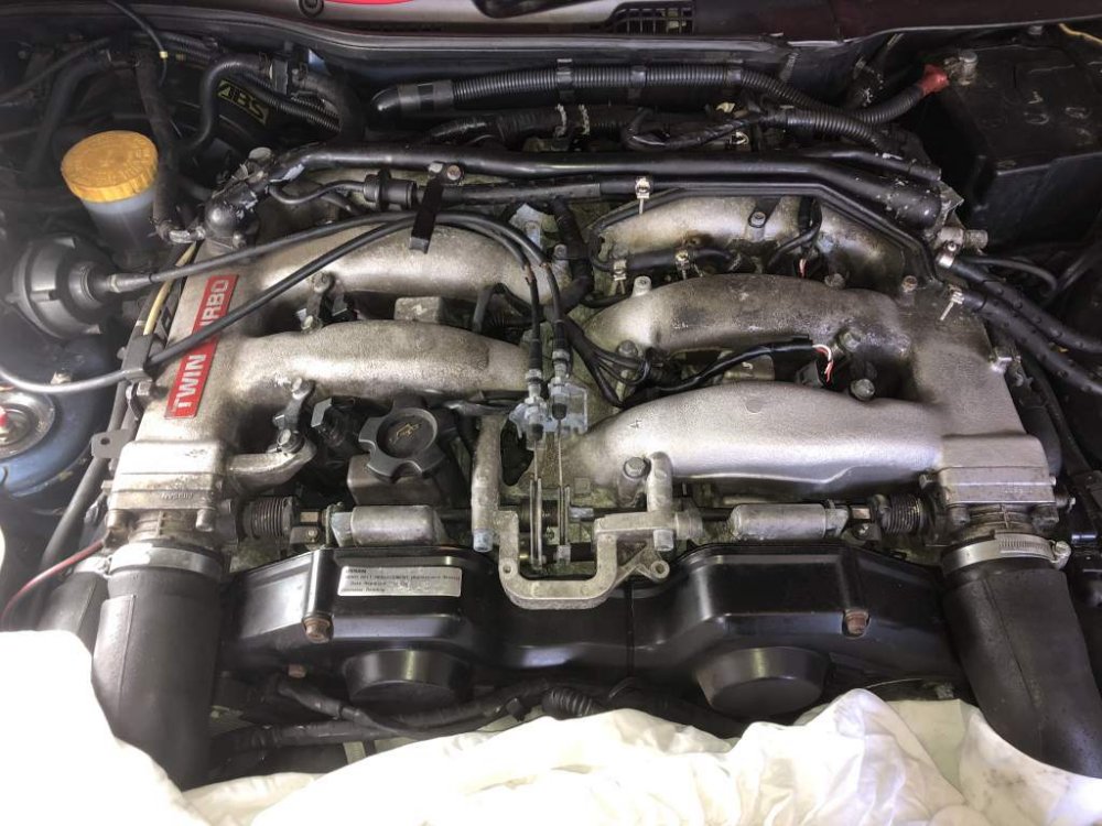

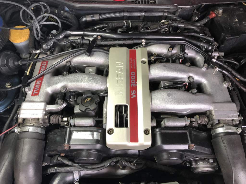

Whilst at the recent Boxhill to Brighton summer run I was asked to pop the bonnet of my 300zx. This has always been a shameful task for me as my engine always looks grubby. Previous attempts to clean under the hood have always been disappointing, I’ve tried steam cleaning and G101 with both products having little effect. During the recent shaming Andrew suggested I tried brake cleaner and I’m very pleased with the result. I only had a few hours but here are the results so far...
Little test area...
After I’ve cleaned everything I can get to without unbolting parts I’ll try and get parts off for painting. I’ll be looking for advice on what can come off simply.

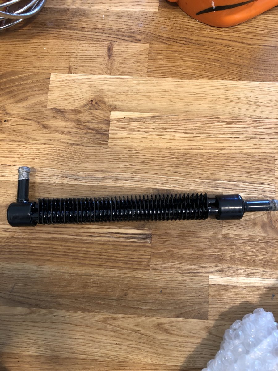

Thanks Andrew. The problem is I now want to start unbolting parts to send off to get painted but I don’t know what parts are simple and safe for me to remove. For example is the balance bar easy to remove (just a few bolts and gaskets) or will it need “setting up” once it goes back on?
You can just unbolt and refit. Take care pulling off the vacuum tubes that connect to it. The bar uses three O rings (which are
a non standard size) as seals which can degrade over time and may require replacement.
Ref: https://conceptzperformance.com/nissan-infiniti-nissan-oem-300zx-balance-tube-o-ring-set-z32-14033-30pkt_p_1110.php
Thanks Andrew. I’m doing a big Z1 order in the next week or so, if you can think of any other nicnacks please let me know. :wink:
That's much better! I got through a fair number of BC aerosols doing mine using a toothbrush and
paint brush - worth the effort.
Good idea; cheers Andrew - I must try that....:wink:

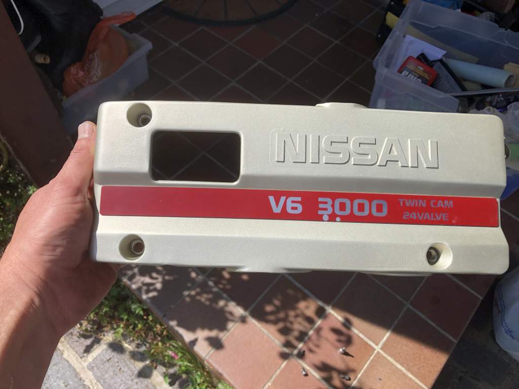

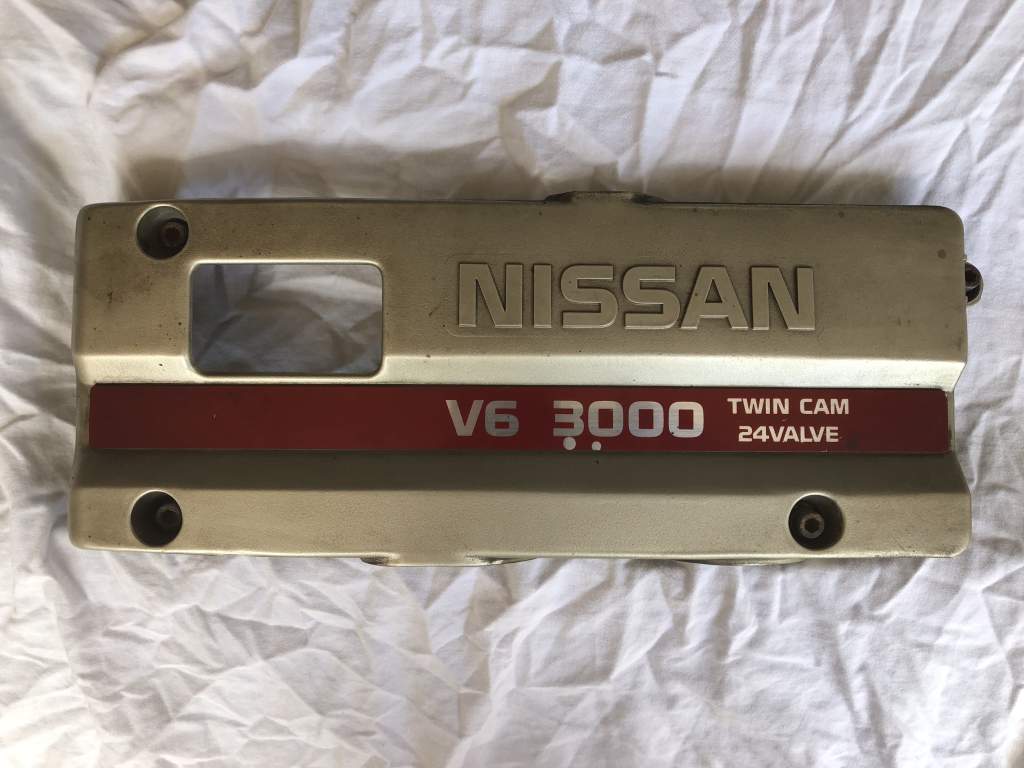

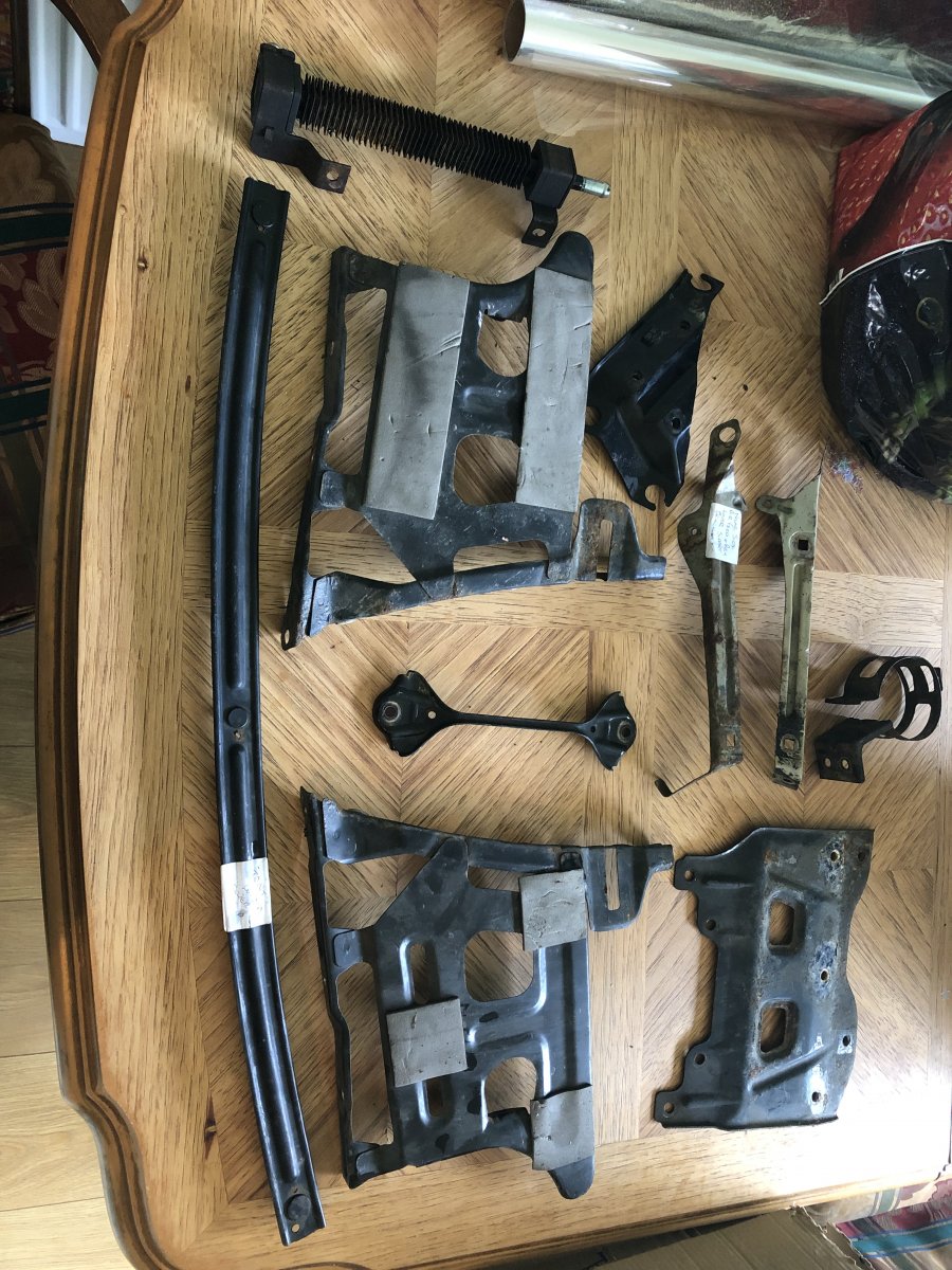

Christmas has come early for me today! I got a call from RalTech Finishers and Macro Developments to tell me that my 38 items had been powder coated and my outrageous amount of bits and bobs had been plated. I’ve taken a few pictures of some of the items before and after the work for your entertainment. Most of these parts will likely never been seen again other than by the eyes of Jim at PowerZed.
Now I have the fun of putting it all back together again before I strip and send the next batch off. ?

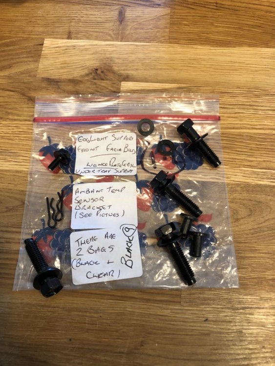

A few parts arrived today. Again nothing flashy but still important nonetheless. ?
It’s the little things...

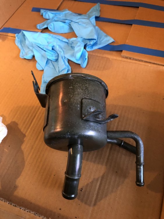

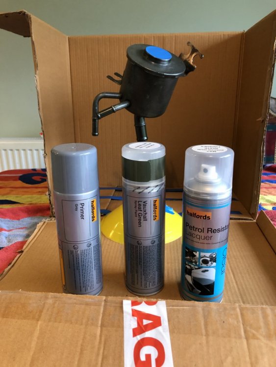

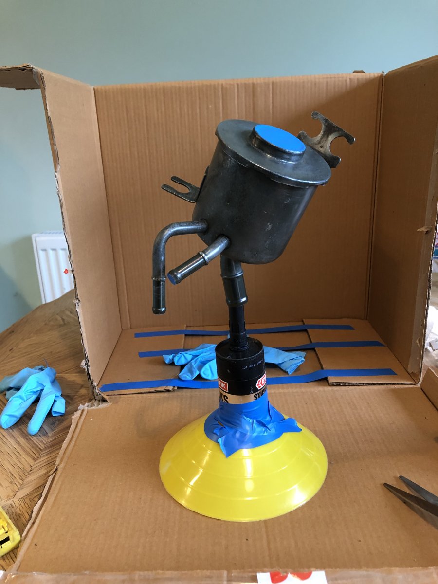

I’ve started the power steering pot refurb today. It going very well, only very minor surface rust in a few places to deal with and a bloody good clean. All tapped up and I made a very sturdy stand for it to sit on so I can get round all the funny angles.
One question i have is how long do long do I have to wait between primer, colour and lawyer. I know about 15 minutes between coats but do you think 24hrs between paint types?
Edited by Chris300
7 minutes ago, JaiKai said:
Very inventive stand you made ?
Lol. I wanted something that left every external part available to paint, still be able to pick up the pot to paint the underside and be easy to put back on and spin around. I did make a vid to show how stable it is but can’t get it to upload. (Obviously I’ve bunged up all the holes)
