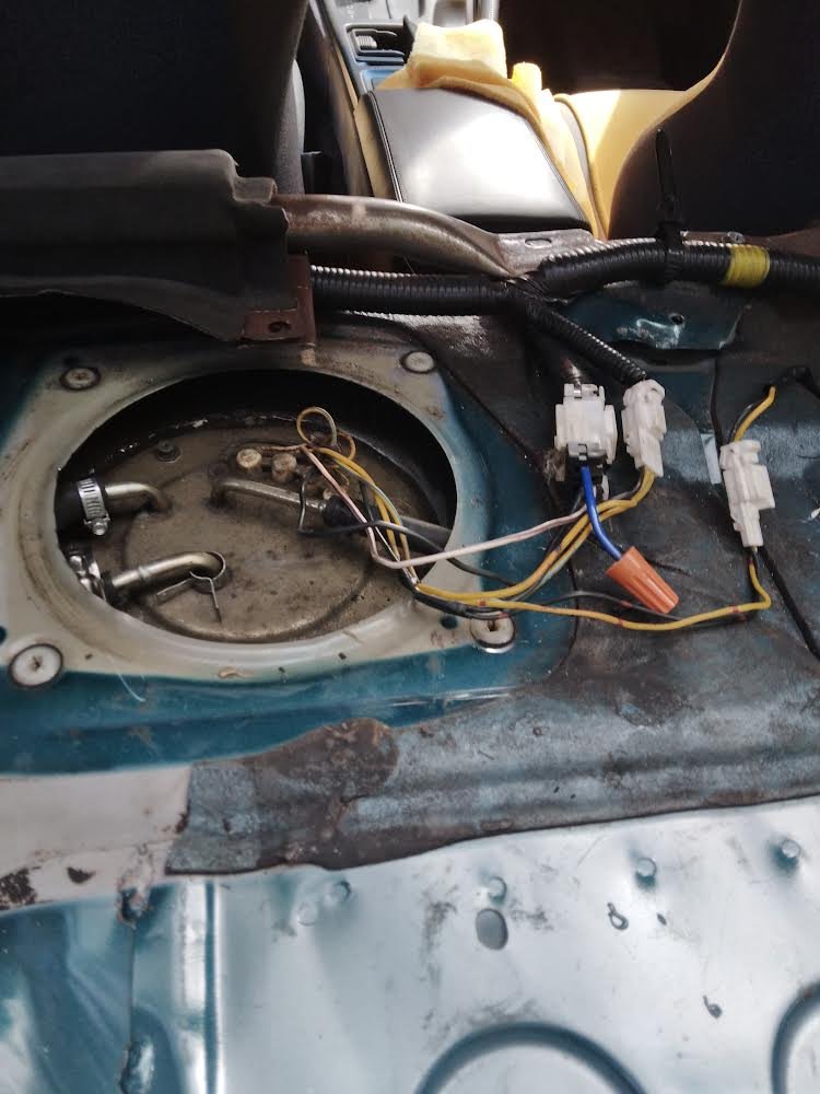

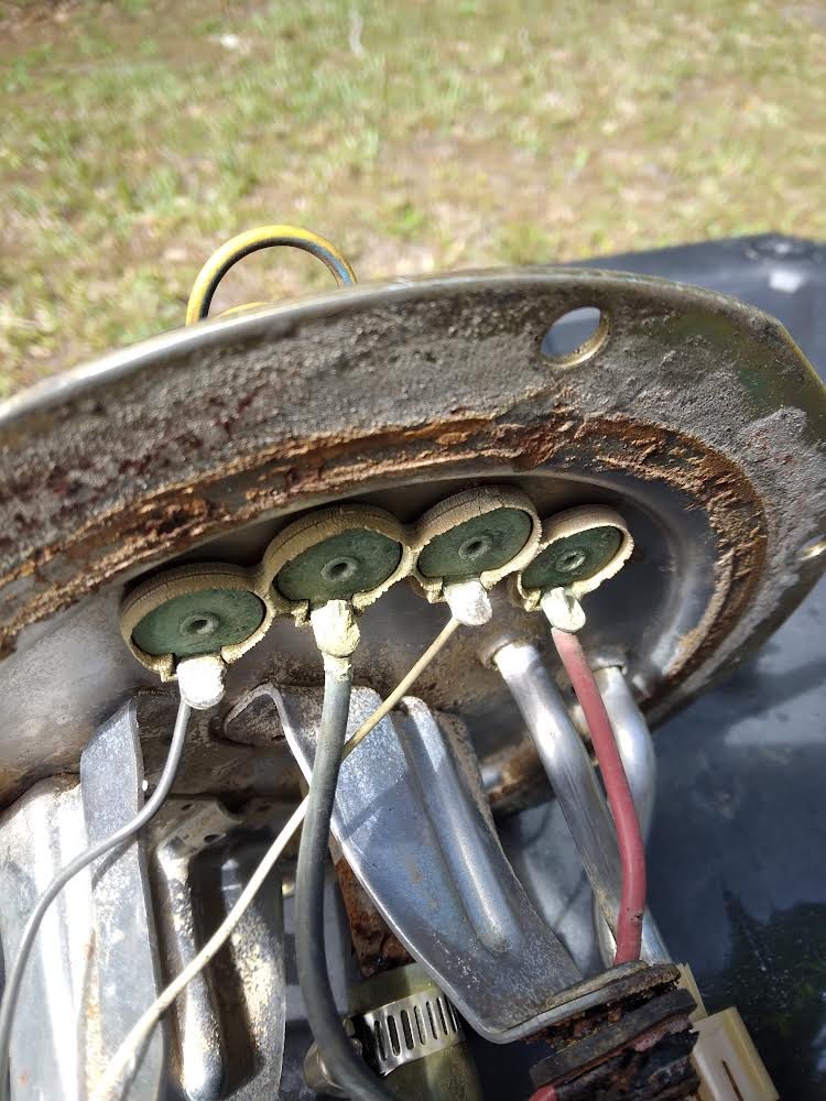

  2. Thanks for the reply jaikai. I did a lot of research before I joined this club and saw someone by passing pump on there car and it was there fuel pump ecu that went bad but my car starts and runs the other persons didn’t so I’m like I don’t think the was the problem. My pump didn’t look that old and was still working just making a lot of noises while running the noises would change every few seconds. Any way I cleaned as much of the green corrosion as I could and added a little more solder on all four wires then cleaned off all the flux from soldering. Reinstalled pump and tested and my fuel issue is gone now. The corrosion was causing car to not get enough gas at times.
  3. Red wire not much solder
