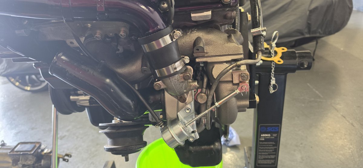

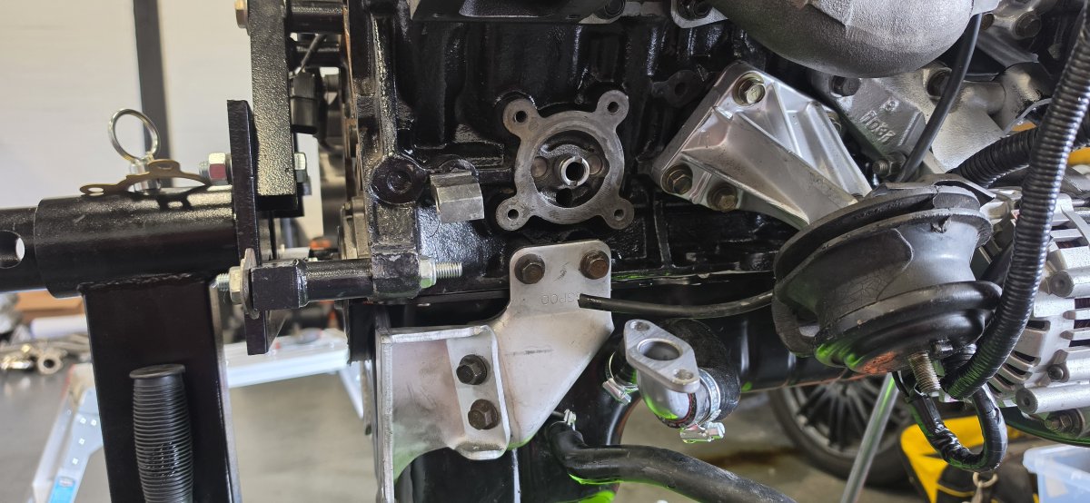

Right so my issue is a dry oil pump as its new and likely not primped properly,
With the engine cranking over its not picking up fresh oil so i needed to somehow remove the oil tree and force oil up lines.
Only way was engine out again then remove the turbos, then the oil try to expose the line to the pump.

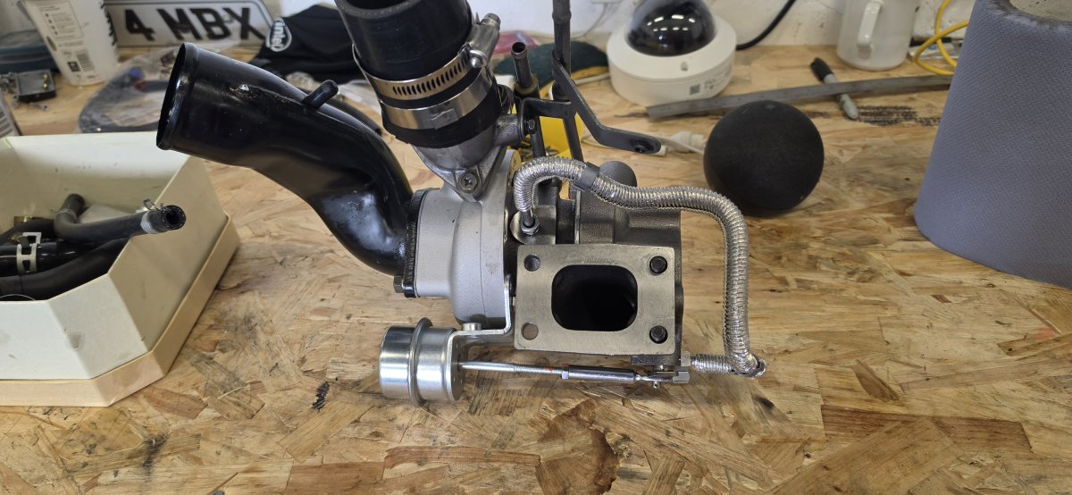

Didn't like the new braided oil lines so removed them and went back to the oem ones.
Which was nearly new.
The new style lines along with the oil restrictors stopped the turbo housing being clocked properly
So much better fitting after they were back.

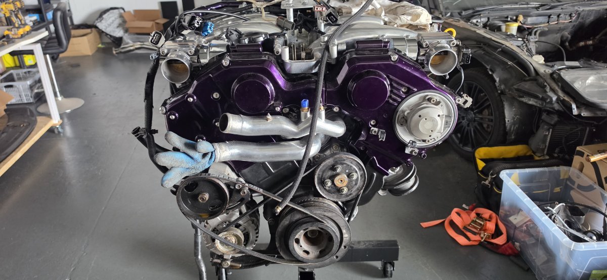

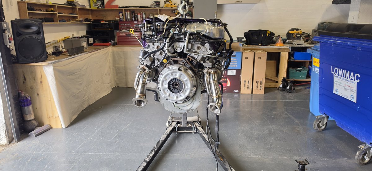

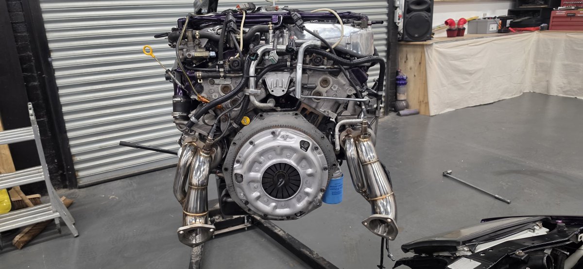

New engine oil arrived yesterday so had some time today and got the engine how i liked it ready to be put back in.
But this time i've decided to move the wideband sensors back to the downpipes as i still dont like the location the test pipes
that i have with the proper bungs put them at and for my likening its a little low.
All ready to be put back in the zed.

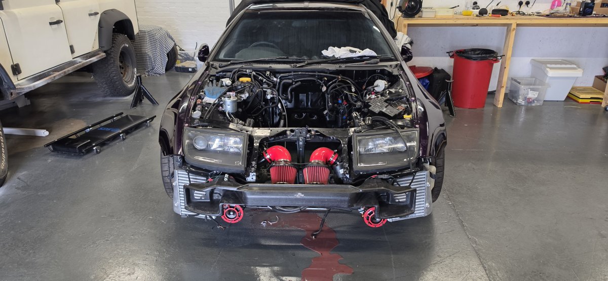

Major f*ck up just over a week ago.
And its taken me nearly a week to come back to this.
Just over a week ago we got the zed started although with a bit of fuelling issues.
I decided to take it out the garage for the first time in 2 years nearly and all was going well, managed to work my way round the block and back.
The issue was that i drove out forwards and then rather than reversing i went straight back in facing the opposite way.
Turns out the zeds front bumper valance was too low and i've managed to crack it in three places. :(
Email now into car.mad to make me a knew one along with a spare.

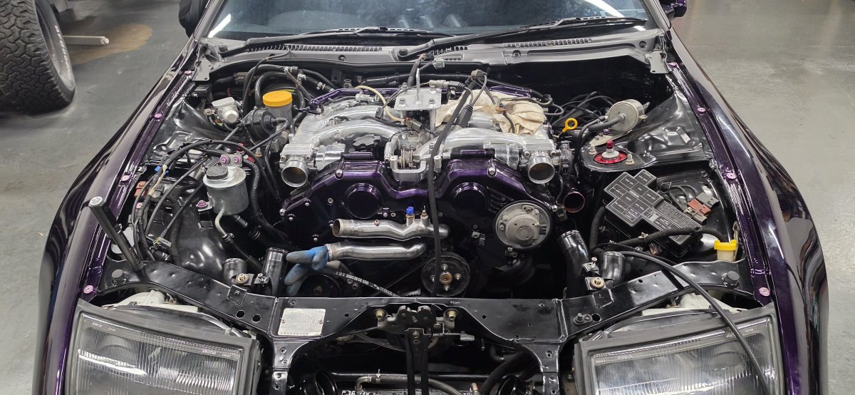

So engine tune session today and managed to get the engine purring if not with a few issues along the way.
First issue was we found a vac pipe leak after tracing the ecu vac sensor pipe to a Y splitter that had its own split.
next we found the CAN wide bands didnt come online and that was again just a loose cable.
Lastly was a much bigger but fixable issue and after all the time splitting and rebuilding this engine i couldn't believe i done.
Can anyone spot the rookie mistake that i freely admit to doing which led to having to stop the session :
