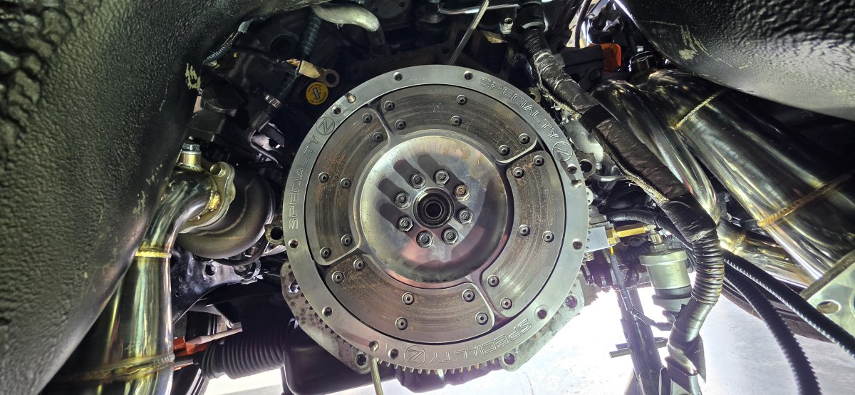

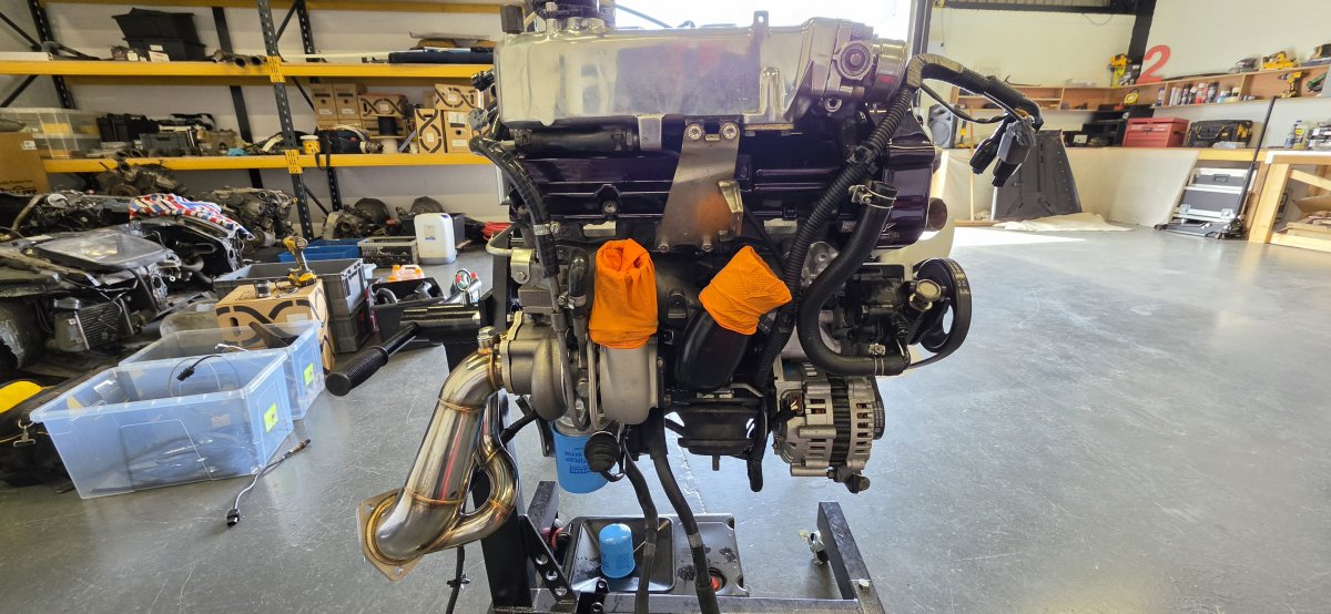

So managed to clock the drivers side turbo and it matches up a lot better and the actuator no longer touches the oil tree.
However it took me two hours to strip everything back off to get to the bolts on just one of the turbos to fix this.
Would you have still needed to grind the oil tree if you had realised the clocking beforehand?
Back in the garage today trying to clock these turbos slightly so i can get the pipes to line up.
Few hours on and off and got them where i need them; however the lower drain pipes arent so great.

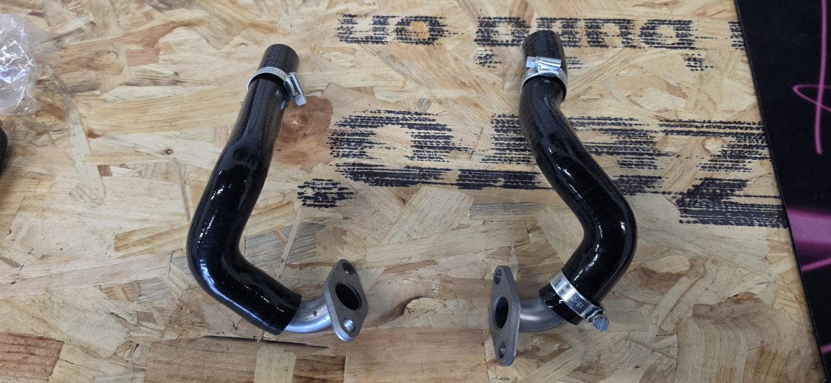

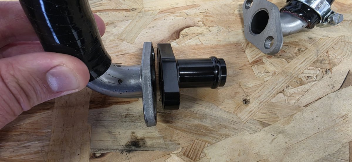

So i have ordered a set of oil drain flanges and some new rubber drain pipes to get back to the sump.
Hopefully this will work over the oem as they arent even close to fitting.
Nearly ready to put the engine back in 😀
Had to order a set of oil pipes from ConceptZ as the stock ones are too tight in terms of lining up with the sump.
So everything is done and just await a delivery next week from Fedex again.

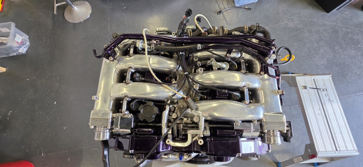

Also fitted all the wiring for the injectors and coil packs, they are all on 3 sub looms each with a break away plug so easier routing it the way i want now.

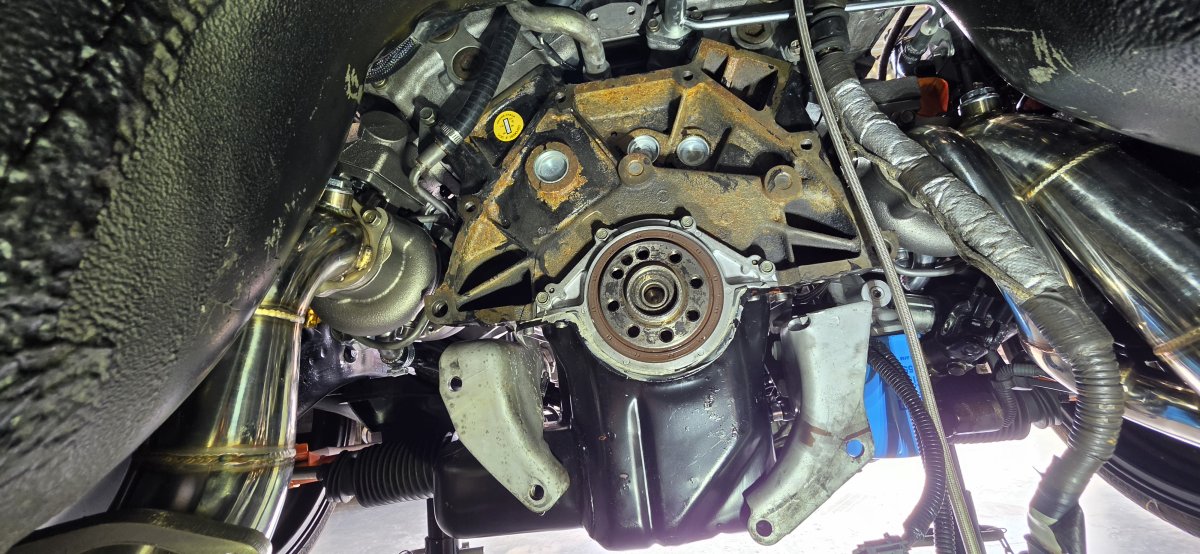

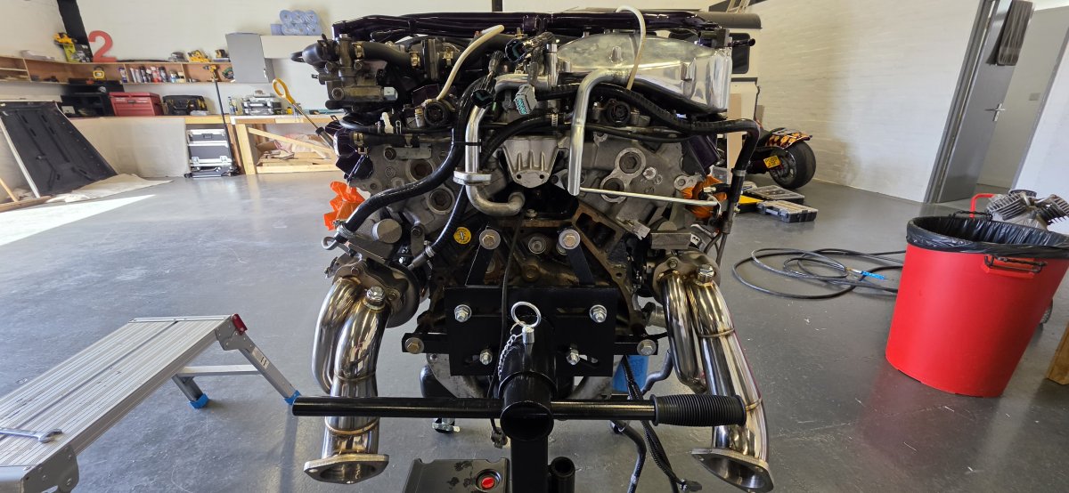

6 hours ago, JaiKai said:

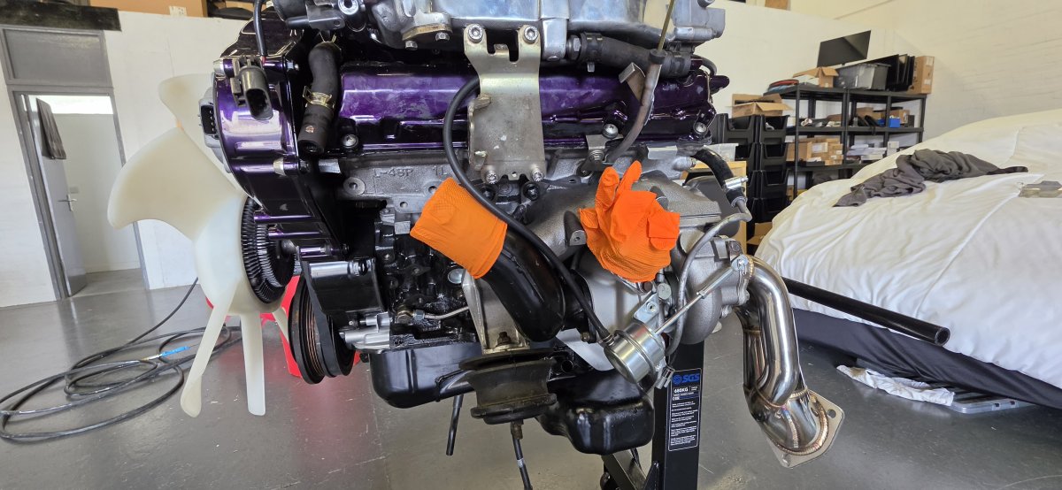

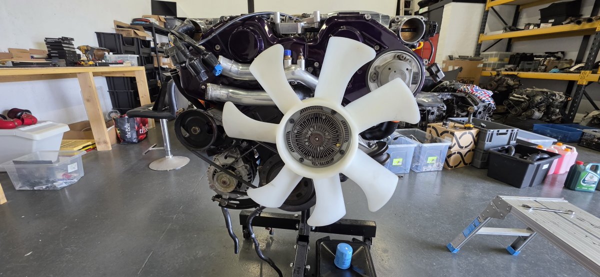

New crane adaptor to lift the engine is mush better than using straps.
However ever so slightly tricky to get hooked up simply because of the wide engine stand i'm using.
Up and away, tempted to put her in now.
Crazy how 4 plenum dolts can hold the engine.

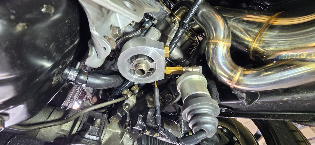

Few more issues but managed to resolve them eventually.
First was to do with the oil pressure sender, as i located this on the oil tree and nearly managed to crack it off
when installing the engine as i never knew it falls foul of the steering column.
So found an old oil sandwich plate and a few adaptors and managed to rig up a new location for it that works well.
