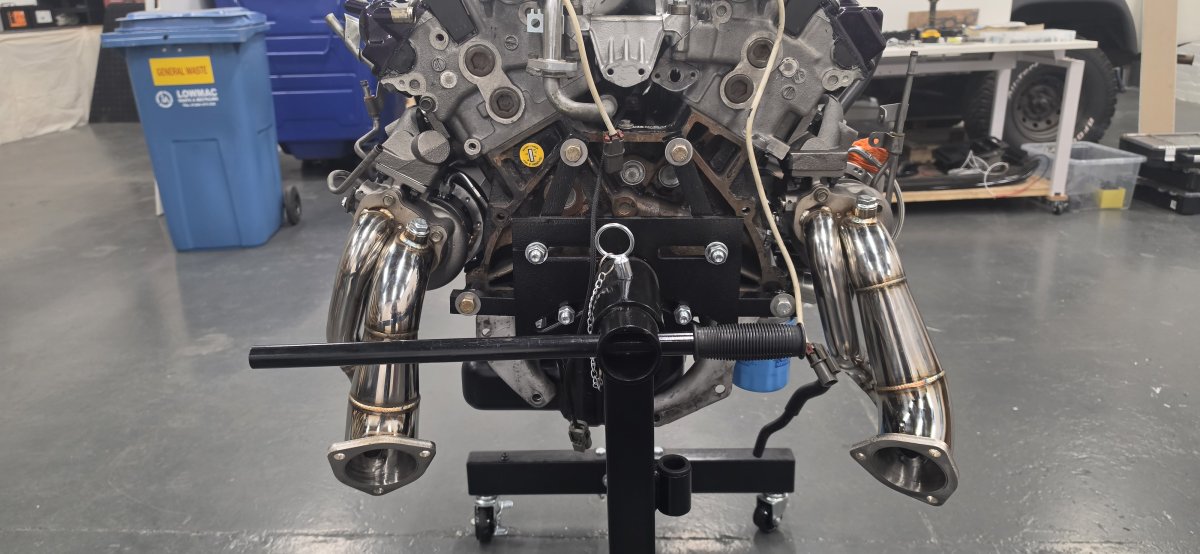

  • And they have arrived !
JWT lifters??? Are you sure about that??
I can’t find any trace of JWT lifters on their website or anywhere on the net

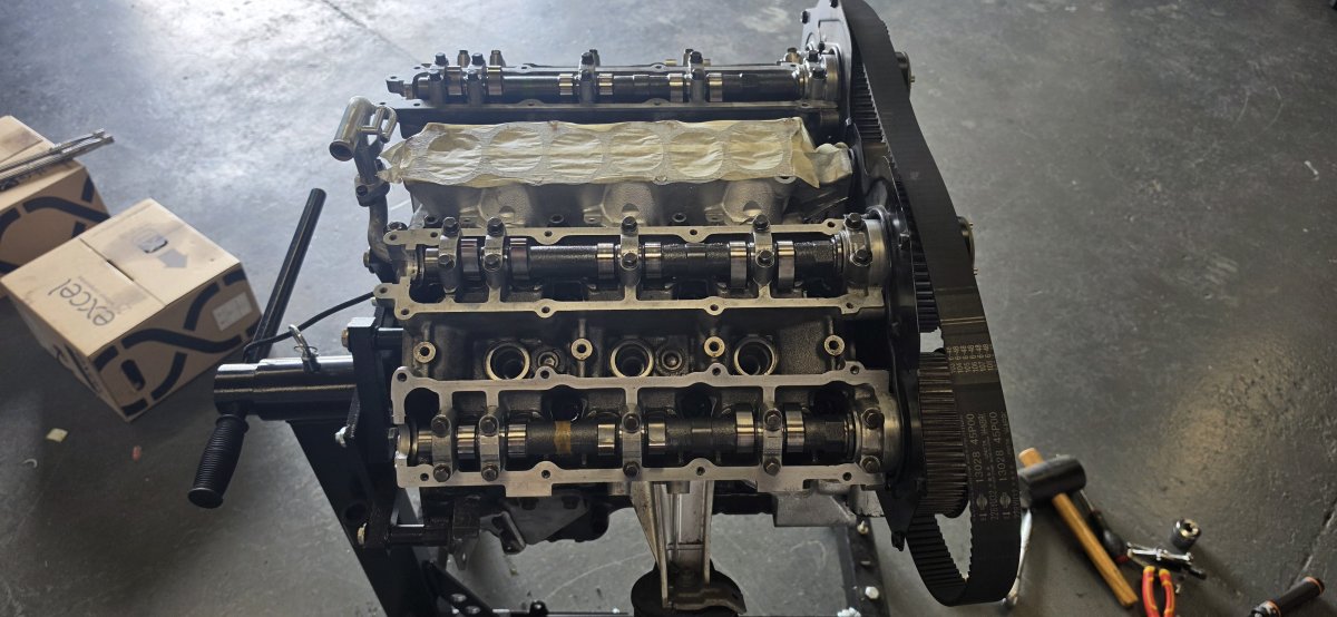

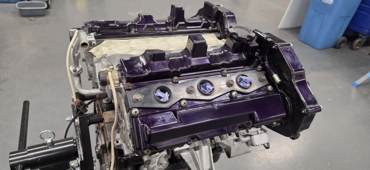

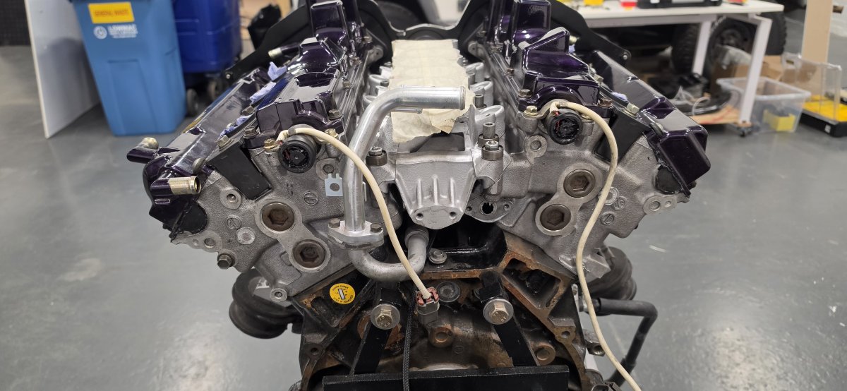

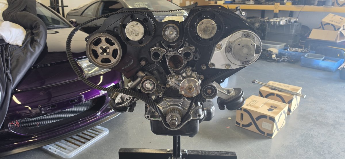

Engine Assembly time.

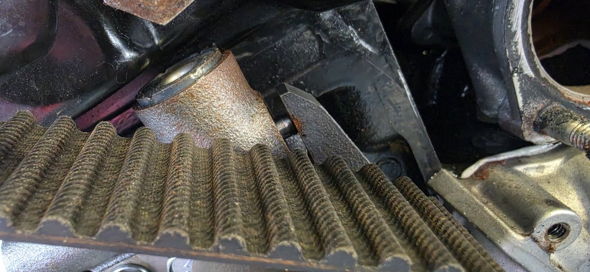

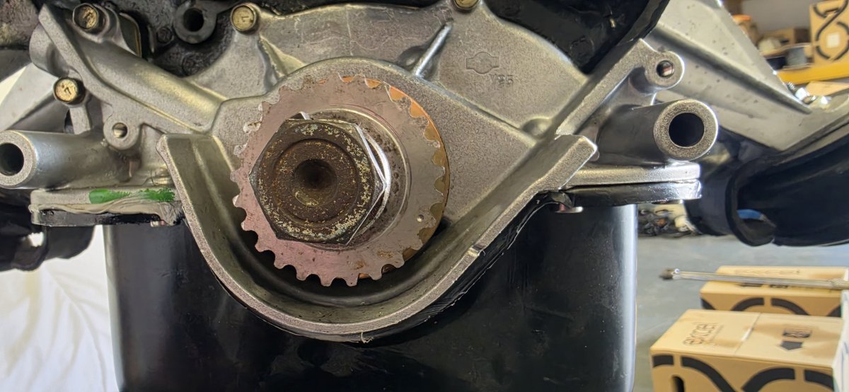

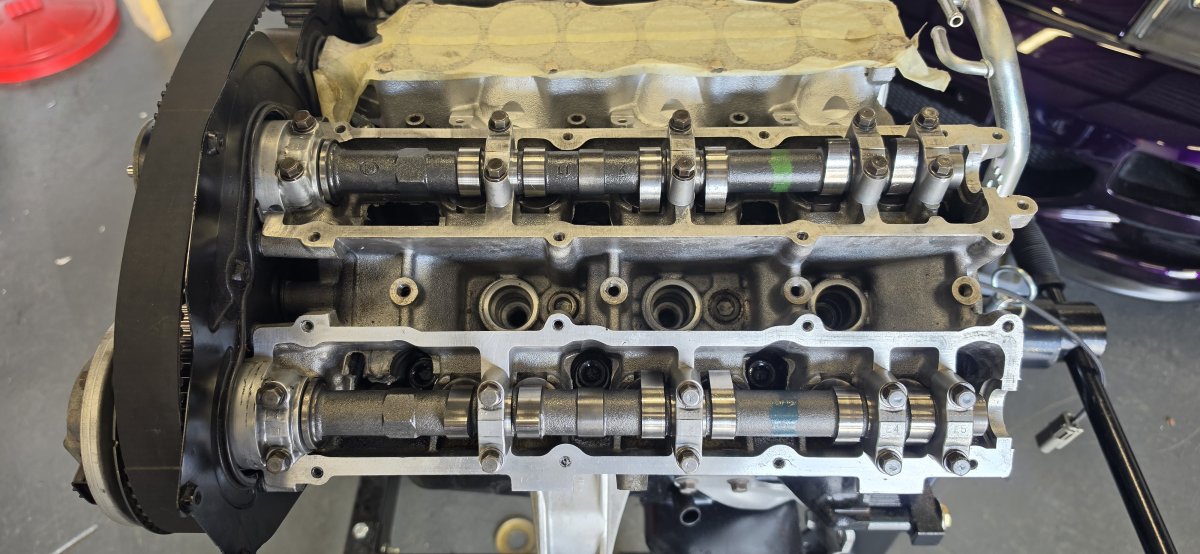

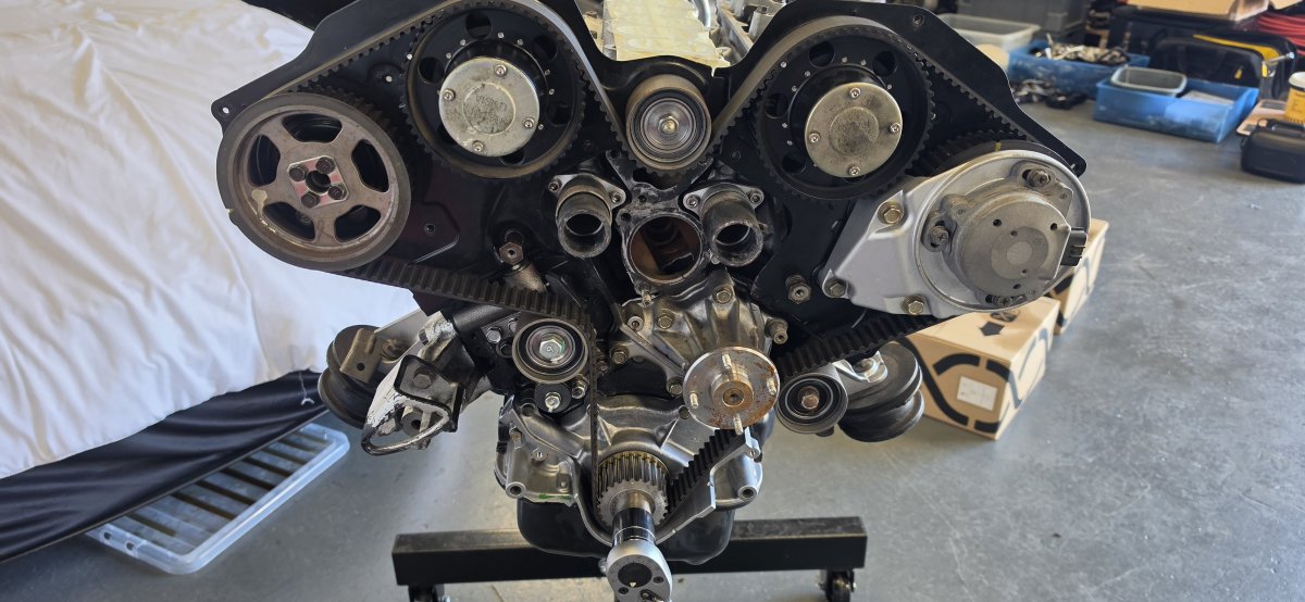

Managed to get the heads back on, all the lifters and cams torqued down again, then fitted the cam gears and went to do the belt.
Not as easy as i remember it a few years ago so had dificulty getting the marks to line up with the crank pulley at the bottom.
I'm guessing the sprocket is slightly out so i'll try again tomorrow, but need to find some clamps to keep the top done.

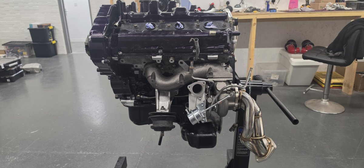

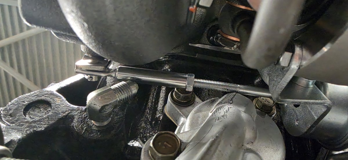

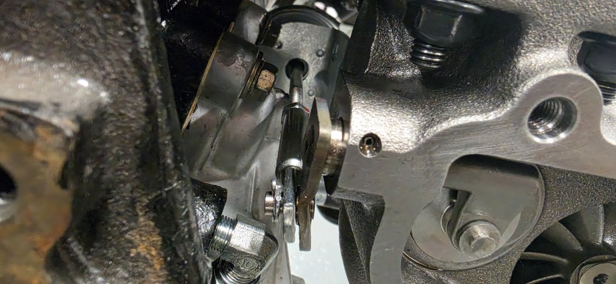

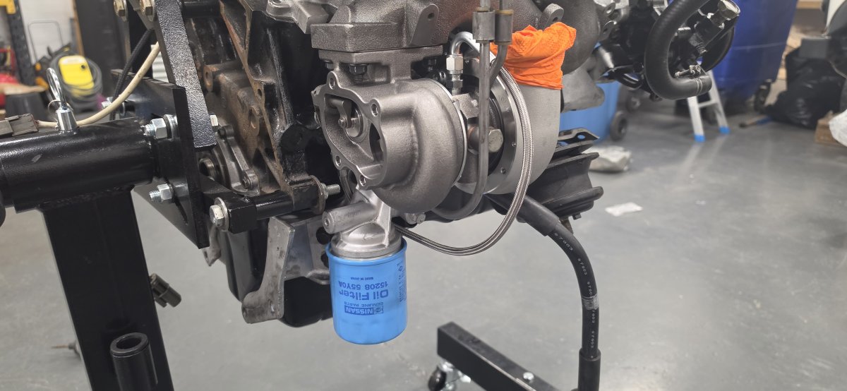

3 hours to install the first turbo ☹️
After figuring out how to install the water and oil feed pipes i discovered (only after spending 30 minutes doing the bolts)
that the actuator falls foul of the oil tree and the oil feed connector block.

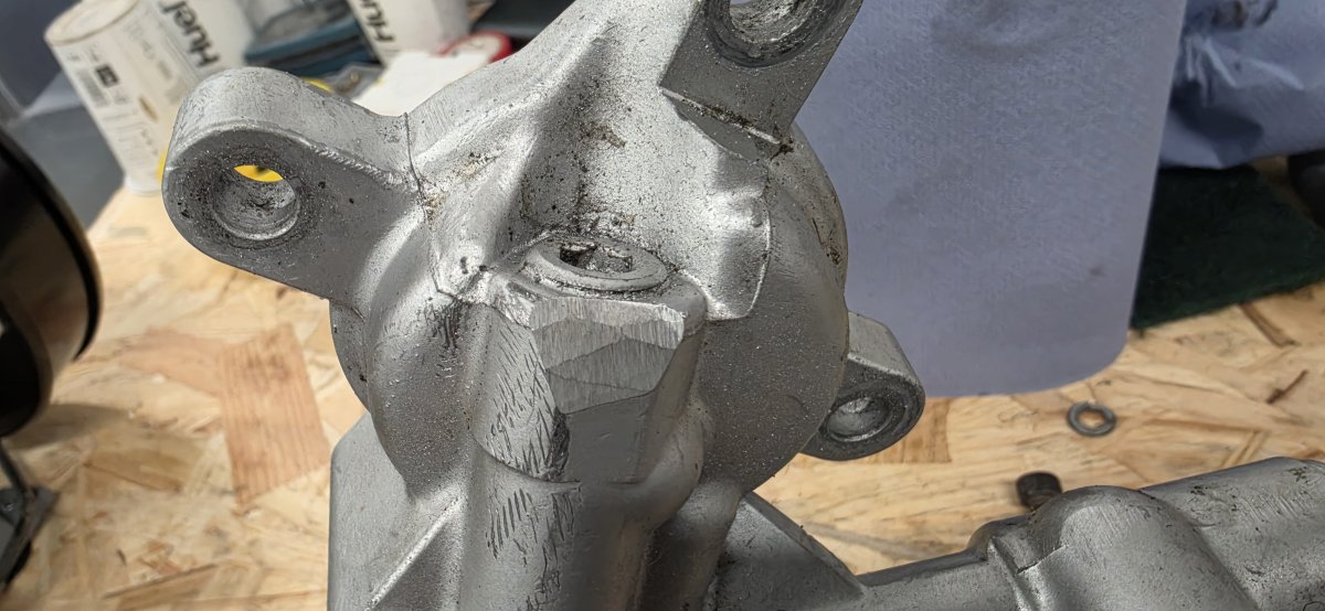

Back off they came and grinded some of the oil tree in hopes it clears it when its on.
Very close
But i think that will do.

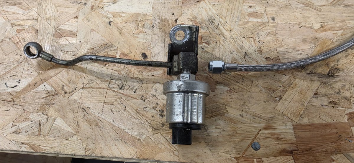

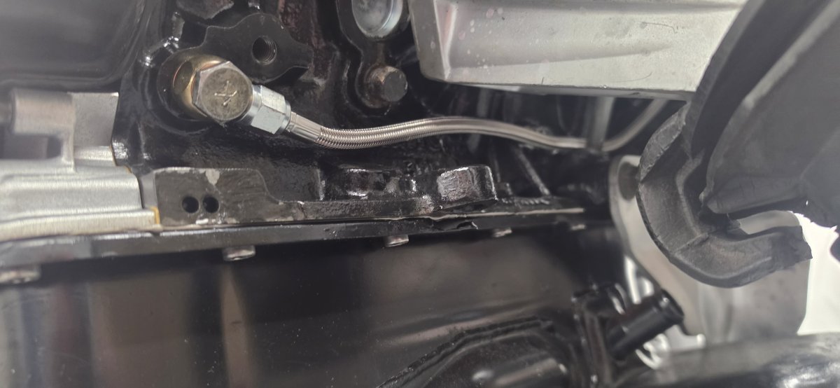

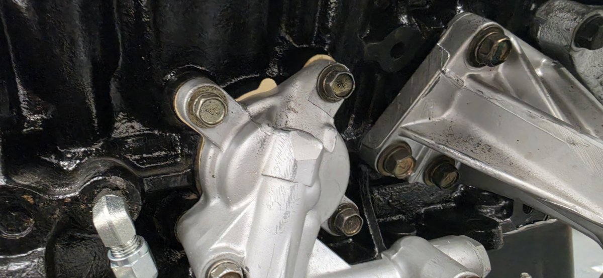

Next issue is for the left bank, as the instructions and pipe work are designed for the USA market
and such do not take into account the stock oil pressure sensor.
I know need to work out how to adapt the pipe from the two different threads.

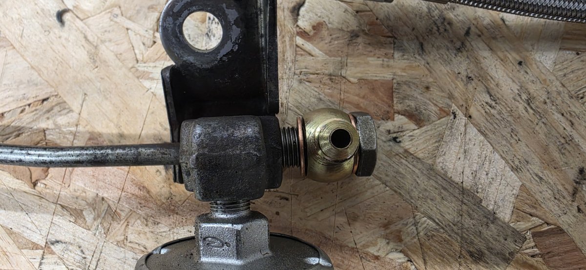

below is part of the stock oil line that feeds the turbos, on the right is the new hose i need to adapt to.
I had an idea to use this connection but the oil feed bolts thread is too long so it will never tighten.

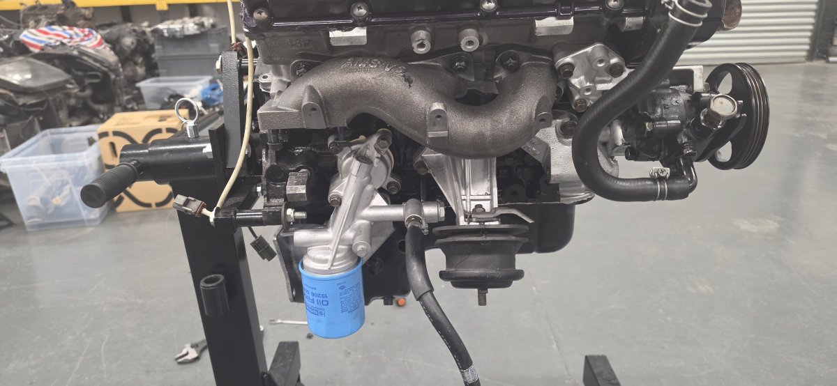

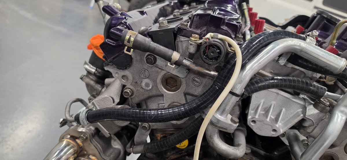

Also start to attach all the auxiliary hoses like the water pipes and vac pipes.
However thinking this would be simple would be wrong; things have been scattered over the years and a few of the pipes are missing.

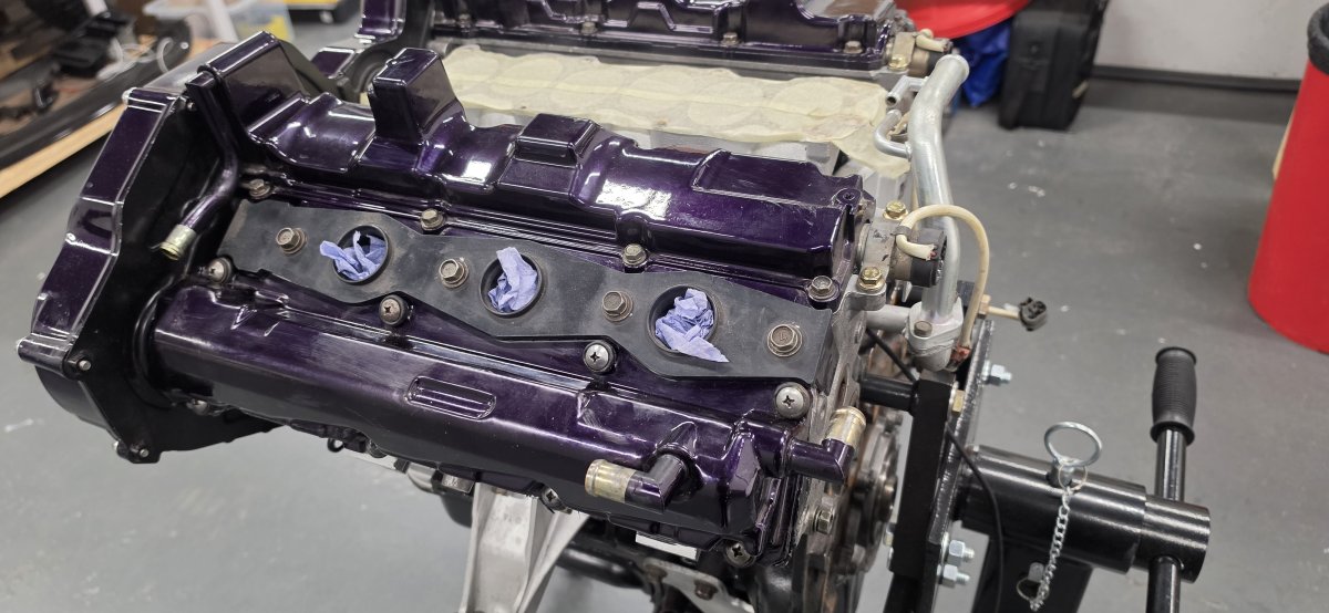

So thought i'll crack on to the plenum so i fitted the fuel rail down nice and snug.
Next issue we have - Spark plugs - no-where to be found !!
So looks like i'm building another list of parts thats needed.

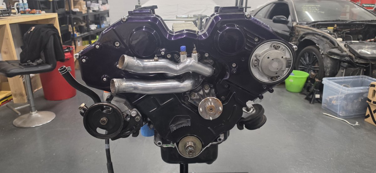

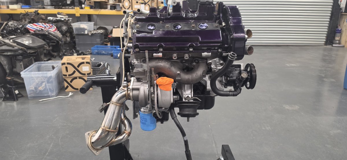

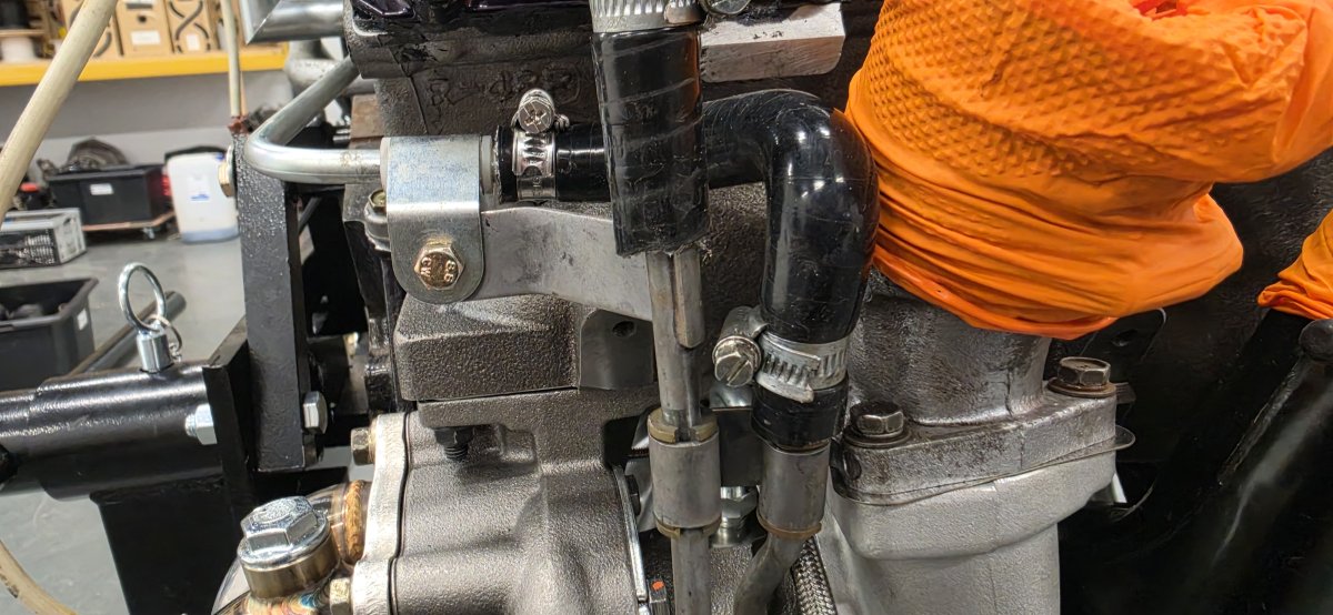

Getting very close to putting this engine in the zed now and its getting very exciting again.
Had to order up a few new hoses which arrived yesterday as well as a set of spark plugs which was installed today.
And had an issue last time with the water pipe kinking which i didnt trust so i ordered a 90 degree elbow which when fitted doesnt crush.
