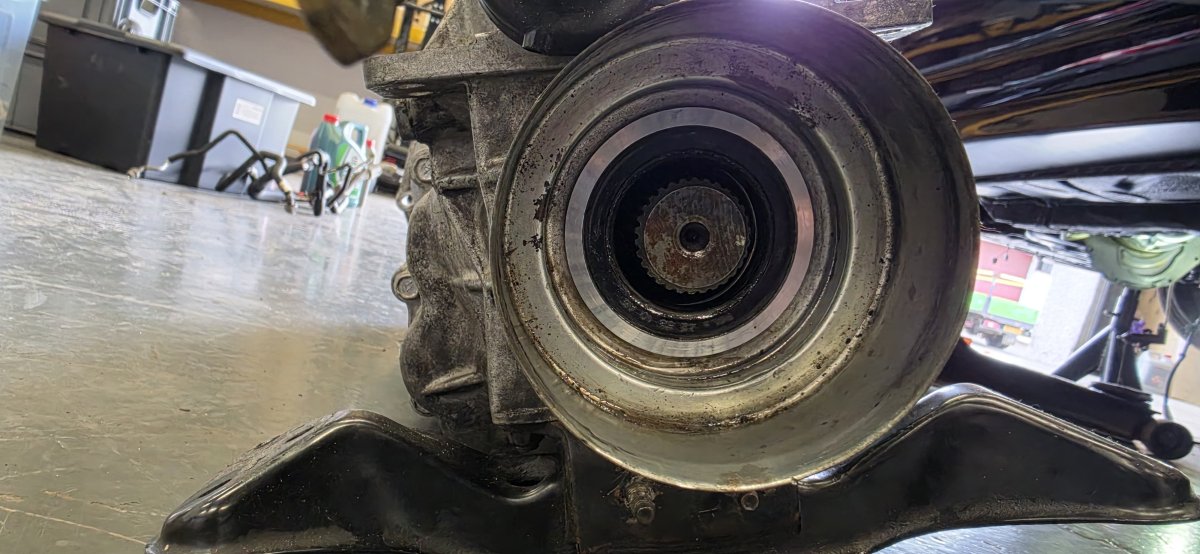

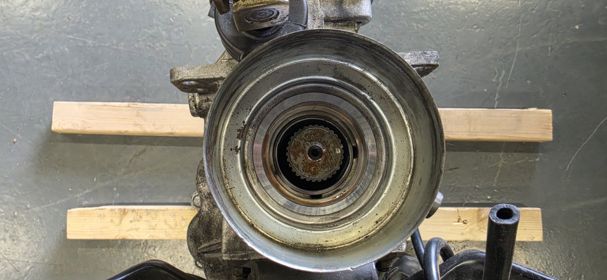

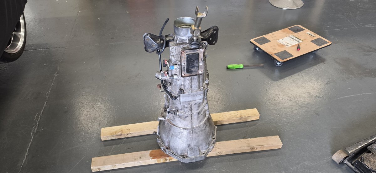

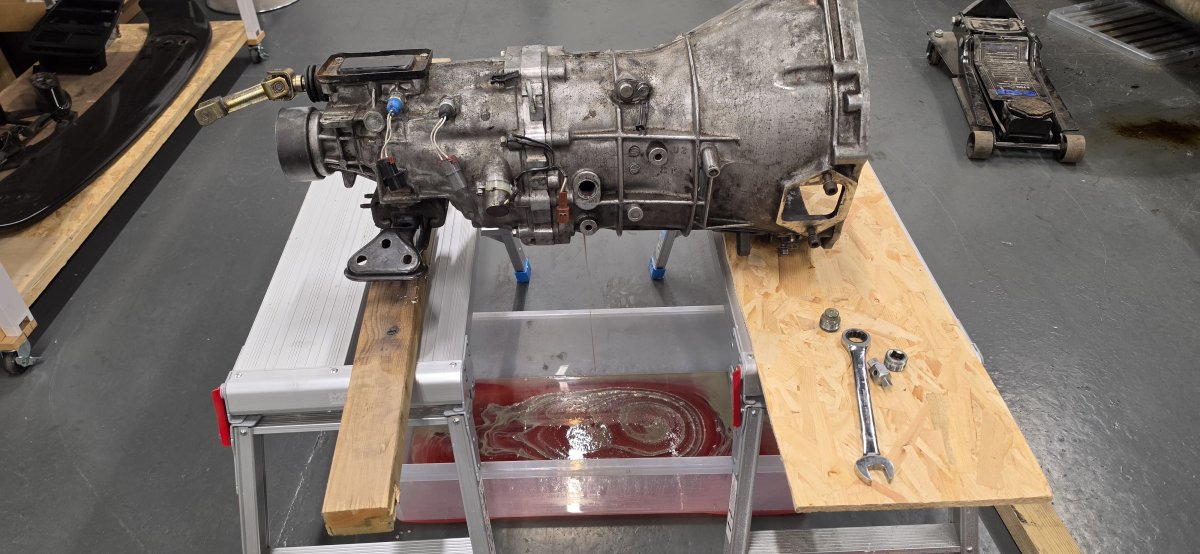

Onto the clutch and this was fun fitting and trying to torque up without it rotating.
Eventually put a large socket in the front pulley and let it push against the bulk head.
The spigot bearing

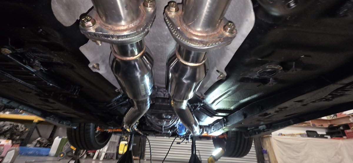

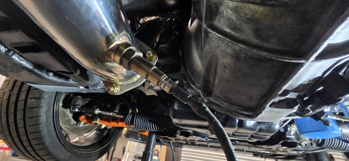

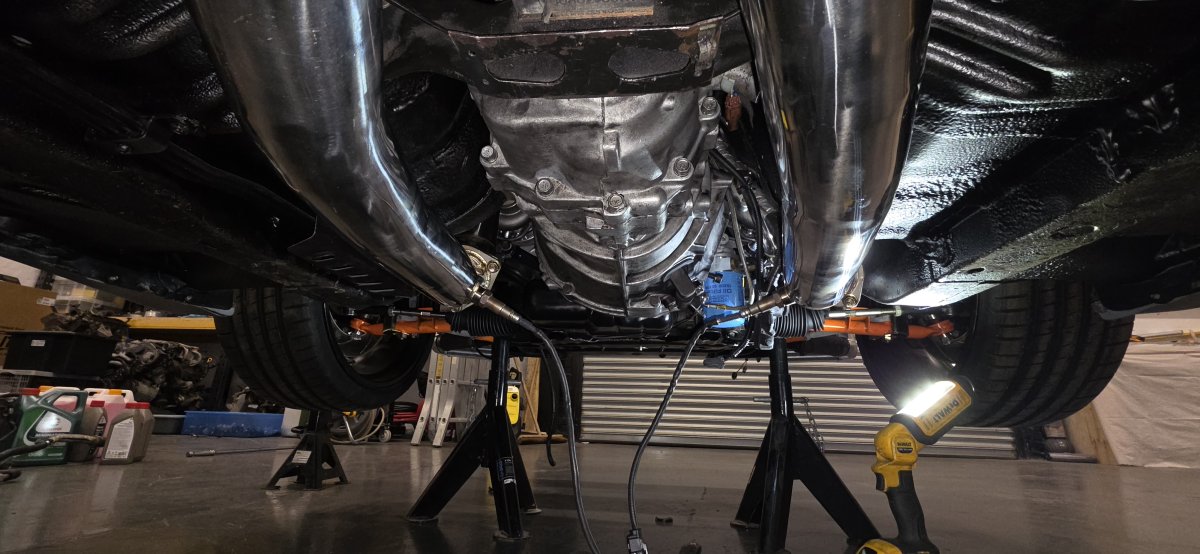

And that nearly everything underneath now done.
Next job before i take it off the ramps again is to make a harness for the wideband sensors.
Just as well you have a kit 😉

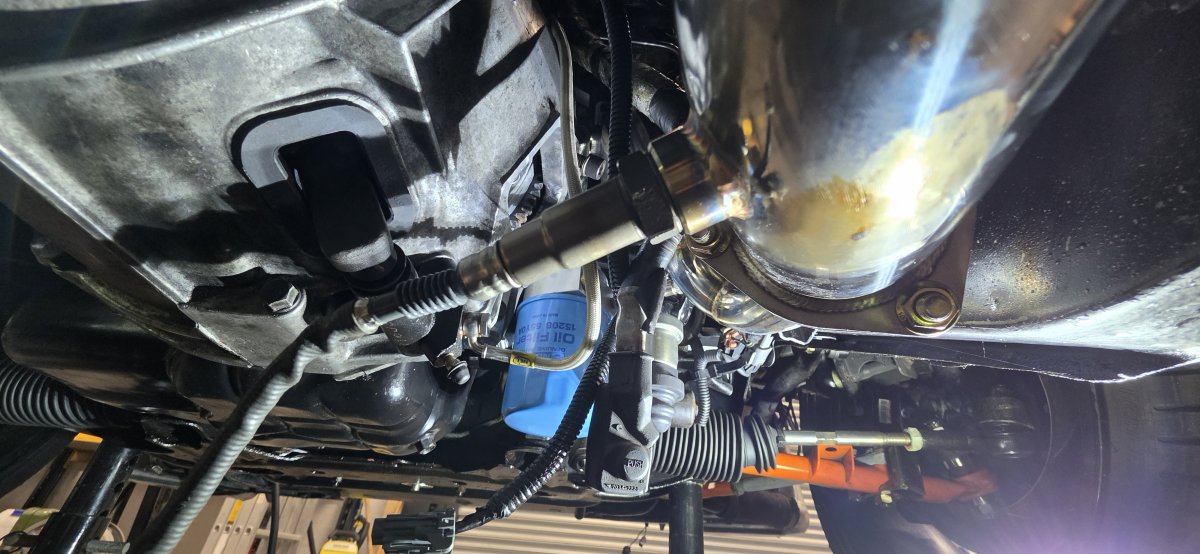

Right,
Was planning on doing a first start and i've disconnected the injectors so i can build pressure in the oil.
Unfortunately no pressure on the gauge.

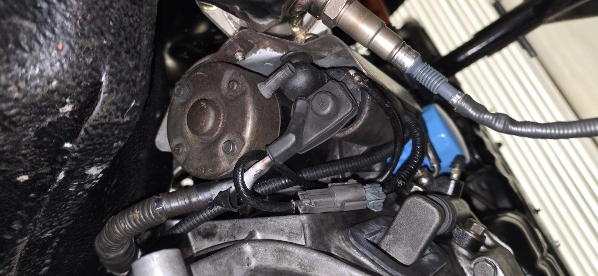

But i think it could be because my zed is a series 4 and the hook-up for oil pressure sender is the wrong one.
As i have two sender harnesses , one on the passenger side which used to goto the left of the block and the other is part of the Wiring Specialities loom which is the one thats hooked up.

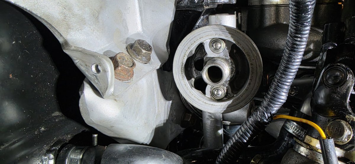

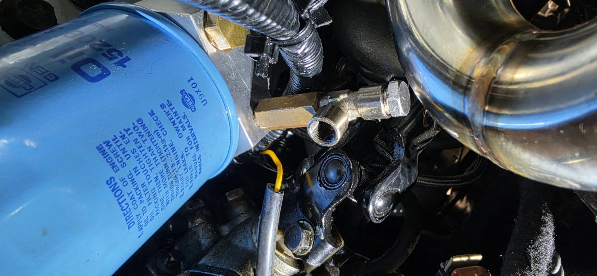

So think i have discovered my oil pressure issue .
Thinking it may be a Sender issue, i unscrewed the sender expecting a face full of oil and nothing.
Slightly pannicking i undone the sump plug to get a full handle full which is great.
The issue i think is an air trap on the T section of the adaptor i used on the sandwich plate show below.
Going to remove the adaptor and see if oil flows from it, if it doesnt i'll need to take the sandwich plate back off and see whats the issue is.
If there is no oil at the sandwich plate then we have other issues.
