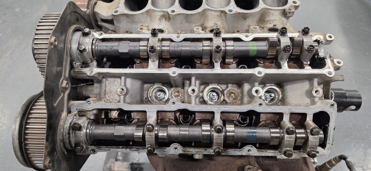

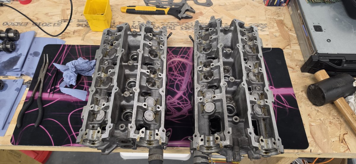

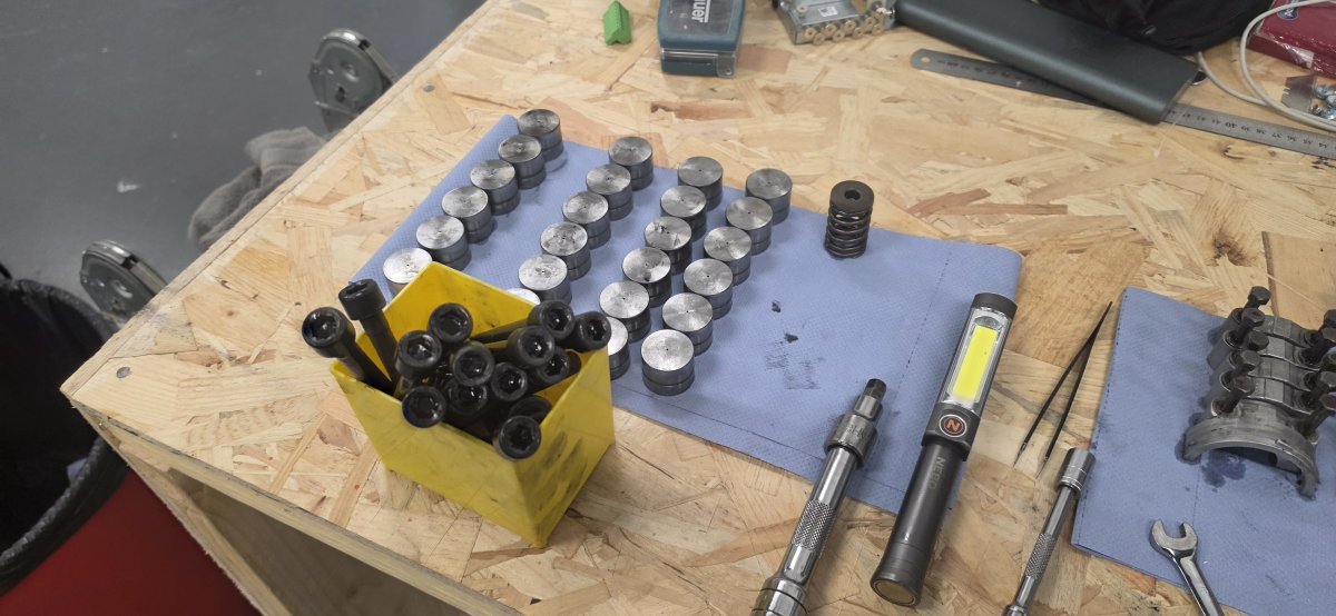

Working on the new build heads today,
I removed the old springs and lifters then fitted the JWT springs and lifters then I planned to put the new cams in too but discovered all the lifters are spongy.
After dipping them in oil and compressing the pistons on them a few times all the air quickly came out,
However many of them, likely 10 are still spongy so not sure what to do at this point.
I purchased the last set of turbo lifters from, conceptua_performance_tuning.
When I rebuilt mine a while ago few still tapped and OEM were NLA. New cams you need solid lifters and I did not want to spend that much.
