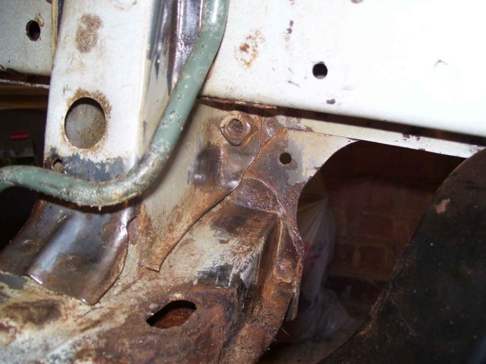

Well, as many may know, I have recently discovered that my lower radiator cross member has finally succumbed to the dreaded tin worm.
Hopefully, this is day one of my journey to successfully repairing it with a suitable replacement.
Wish me luck, I think I will need it.
So, today I started the dismantling of the front end, and within a couple of hours I had removed the front bumper etc'
This was done on the driveway, and I hope to complete the rest of the work in the garage, hopefully.
I have reached the point where I am unfamiliar with most of the critical items that now stand in my way, and would seriously appreciate some advice as to how I should proceed.
First question/concern that springs to mind is... Can I continue successfully with the car being in the garage?
The last thing I want to do is get half way through the strip down only to find that I do not have the correct access.
The car is drivable at the moment, but once I start taking various parts off she will become immobile.
Your help and advise would be very much appreciated.
Please see photo's attached...

the (new) standard unit needs to be bolted into place using fixed points in the chassis and is then welded, so fitment/alignment is pretty much foolproof for the standard unit .
you can see these points in the pictures that redwine posted

> Thanks Lymon, I hadn't thought of using those bolt holes for initial fixing if I was honest.
bolt the support into place using those 3 bolts on either side, then bolt up the tens.rods + brackets and the upstanding bar to the upper radiator support.
Then weld the support to the frame and it'll positioned/aligned the way it should be.

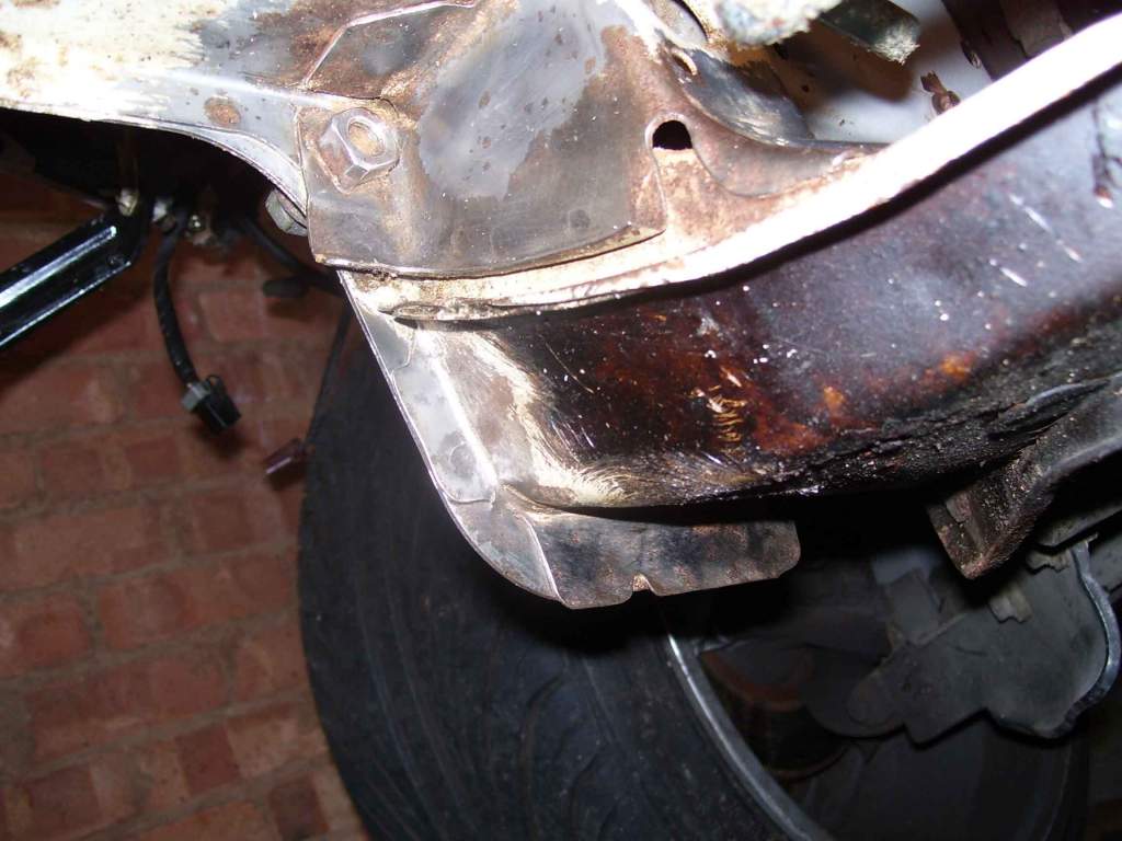

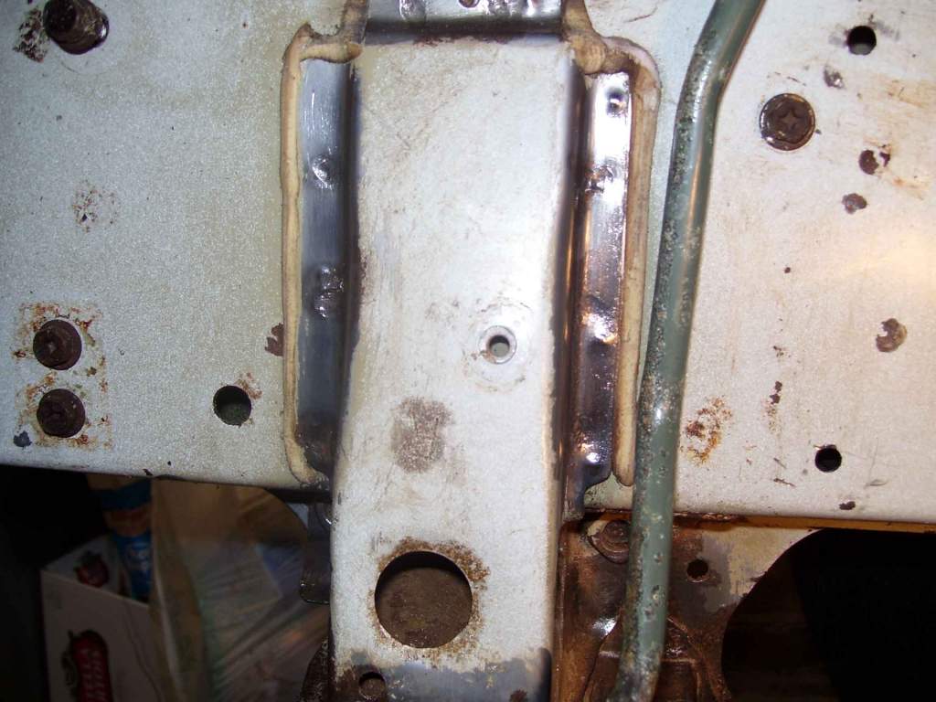

Well, after another grueling few hours stripping back paint etc' I think I have exposed most, if not all of the spot welds on one side.
All I have to do is repeat on the opposite side! Oh what joy.
God knows how I am going to present a drill bit too the little blighters, I guess I will be getting the Dremel out.
Best pull my finger out mind, as my new replacement crossmember should be here in about a week.

Don't stuggle getting at the welds mate!-cut most of the old member off, I would personally only be leaving the flanges that are spot-welded, the rest, cutting wheel.........
As you say, far easier to cut pieces away as opposed to break my neck trying to access some of the more difficult welds.
I will have to figure out however, if I can actually get in to mig weld also.
May have to consider coming at it from both sides as there appears to be a couple spot welds hidden within.
I'll know more as I start removing it.
I'd imagine it would have been wet installed with sealant so the faying surfaces will also be stubborn to remove once all the spot welds are off.
I fear you may be correct, It'll be a matter of teasing the faces apart step by step.
Hopefully without distorting the mating faces.
Edited by redwine300

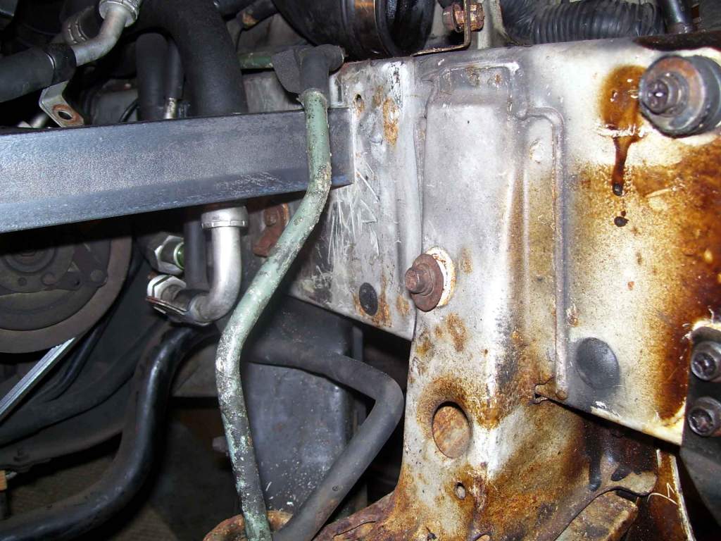

Thought I would roughly position my support brace today.
I havn't done any weld preps to the angle iron etc' yet, just want a second set/sets of eyes to see if I have missed anything.
Once its in, I would prefer not to have to re position again.
Thoughts please.
Looking at it myself, I think, what I believe to be the power steering line, will be an annoyance.
Is it much of a pain to re fill and bleed the system if I decide to remove the piping?
After all, I have come this far I suppose.
I've drained mine more than once with no ill effect. You simply refill and rock the the wheel lock to lock till the bubbles stop. The hicas is more of a nuisance, but I doubt it will cause you grief. Crack on mate, small fish that one.
So, will I only need to bleed the front part of the system? not the HICAS?
Having the front in the air helps I guess.
