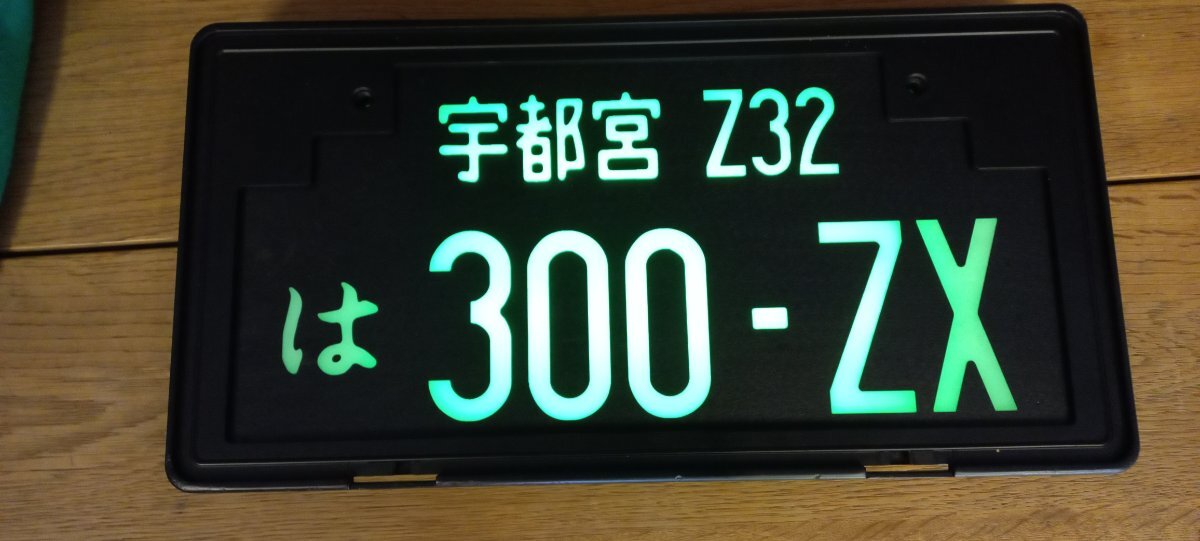

Changed the rear reg plate harness as the bulb holder was crumbling away so only 1 light was working20230730_111641.jpg.51b8ea676647e7c79fbb799e60e54642.jpg
Also fitted a new rear number plate backplate which apparently is pretty rare with "nissan" writing from japan.
Also got some 4d plates while i was at it to add a little pop, imo looks loads cleaner

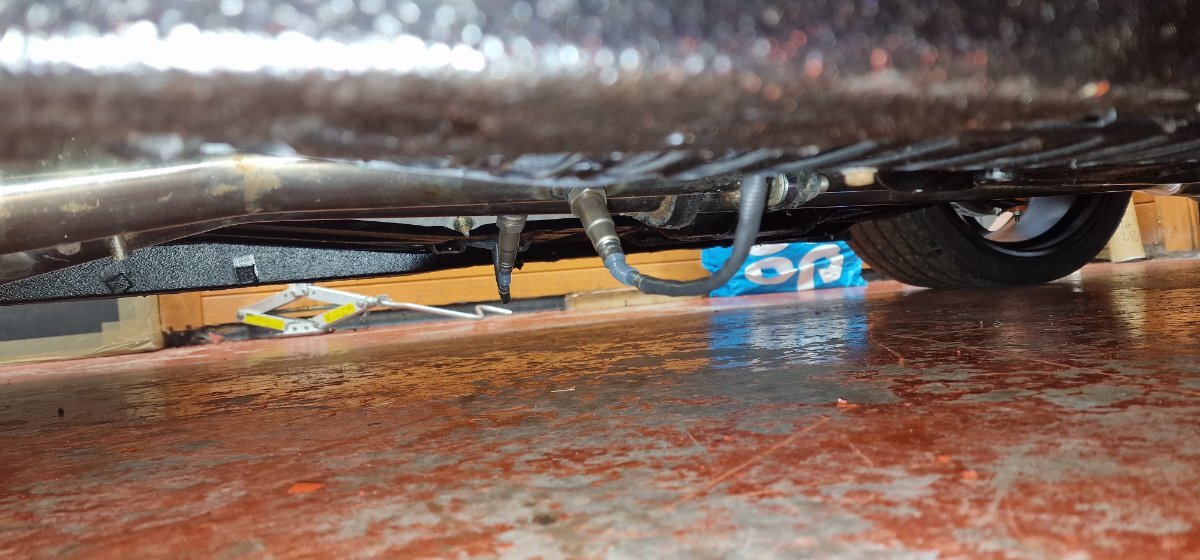

Update on this, taken exhaust pipes back off and dropped them at a local welder to put some new ports on.
Moved position closer to drive shaft and pointing up.
