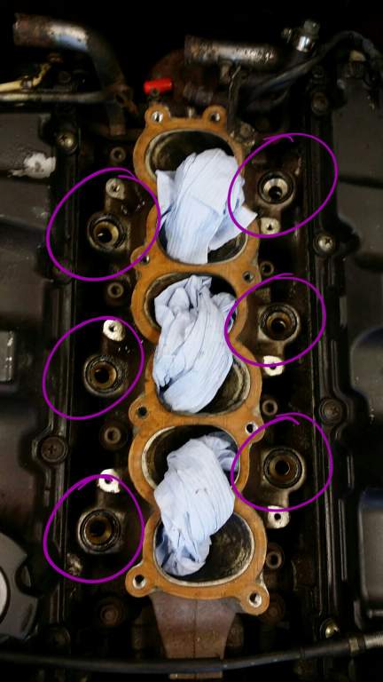

Would a new style fuel rail do the same thing, without having to pull the upper manifold?
Still go to pull the plenum to change the rail sadly.
and machine the lower intake manifold to accept the later type fuel (pintless injectors) rail.

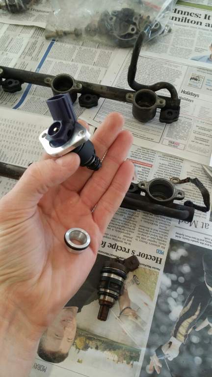

Isn't there some aftermarket rails that are bolt on fitment?

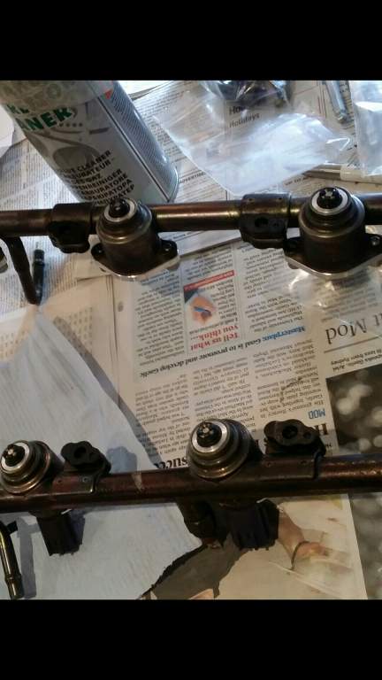

Yeah stock size late type mate.
Ive got a set to go in myself, with a fuel pressure increase they should give enough fuel for the end plan.

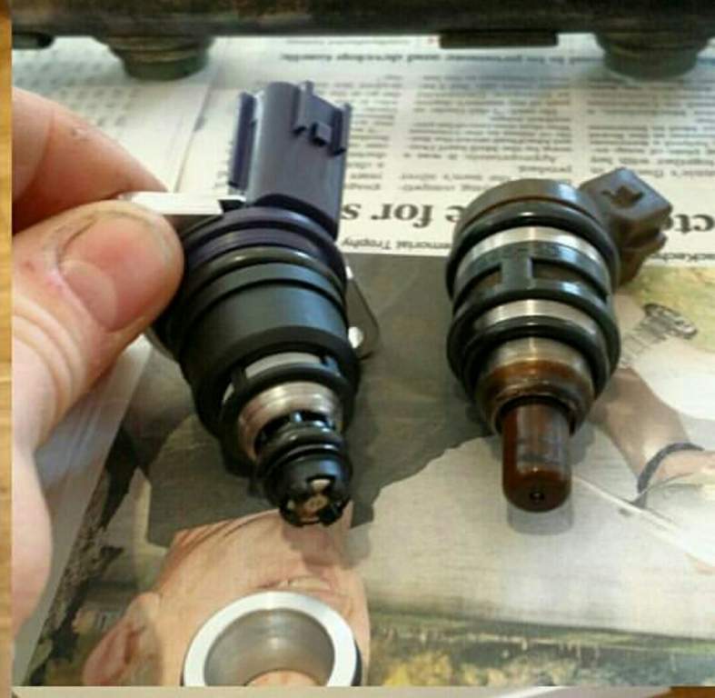

What's the difference to earlier ones then? When did they change?
Late 94/95 I think. They changed them from old style wet coil pintle injectors to pintleless.
Early ones are crap and the coils are always charged even when the ignition is off. Not quite sure who's wondrous idea it was at Nissan to give them.a constant 12v feed, but they want their heads examined. There is a mod to swap them to a switched feed.
Early style injectors break down over time......and it is only a matter of time as they will all go wrong.

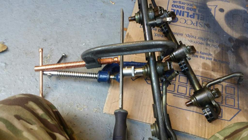

Yes those. I only mention it because I sat at my computer (in 2014 this was) and planned my plenum pull bits and bobs. I bought a load of bits from czp and didn't realise till I was in there I needed those. It wasn't advised when I bought the injectors and I think they are probably due when your injectors are. Mine were fine but rock hard.
Haha, the fun I had :biggrin:
I nearly forgot about that! The "injector remover 5000" How I did injector 6 in situe I have no idea!
