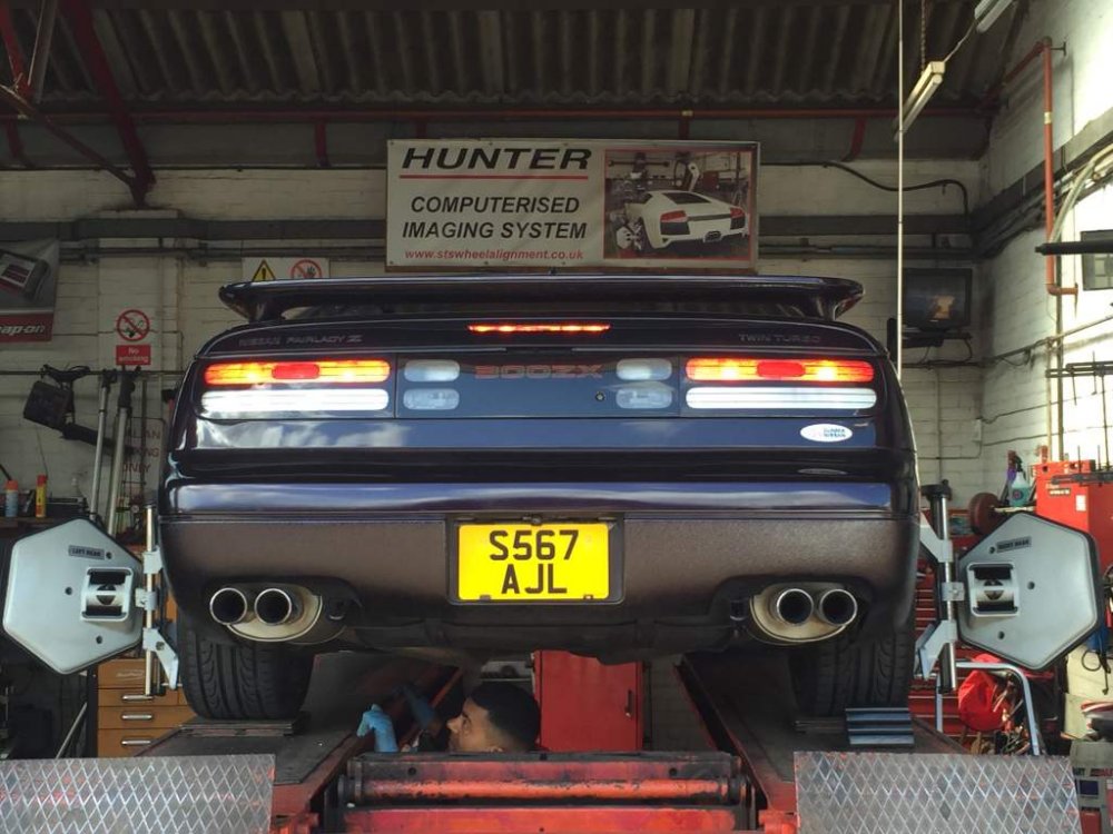

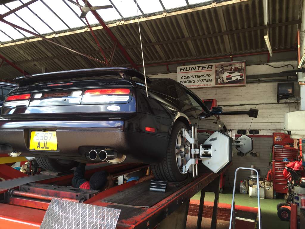

  16. Yep, you were right Ian, the camber bolt is adjusted totally and could not get it spot on, chap adjusted the toe to compensate for now. Should have listened to you mate, anyhow here's a couple of photos of her on the ramp. :oops:

  18. Cheers Pete, just picked up 4 tyres and set a date for Wednesday at http://www.wheels-inmotion.co.uk/about-blackboots.php for the 4 wheel alignment. My Zed seems to be quite well looked after before it was imported, and after speaking with Lee at LA Autos who has done a fair bit of aesthetic work on her recently, we are certain the adjusters will be fine, good point though. I confirmed with the company that there will be no hidden charges for repeat adjustment as some companies do and the team there seemed quite excited about me bringing in a 300zx, so fingers crossed all be well. Will let y'all know how it went....

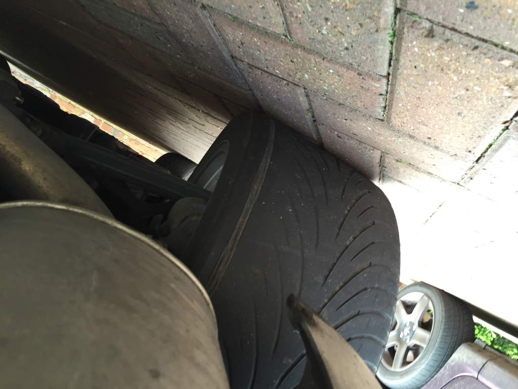

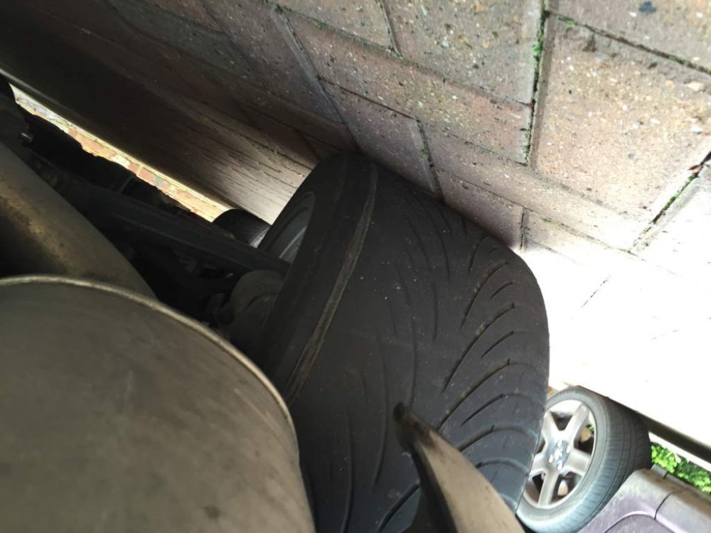

  20. Hmmm, been looking into this, perhaps a specialist set up center is the way to go. Just for clarity, can anyone confirm the below is indeed the factory specs please? Here's the specs from the Nissan Service Manual: Unladen but with full fuel, radiator coolant, engine oil. Spare tyre, jack, hand tools and mats in position. Front Axle and Front Suspension: Camber -1.35' to -0.05' degrees Caster 9.00' - 10.30' degrees Toe-in 0 - 2 (0 - 0.08) mm (inch) Total Toe-in angle 0' - 11' degrees Kingpin Inclination 12.10' - 13.40' Front Wheel Turning Angle Inside/Outside 32 - 36 / 27 - 31 degrees Rear Axle and Rear Suspension: Camber -1.35' to -0.35' degrees Toe-in 0 - 4 (0 - 0.16) mm (inch) Total Toe-in angle 0' - 22' degrees
