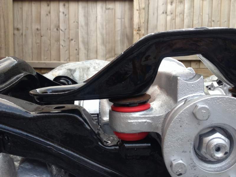

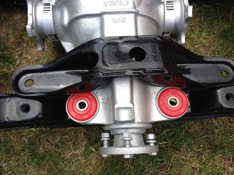

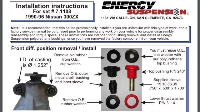

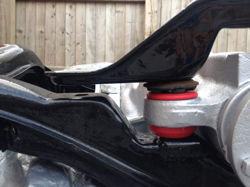

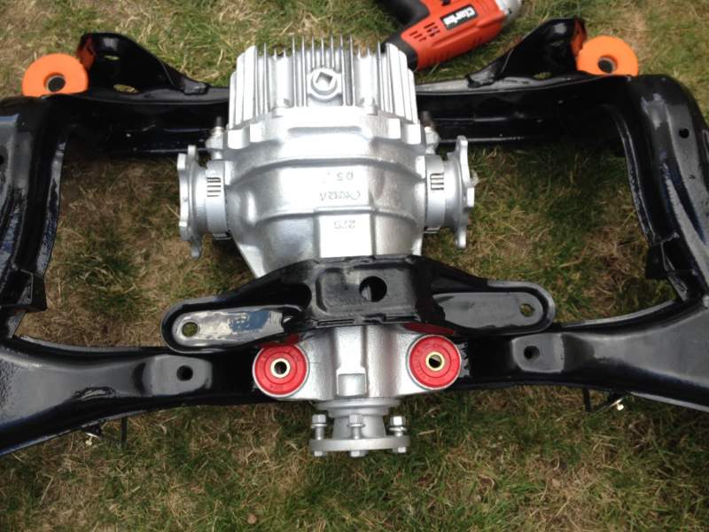

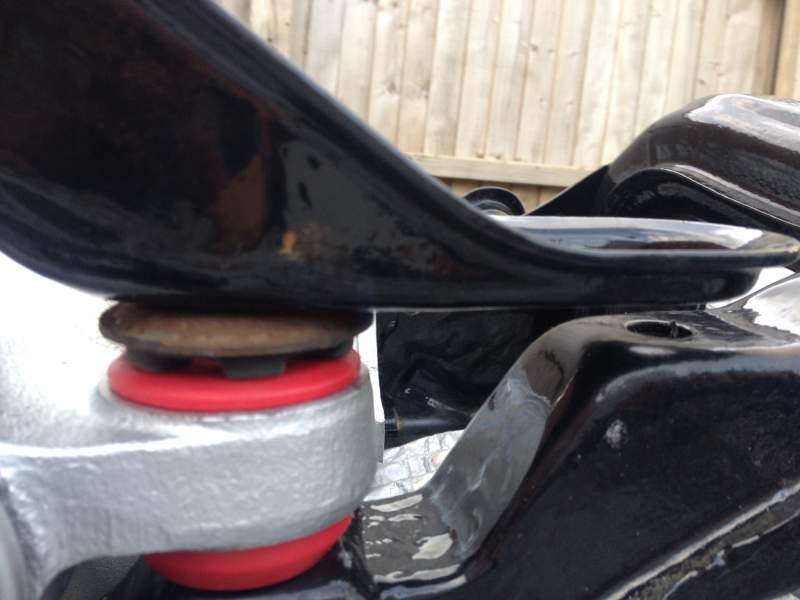

  9. Looks like you do need to use that washer with no rubber
  10. Thanks anychance of a link please I can't find it .

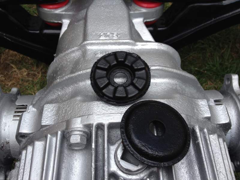

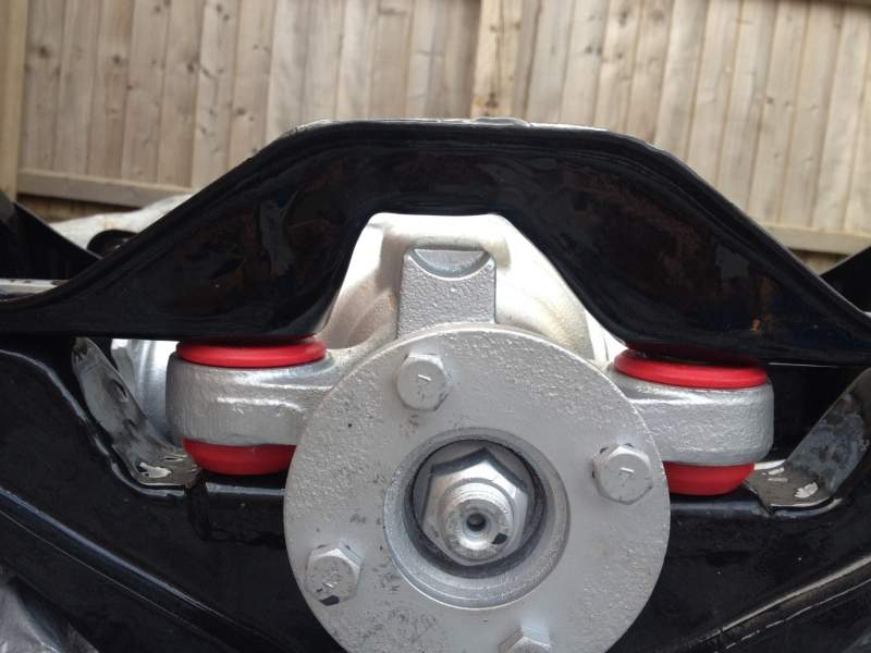

  11. I'm beginning to think these rubber washer things don't get used with these bushes support sits too high.
  12. Thanks can you post some pics I'm totally confused .

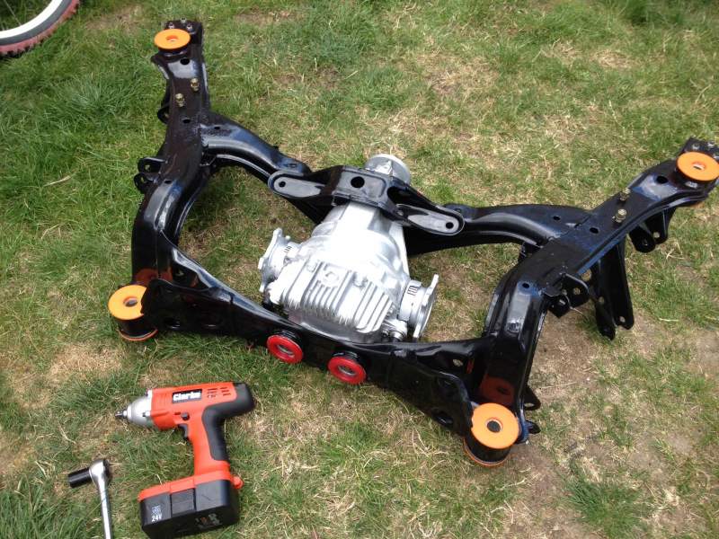

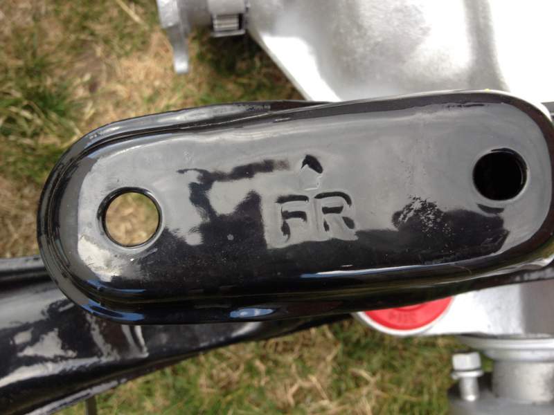

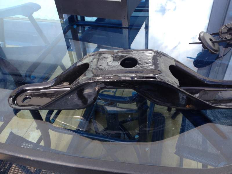

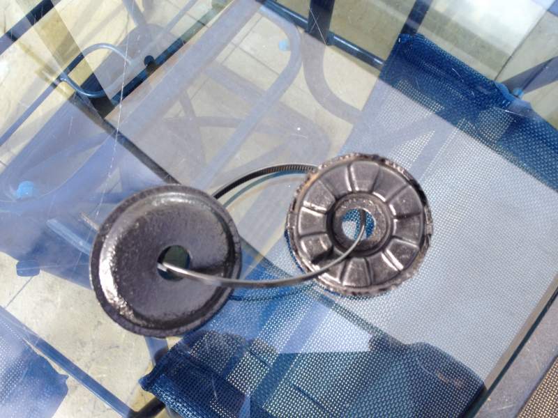

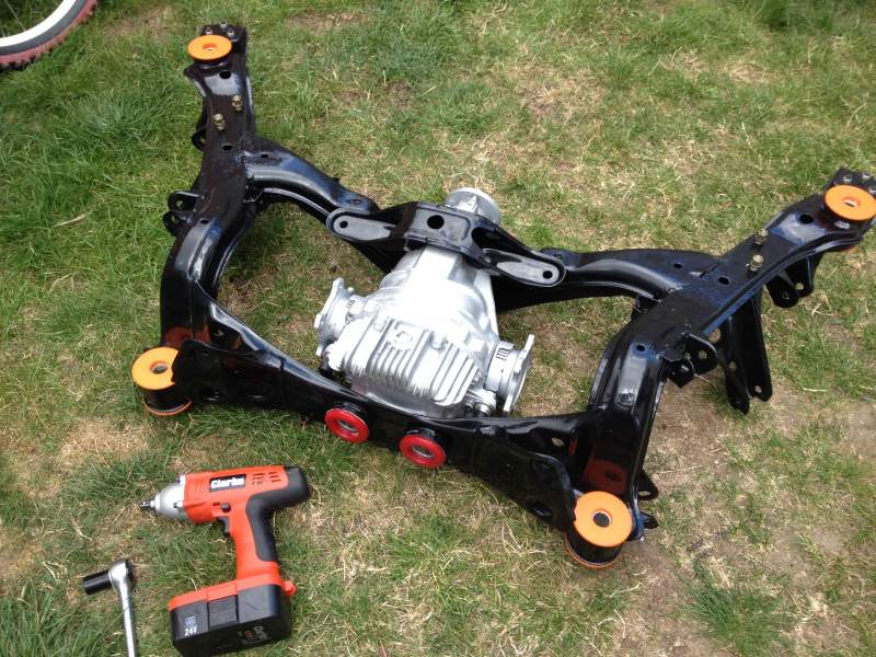

  13. Hi guys I'm having trouble fitting the diff support which bolts to the subframe it's a na diff and subframe is going in a slicktop . The holes don't line up it has energy suspension bushes in both the diff and rear diff mounts . Also cant work out where these rubber cup type washers go . I took it apart ages ago and forgot where everything goes the diff support has FR and a arrow on it I'm confused with this too any help please . Thanks Taff .

  15. Ok thanks I thought I'd have to knock some sort of puller up .

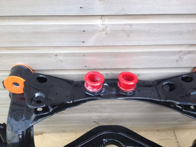

  16. Hi guys is there a easy way to get these energy suspension diff bushes into the subframe do I need a puller thanks .
  17. Hi guys is there a easy way to get these energy suspension diff bushes into the subframe do I need a puller thanks . [ATTACH=CONFIG]89246[/ATTACH]
  18. Hi guys im putting my na subframe back on my slicktop have 2 problems first is I can't remember where these washers go they have rubber on the back Also the diff hanger I can't find the 2 bolts that bolt the carrier to subframe are they diffrent lengths can't find a diagram on the web Any help please
