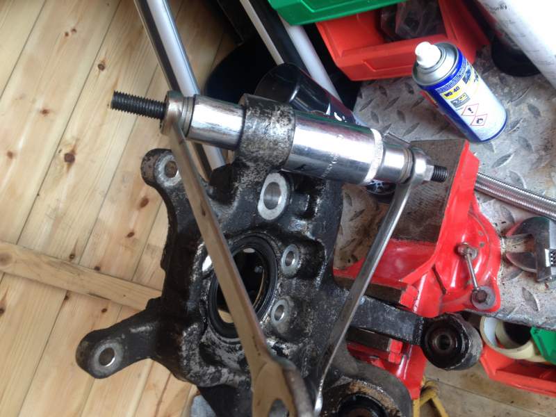

  13. Hi guys I've removed all the bushes from the alloy rear knuckes I've also split the hub part off the knuckle . Are these alloy knuckles factory painted black or are they bare alloy . I've tried cleaning them with wire brush and gunk but not come up that good . Just wondered if anyone had cleaned these up and what did they use thanks .

  15. Also worn of warning don't throw away the factory bush cups from the nissan bushes as the energy suspension poly ones say reuse these cups .

  18. No sleeves all comes out and you left with a bare alloy hole where the bush was .ive done mine with a 2 sockets and strong course threaded bar and a air gun .
