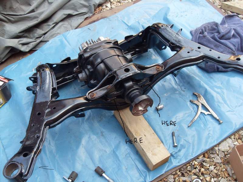

i did mine and it was a **** to get it to line up was fighting with it for ages, am juist looking throw my pics to see were them big washers go am sure is the front of the diff were the input is
Thanks can you post some pics I'm totally confused .
am sure thay go here if i remember and you cut the rubber bit of teh washer am sure that was it SDC12369.jpg

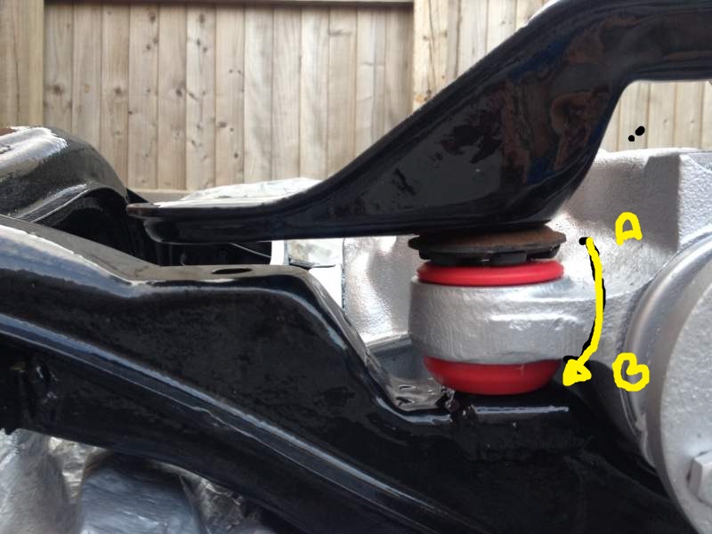

I'm beginning to think these rubber washer things don't get used with these bushes support sits too high.
you have to remover the rubber bit of the washer first so you end up with just the washer !
and you have them in the wrong place look at the pics i put up of mine
cut or burn the rubber of the washer and move POINT A TO POINT B, with the cup side pushing on the red rubber bush image.jpg

Looks like you do need to use that washer with no rubber

Yes I know just didn't seem right thanks got your help .
i was think that when i did mine but its rite
