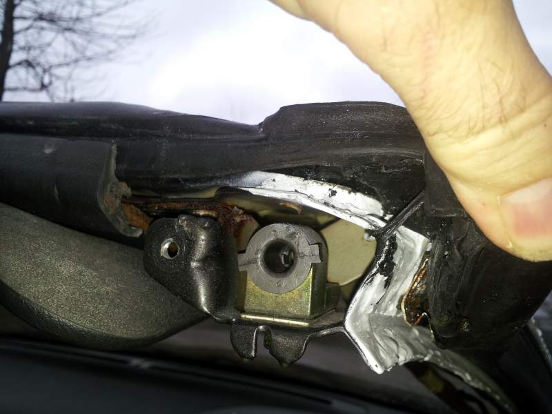

  11. OK I have some good news It looks like that last lot of sealant fixed the leak!! I have no expertise on this apart from fixing my own problem but I would suggest that if you can raise the rubber away from the metalwork anywhere like I could on the above photos with my thumb, then stick a load of silicone sealant under the whole lot, push it down with your fingers and wipe off the excess (make sure it does not block the targa drain holes) then clamp down the roof and see what happens next time it rains :yes:

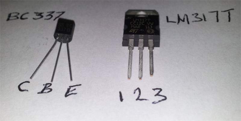

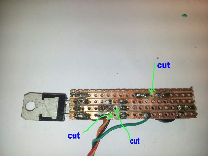

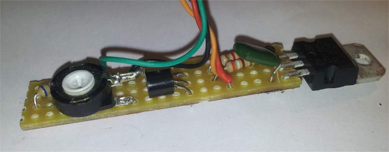

  12. I've built it on a very small piece of veroboard I used some components of different values as they are not critical and I just used what I had lying around. In particular I used a 6K8 resistor instead of a 10K one nad also a 0.047uF Capacitor instead of a 0.1uF Here are the photos It's small and narrow enough to glue to the inside of the pods holding the guages Don't mount it by the metal tab on the LM317T - it's connected to 12V !! Fitting -------- Cut the red wire feeding power to the guages. Connect the cut end of the red wire (feeding the power in) to the red wire in my photo below Connect the other cut end of the red wire (feeding the guages) to the orange wire in the photo below Cut the black wire going to the guages. Connect both the cut ends plus the black wire coming from my circuit all together Connect the green wire from my circuit to your side lights +ve Turn on the side lights and adjust the variable resistor for desired dim level Turn the side lights back off and you are back to full brightness The guages probably won't work properly when dimmed (certainly the voltage meter does not) but at least you are no longer dazzled by night Rich

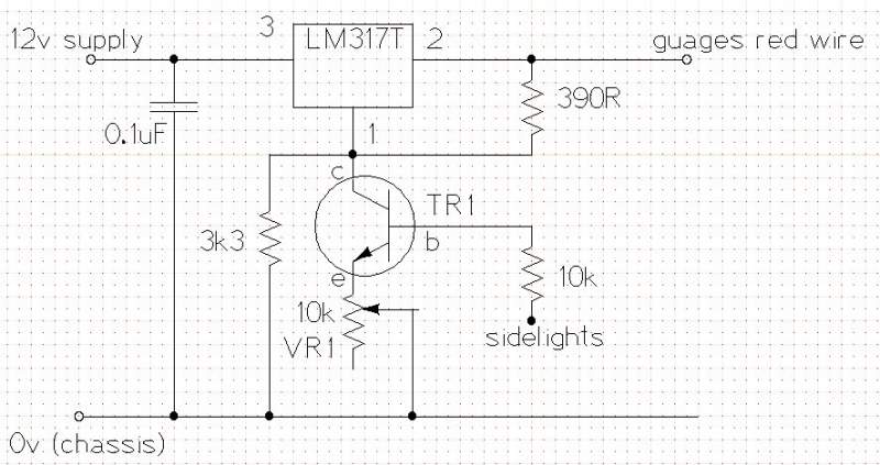

  13. Hmm OK the problem I have is I can't see anyway to get these guages apart because the front bezel is formed around the outer casing so I can't ge tto the internal wiring and the illumination circuit itself Therefore when you reduce the voltege supply to dim the guage on the red wire it also affects the voltmeter. It probably has some effect on the boost and fuel mix guages though i can't test this without attaching it all to the car which I'll probably try tomorrow Here's the circuit diagram. The LM317T is a variable voltage regulator that is used to power the guages When the sidelights are off the output from the LM317T is set by the two resistors 390r and 3k3. These values have been chosen to allow 12V to be supplied to the meters - threfore they have full brightness When you turn on your sidelights this also supplies voltage to transistor TR1 via the 10k resistor The transistor turns on and connects the variable resistor VR1 to the voltage regulator. This alters the voltage supplied to the guages and so the brightness. You adjust VR1 to set the desired dim level. I used a 10K variable resistor as that is what I had around, but all the voltage adjustment happened towards one end of the resistor being turned, so I would suggest a lower value, say 4k7 You only need to connect to two of the legs on the variable resistor (the middle one plus either of the end ones). The arrow on the symbol for VR1 is the middle leg The transitor could be just about any general purpose NPN transistor. I used a BC337 It only takes a few components to build the circuit and all these parts are available from maplin quite cheaply. I took a photo of the LM317T and BC337 transistor so you can see which leg is which The video shows the circuit in operation Sorry that's the best I can do unless someone can figure out how to dismantle the guages without destroying them dicky

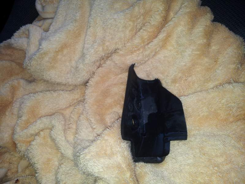

  15. We got a lull in the rain so I just went back to the Zed to remove the guage pods from the windscreen pillar (to have a look how to dim them re znut's thread) What I noticed was when I took the plastic end cap off the rubber (I have to do this to get the guage pods off) it still had water in it - that's the cap shown in the first pic below I'd suggest anyone who still hasa leak, remove this plastic cap and see if hte water is getting in there It seems to me that water is still getting in from the part of the rubber I am showing lifted up in the other pics. It gets in just to the rear of the part I sealed down as per jeffs thread So I have now tried sealing down all the part I could get my fingers under - let's see what that does
  16. OK heres an update I did reseal as Jeff posted and left the car in the garage best part of 24 hours I now have fixed pretty much all of the water leaking in via the top guage pod However i still have a severe leak on the drivers side! Now I had a look at the targa rubber itself as I think it may be leaking from here Mine does not look very even - I attached a couple of pics Should the rubber be that shape? It looks more even on the passengers side and that side is not leaking now (or hardly at all) My brother in law (who was an RAF engineer) came up with a good suggestion (sounds good to me anyway) which was to wipe the rubbers dry, rub chalk dust over them, then put the targa down and leave the car out in the rain He says any water ingress will be obvious then as it leaves tracks in the dust Don't have any chalk but I'm gonna try talcum powder see if that does the same job Meantime - are these rubbers mis-shapen? dicky
  17. Be careful guys you are powering several LEDs to light three guages so wattage disipated by the resistor is important to consider otherwise it will overheat
