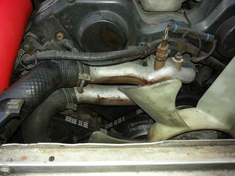

  7. How do I get them off? I thought they were just part of the block, does that mean the fan and belts too? Am I going to have to remove the timing belt? The fuel leak is on the rubber hose at the front between the fuel rail, Have a watch of the video, you'll see it pissing out. Not quite sure how I'd pressure the coolant system, would I have to get an adaptor for the radiator cap?

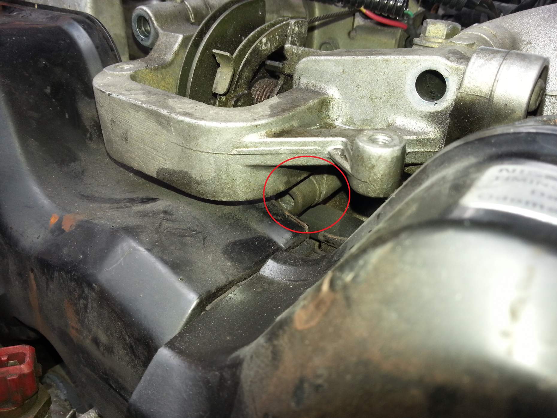

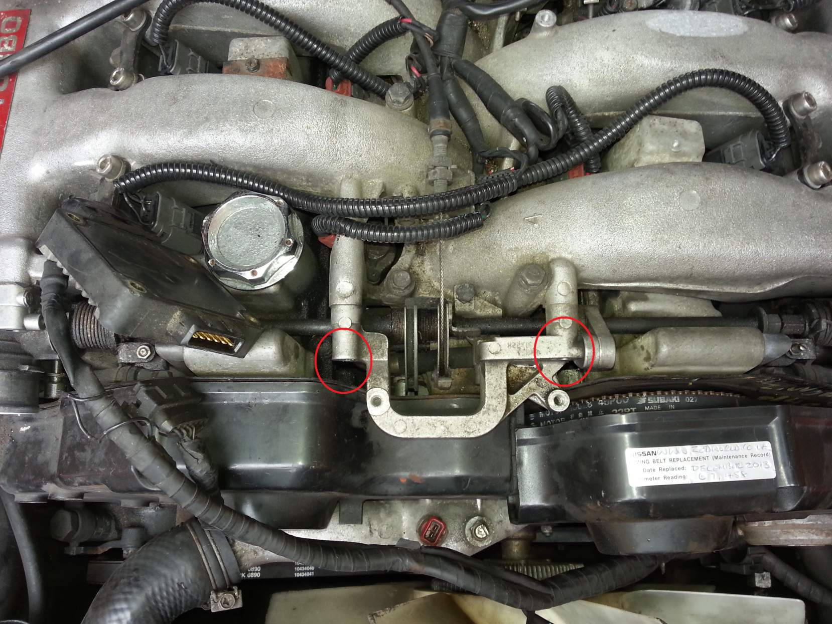

  8. I've removed the two bolts that were in the red rings, and I've removed the 4 bolts around each of the butterfly valves, what else do I need to remove?

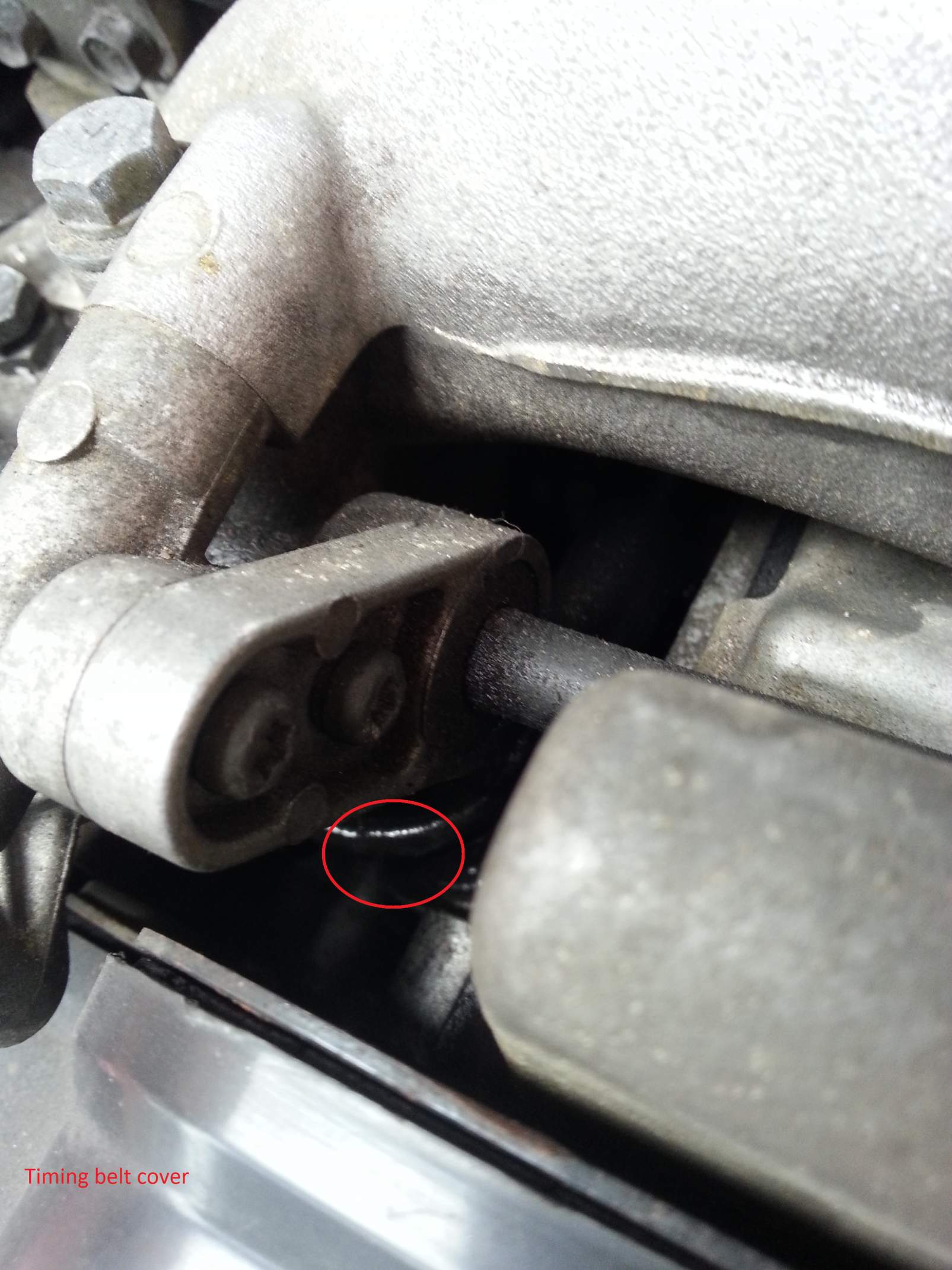

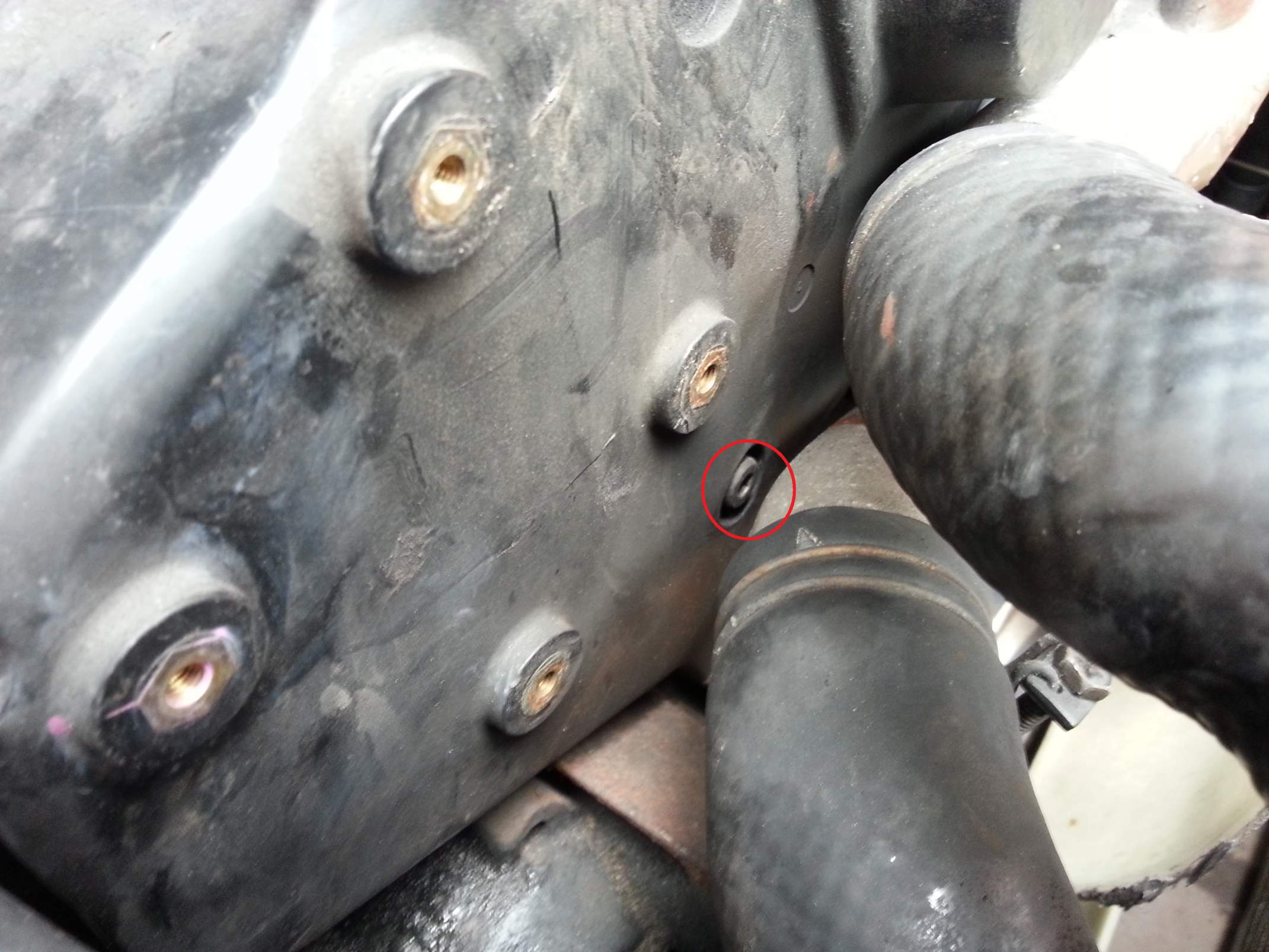

  9. Had a go at the fuel leak earlier, thought it would be better to do that before the block test, other wise I'd be pissing fuel out all over and it may even set on fire. Am I right in saying I can just take off the full throttle assembly to access that hose? If so how the hell do I get this bolt? Thought if I removed the timing belt cover the backing plate maybe removable without disturbing the belt, but then cam across this one. Any help guys?

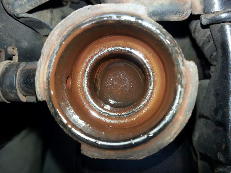

  16. So no plenum off? that's reassuring at least. All seems dry inside, so think the matrix is ok. As for the block test, my mate is bringing a similar bit of kit from his work at the weekend so we'll get that done. If it was air locked, is there a possibility of it coming out the rad cap or from the overflow? Here's the stains on the front, And here's what the water looks like Did notice that the electric fan at the front of the radiator didn't kick in, so I'm guessing that's buggered too. come to mention it I don't think I've ever heard it go.

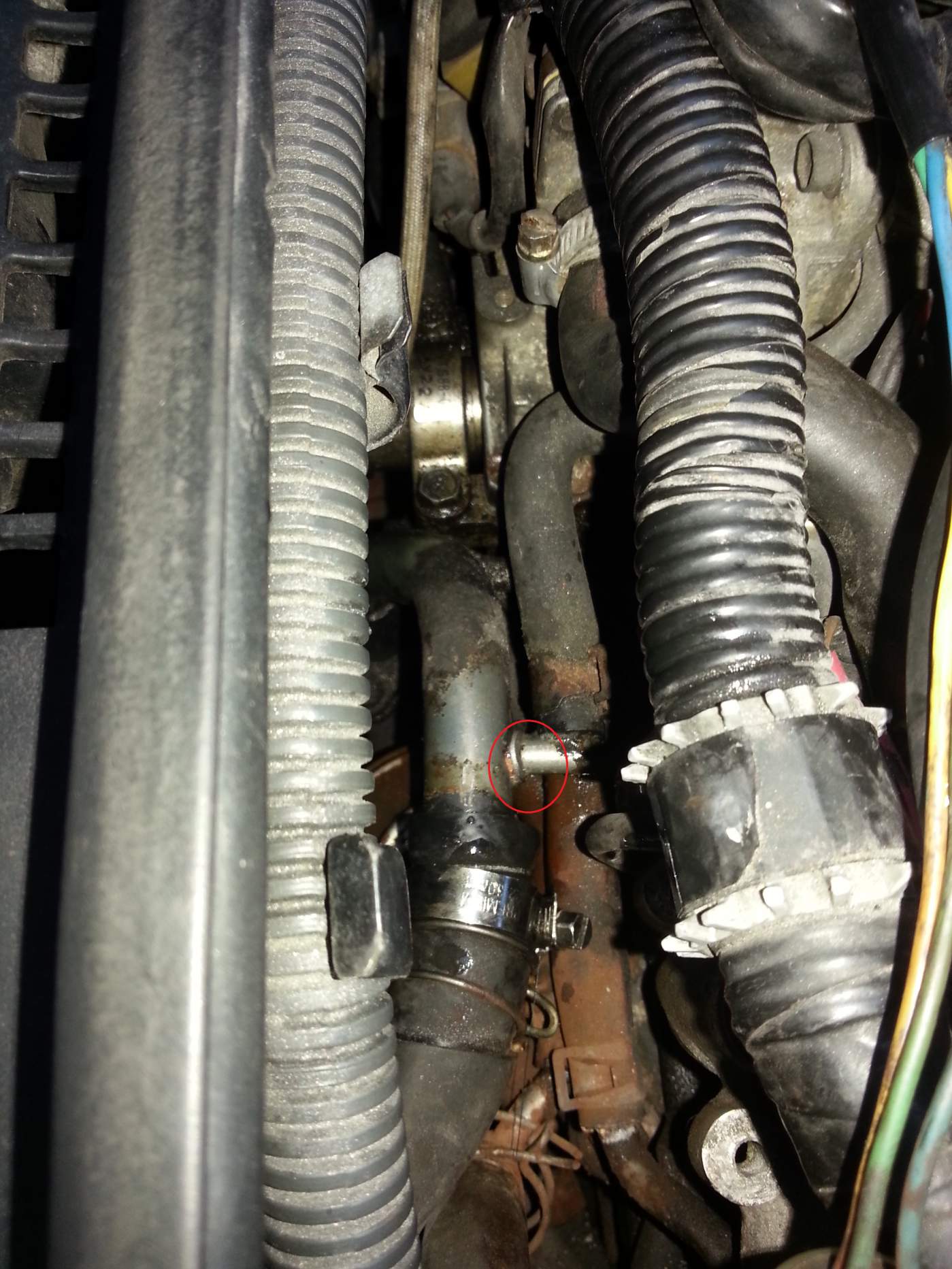

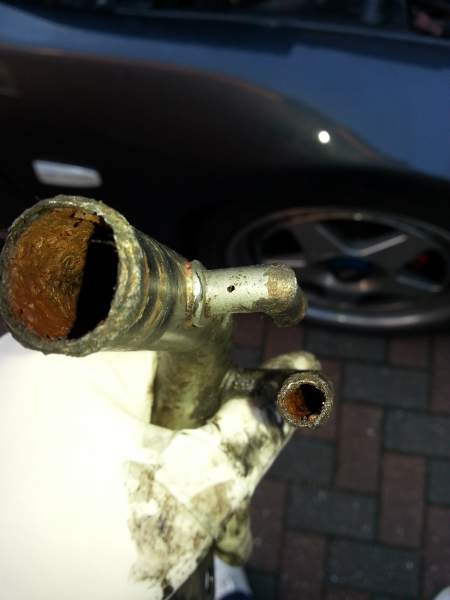

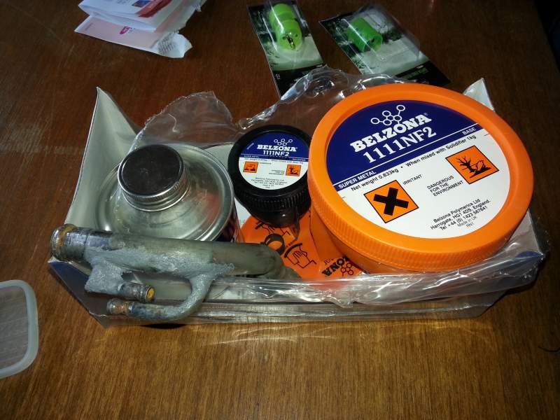

  23. Well tried two avenues, my mate got me a new pipe, and I got some belzona chemical metal, so bit the bullet and took the old pipe off. decided to strengthen the new one with some of the emetal, just waiting for it to cure before we fit it. there's the little pin hole that caused all the problems. And here's the new pipe hopefully should have it all back together soon.
  24. Thanks guys, I want to say it's the passenger side one. I never even thought of chemical metal. There's loads in a store at work so I'll see if I can get some today, not sure on the brand, it's in two parts, one in a black tub, and one in an orange tub. Definitely not happy about removing the timing belt, Jeff just did that before Christmas too, would that be the case if I were to replace the rocker cover gasket? As for the boost leak though, guessing I've no choice but to remove the plenum?
  25. Turns out it's not fro the hose, I removed the clip and replaced with a jubilee, that obviously didn't work, so pulled the hose back a bit and did the washing up liquid bubble test, and it turns out it's actually on the join of the little branch. I've got a video of some bubbles ut due to vimeo been shit it's gunna be another 30mins Here's the link anyway Now am I been silly for suggesting k-seal or Rad-seal or some other sealer here? It'll only be a temp fix, but it's not the first time the zed's had some, and that was when I first bought it, and that's been fine since.
