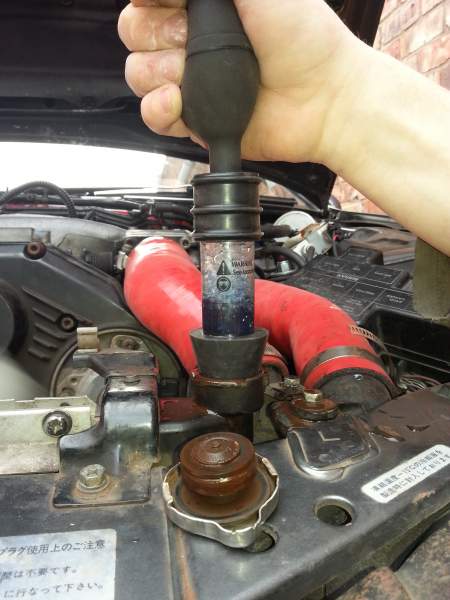

  21. Well when it's running it behaves sound, since changing the rad I could give it a good boost and all would be fine, it was only after knocking it off and listening at the rad that you'd know anything was up. Until of course it pissed out all the water. The block tester was what my mate brought home from work, that's all that was in the box with a bottle of the fluid. Said it would turn one colour for petrol and another for diesel. I thought it looked the same as the one vodkashots posted a link to. I could give a cylinder leak test another go, but we couldn't get the piston in the right position. Anything else I could try?
  22. tried it a few times, from cold and when warm... I figured it could be on it's way out, hence when it was warm the compression test was fine too, but as I've been taking it for little drives it's been getting progressively worse..
