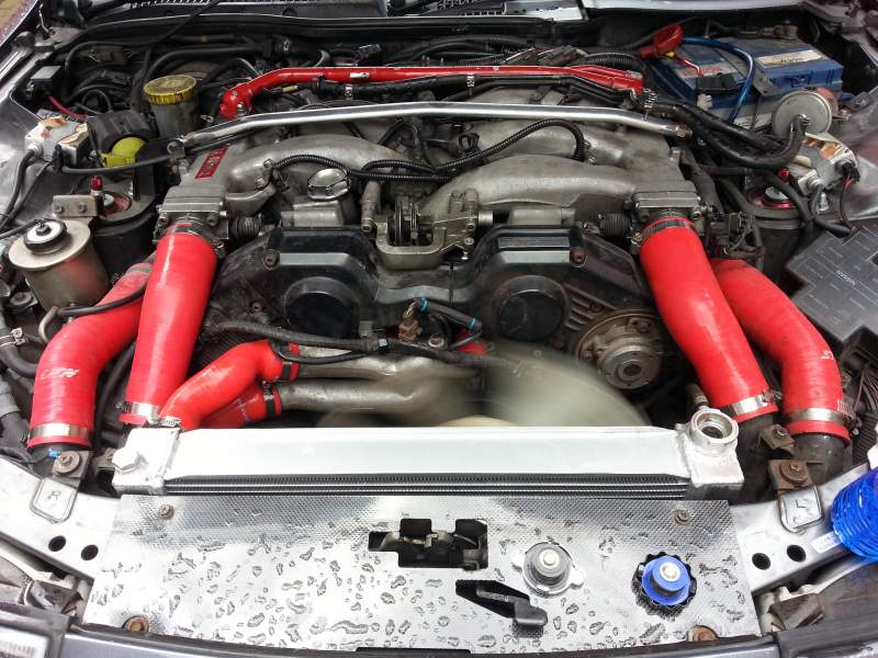

  6. To try and cure the problem of the coolant boiling over As some of you know I bought an alloy rad and a new thermostat and changed the hoses. While all the hoses were off I managed to flush the system through each one of the holes with the front pipes off to check the flow, and it all seemed good. managed to get rid of all the minging brown water too. Got the new rad fitted and bled up ok, but something still didn't seem right. After every test drive with my ear close to the rad cap I could here the coolant bubbling, It was no where near as violent as it was from the old rad, it was shaking the overflow bottle or leaking out onto the road. (the old rad cap was rated at 1.2 bar, and the new one is at 1.3 bar) and the temp gauge wasn't shifting at all, just showing a nice running temp. So I haven't really been driving it, just little runs after trying to bleed it a little before each one, (because the level had dropped so needed topping up) I took it to work with me the other night and it's only a short drive and I don't even think I put it in positive boost, but the sound was still there when I stopped, I could also here a bubbling sound towards the back of the engine but everything was still dry. After a few hours I opened the cap to see what the level was like and it hadn't really changed but there was some pressure built up. Anyway something finally gave yesterday and it pissed all the water out, I wasn't far from home though so managed to get it back ok without the temp even moving. I took a video when I pulled over, lots of steam but hard to see where it's coming from, I thought it was from the turbo pipe which was weird but I think it's just dripping there from somewhere above. So I was mentally preparing myself for a head gasket change. Even when I thought It could just be a hose somewhere or a blockage, I figured If I'm going to go to the effort of taking the plenum off I may aswell go the hole hog and get the head off too. Me and a few friends are going to attempt it on my drive while the weather's still nice. So where's the best place to get the kit from? is there a write up any of you have used and would recommend? and what other jobs should I do whilst the head is off? My thought's were valve stem oil seals, full egr delete, water bypass, replace any and all hoses (where best to buy them from?) and not sure if it's possible, but can I change the piston rings with the block still in? Also it did cross my mind that with the manifolds' off, it would probably be wise to do something with the turbo's too. is there a recon service or is it just better to buy new, or is it just as cost effective to upgrade them and get bigger one's? I'm aware this is going to be a costly exercise, but does anybody have a ball park figure how much I'd save between doing it myself or paying somebody else to do it? Luckily I think I should be able to get the head skimmed at work so that could save a few bob. As always advice comments and support welcome.

  15. Sorted Radiator ordered, and group buy price honoured. Cheaper than any on eBay, and much happier with a reputable brand. Just to be sure think I'm going to whip out the thermostat too and check that while the rads out. busy day Saturday :biggrin:

  18. So still trying to fix the Zed, and having some cooling problems, the radiator is boling over into the overflow, tried changing the rad cap but no success, more worrying thing is that the bottom of the radiator seems to be staying cold where the top is boiling. Don't think it's the hose either at the bottom. So thoughts were to get a new alloy radiator and I've already got some silicone pipes to fit anyway. then take off the water pipes on the block and check the thermostat. Question for now is, which radiator to go for? I've seen a few on eBay for around the £118 mark, and zcenter have one for £120. Has anyone bought a bad one? Car was an auto at somepoint but is now a manual if that makes any difference. Any help or thought welcome as always.
