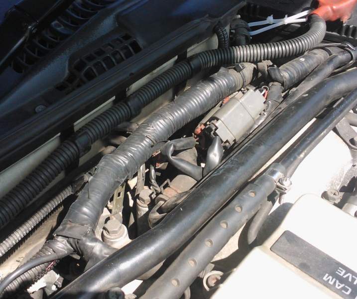

  10. Remember these cars are 20+ years old and solder joints, terminal joints etc WILL break if moved, if you look at my picture of the loom that i had to bend back to "fix" the problem, you can see that it has had some work done on it, there is a 4-5 inch section wrapped in electrical tape, there is definitely some splicing gone on in there.. should i go in and check it out...might have to as i may need to access the yellow connector at the back of the engine further towards the battery. Rich
  11. YEAH!!!! She Lives on 6!!! Well I have fixed (sort of) my misfiring..coil packs, spark plugs, injectors,o2 sensor,tps...no, none of these.. you know I said I was fiddling about with the loom, well I was looking at it and thought "moving the loom caused it, moving it back might fix it", so I grabbed it and bent it back the other way. low and behold the note changed and she was back on 6. Fixed..as I said, sort of. now some say if it aint broke don't fix it... but if I go delving in I may disrupt other things. But something is wrong and part of me really wants to get it sorted. Watch this space.. Rich

  14. Well i've had my new zed for a few weeks with no real issues, overall she's drove as sweet as a nut. Only small issue was slight hesitation (when warm) putting it into a gear, revs drop any nearly stalls, (did a few times) Well today she's been fine, then i take her out about an hour ago and all hell brakes loose. i feel like the engine is running on rusty nuts and bolts, its missing or misfiring badly, and i mean badly, i daren't stop incase it stalls and wont start. Only thing i can say happened is before i went i was looking down the back of the engine, between engine and bulkhead where there are big looms and a connector , positioned vertical. whilst moving the looms, i'm not positive but maybe a change in engine note happened, going from 6 to 3 maybe..i dunno, maybe i'm clutching at straws. Anybody help please..
