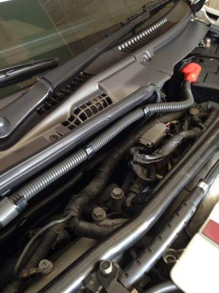

Well today she's been fine, then i take her out about an hour ago and all hell brakes loose. i feel like the engine is running on rusty nuts and bolts, its missing or misfiring badly, and i mean badly, i daren't stop incase it stalls and wont start. Only thing i can say happened is before i went i was looking down the back of the engine, between engine and bulkhead where there are big looms and a connector , positioned vertical. whilst moving the looms, i'm not positive but maybe a change in engine note happened, going from 6 to 3 maybe..i dunno, maybe i'm clutching at straws.

Well I have fixed (sort of) my misfiring..coil packs, spark plugs, injectors,o2 sensor,tps...no, none of these.. you know I said I was fiddling about with the loom, well I was looking at it and thought "moving the loom caused it, moving it back might fix it", so I grabbed it and bent it back the other way. low and behold the note changed and she was back on 6.
Fixed..as I said, sort of. now some say if it aint broke don't fix it... but if I go delving in I may disrupt other things. But something is wrong and part of me really wants to get it sorted.

Remember these cars are 20+ years old and solder joints, terminal joints etc WILL break if moved, if you look at my picture of the loom that i had to bend back to "fix" the problem, you can see that it has had some work done on it, there is a 4-5 inch section wrapped in electrical tape, there is definitely some splicing gone on in there..
should i go in and check it out...might have to as i may need to access the yellow connector at the back of the engine further towards the battery.

I checked it with my spare car and yes, there is some tape, but looking at it it goes further along and i can tell its been done after,

What's with the cable tie between your loom and battery terminal?
MOT failed on various things inc loose battery, i couldn't get a battery clamp in time so i just secured it with cable ties, i'm looking for my spare battery clamp but its dissapeared.
