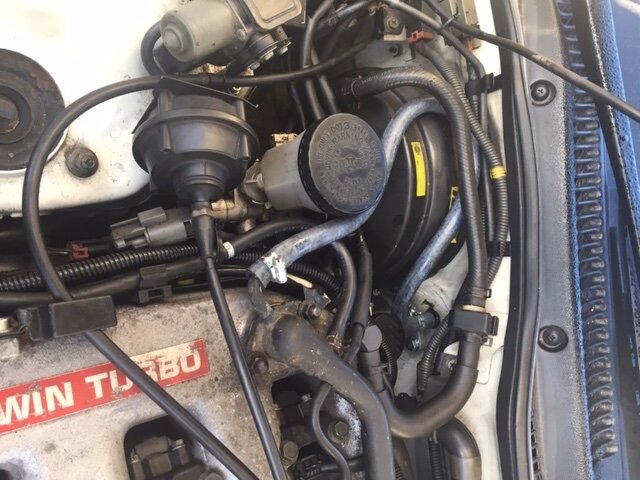

  7. Hi Andrew, a little late with the photo, the valve is here.
  8. Hi jimmer, the car remained in the garage until the valve was fitted. valve arrived a week last Friday from CZP great service. thank you for the advice. arthur

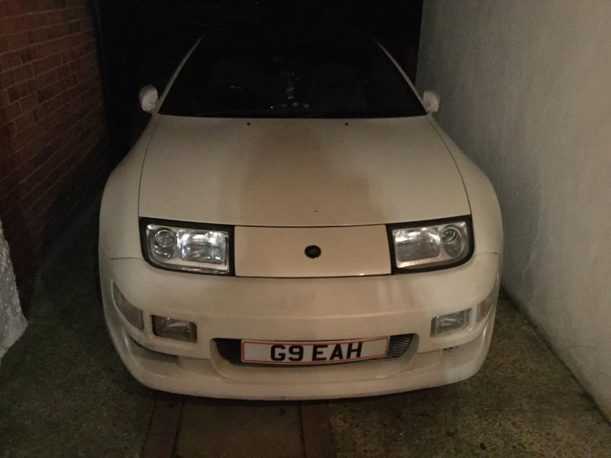

  10. Zed back home manual now!

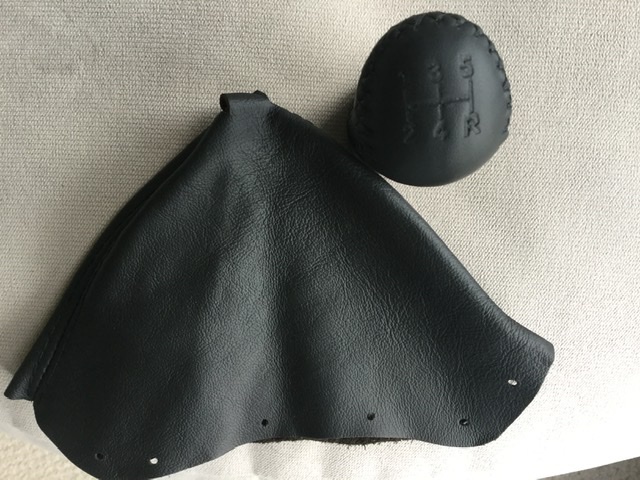

  11. Hide & Seat?Definitely Simon did my gear knob & gaiter, excellent job? arthur

  16. Hi Andrew, as my z was an auto I don’t have those vacuum tanks. My hose goes direct from the balance bar to the booster as you have mentioned. The lighter hose.
  17. Thank you for the information Andrew, as always a great help. I have ordered the one way valve & it is on its way. It is that not vary long booster hose which CZP have but LHD! Im trying to source a second hand one which is proving hard too! Art
  18. Hi Andrew, Are they available the hose & or the valve? is it a conceptz trip again! thanks for the up date.
  19. Hi, does the clutch hose that goes from the engine balance bar to the clutch slave cylinder have a one way valve in it?
