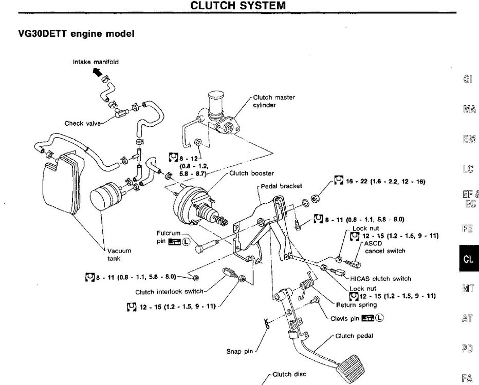

Hi, does the clutch hose that goes from the engine balance bar to the clutch slave cylinder have a one way valve in it?

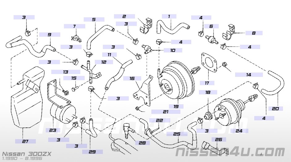

You will find getting the various hoses new an expensive exercise. CZP will stock LHD layout. The check valve (47478-05U00) is available.
This is the OEM layout for hoses and vacuum tanks (shows both clutch and brake) for a RHD car (the link includes the part #'s). You can
probably simplify the stock vacuum system components without significant change to the pedal effort. Perhaps a member who has done
an auto to manual conversion can comment if they have done just that, together with the hoses they used.
http://nissan4u.com/parts/300zx/er_z32/1993_12/type_1/brake/brake_master_cylinder_brake_servo_and_servo_control/illustration_3/

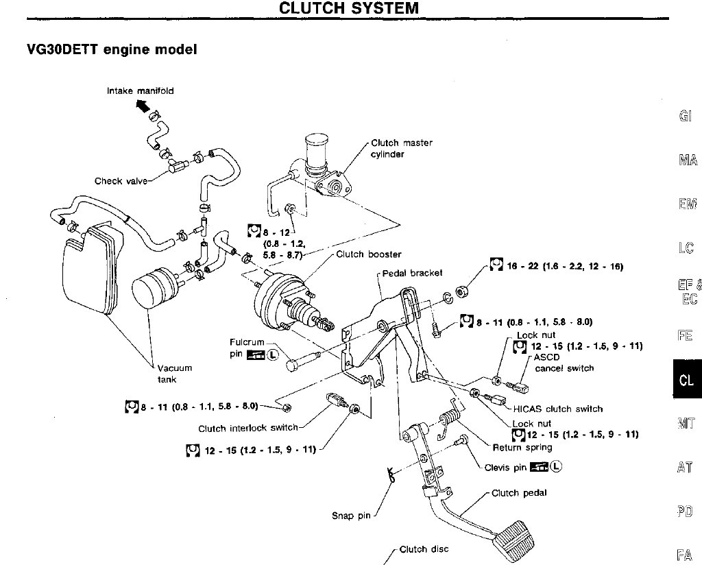

Hi Andrew,
as my z was an auto I don’t have those vacuum tanks.
My hose goes direct from the balance bar to the booster as you have mentioned. The lighter hose.

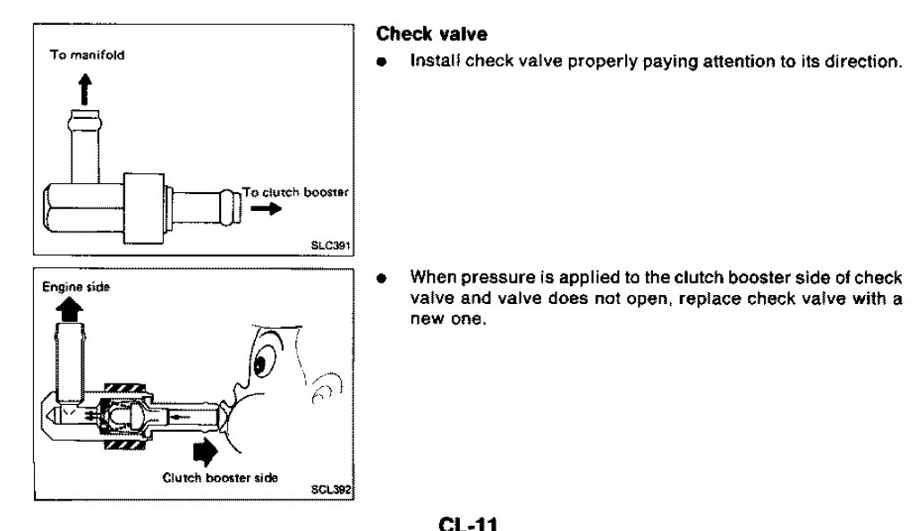

Hi Arthur,Do not be tempted to run the car under boost with no check valve you risk damaging the booster.
