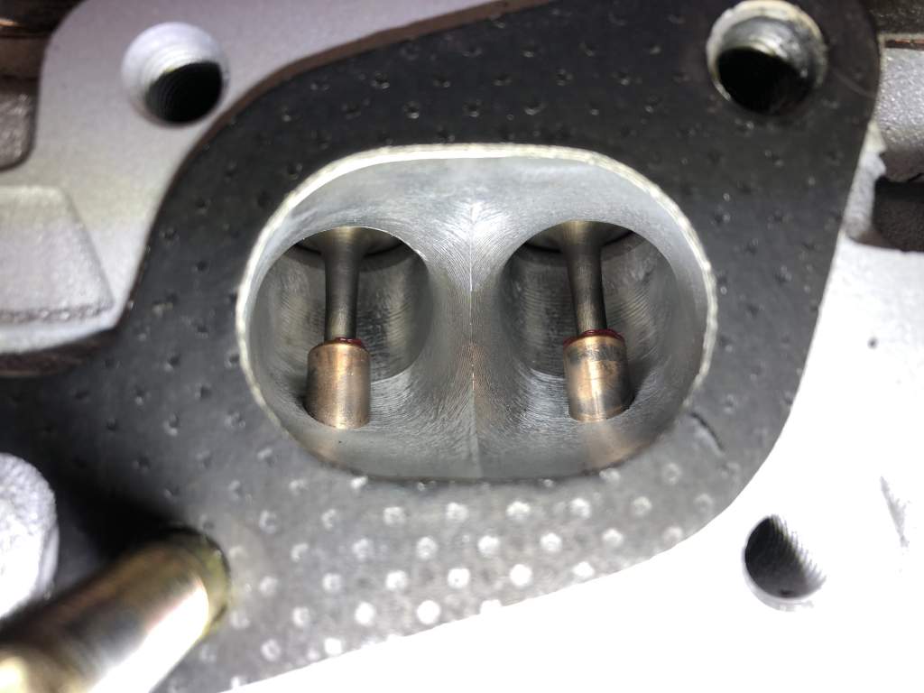

Problem 1: It turns out stainless steel, exhaust wraps and condensation don’t mix well
Before I’d even got the engine out, a new set of downpipes was added to this list. These AMS items were only 2 years old, so I was far from impressed! I contacted the retailer and after a bit of tooing and froing I secured myself a set of replacements for free... how long they will last, only time will tell!

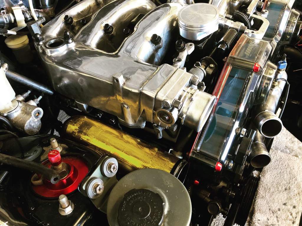

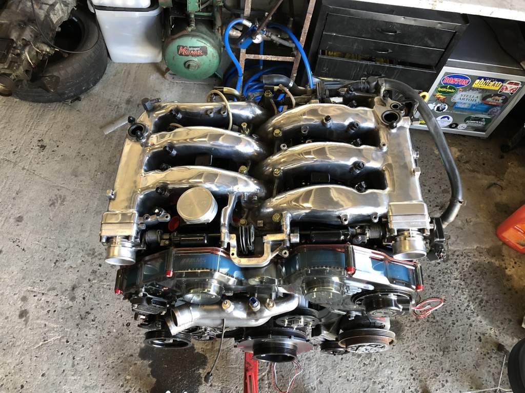

Is the Piston/Oil cap a permanent feature Nick?
A nice stock Black one would work well.

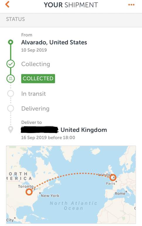

What a per-lava getting my engine collected has been!
Was meant to be collected last Tuesday by FedEx, and after lots of excuses and £235 of international calls to get them to do their effing jobs, they finally got their arses in gear and picked up my engine. (Don’t ask... it’ll take me too long to explain, and yes, I am seeking compensation)
All being well, it’ll be here on Monday

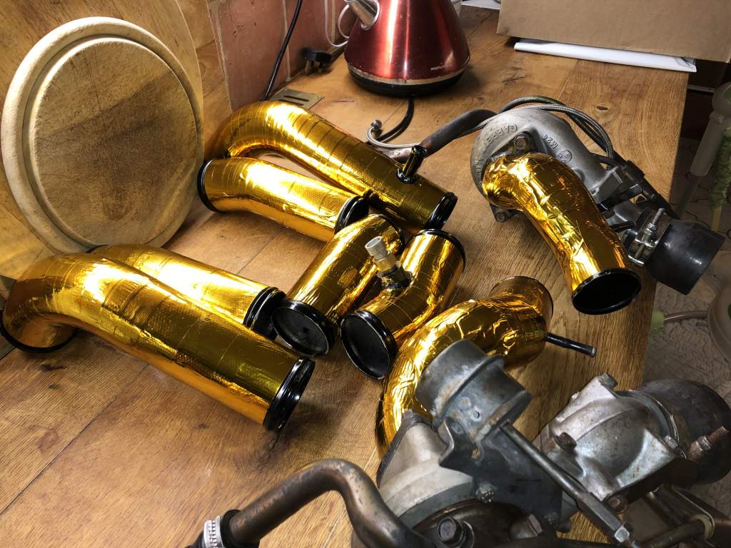

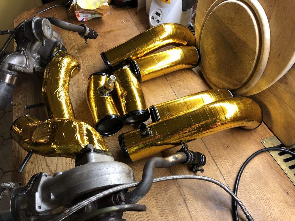

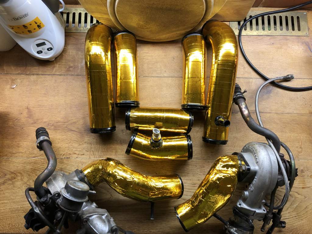

29ft 7 and a bit inch’s of DEI reflect-a-Gold tape later...
The IC pipes were fairly easy to wrap nicely.... the turbo intake pipes were simply impossible to get a crease free finish on, simply too many angles and shapes to contend with.

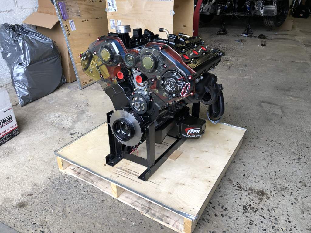

She’s home!
I’ll post more pics tomorrow, been a hectic day...

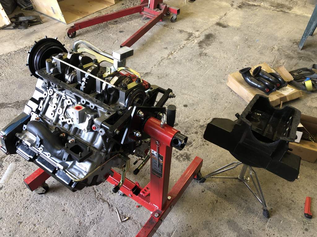

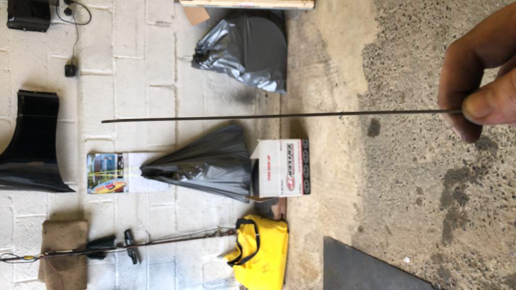

I’ve installed the dipstick tube as per usual and obvious gone to install the dip stick... only to find if won’t go all the way in and I can hear it fouling against something metal inside the sump... how odd. Message Mitch to find this is an unheard off issue to him with all the main caps kits he’s sold. So I try rotating the dipstick and it drops in. Sweet. Go to pull the dipstick out with one finger and it instantly grabs and releases leaving me with...

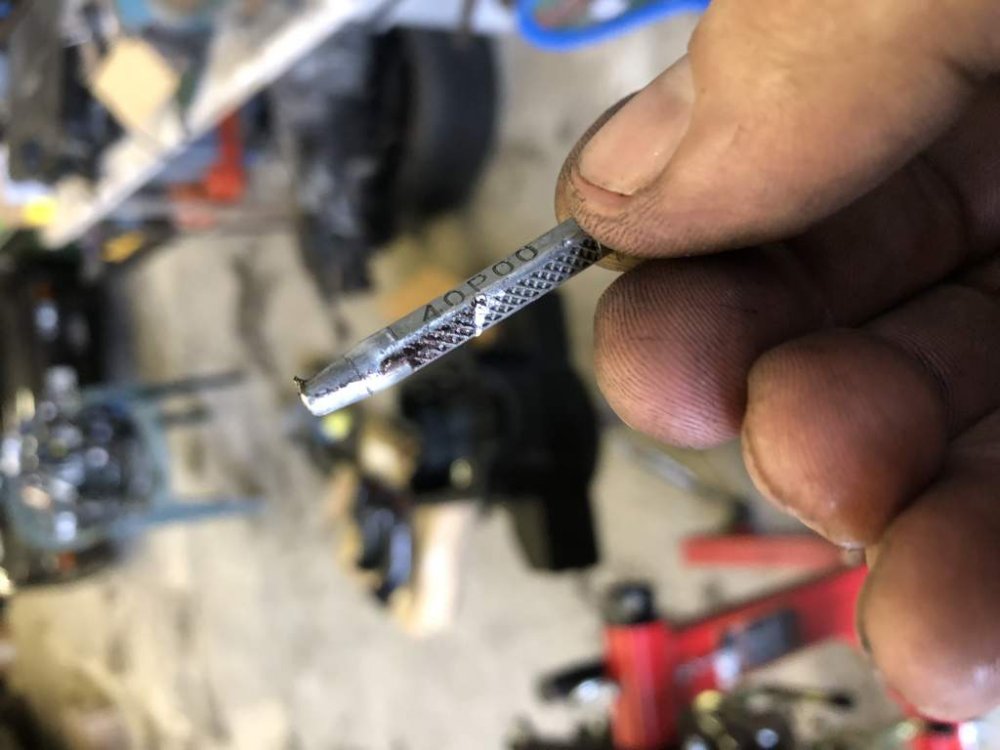

What the eff! The measuring weight at the end of the dipstick had come off leaving me no option but to have to remove the sump to retrieve it.... balls.... but at least I got to see my engine internals first hand
Managed to retrieve the end without any issues
It appears to be a clearance issue between the girdle and the pickup that’s grabbing onto the dipstick. Obviously I’ve made Mitch aware and much pondering is being hand as to how to resolve the issue as easily as possible.

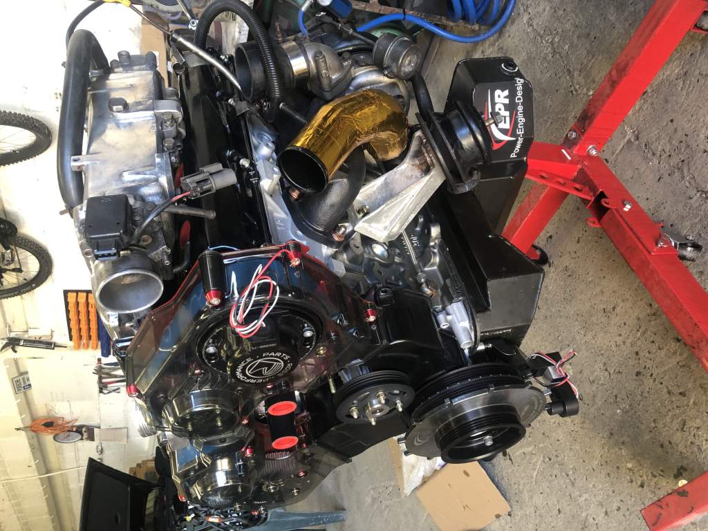

I’ve then moved onto rebuilding the turbos. A new one for me as I’ve never rebuilt a turbo before. While the assembly is straightforward enough, getting the “clocking” of the housing correct look a bit of trial and error

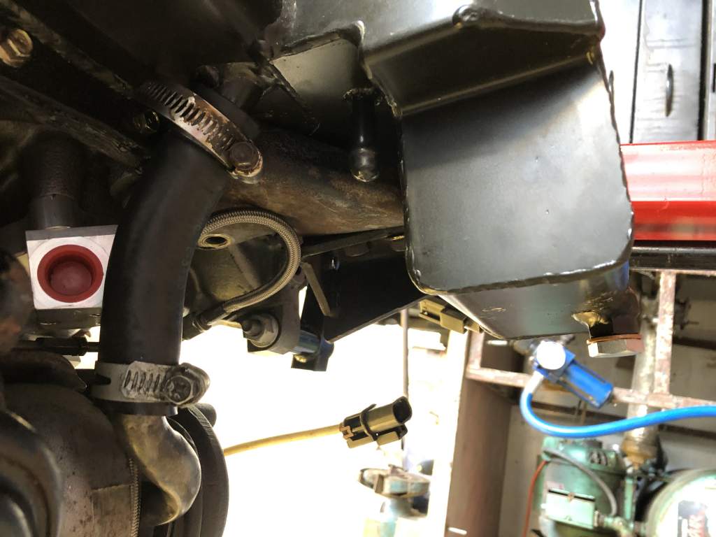

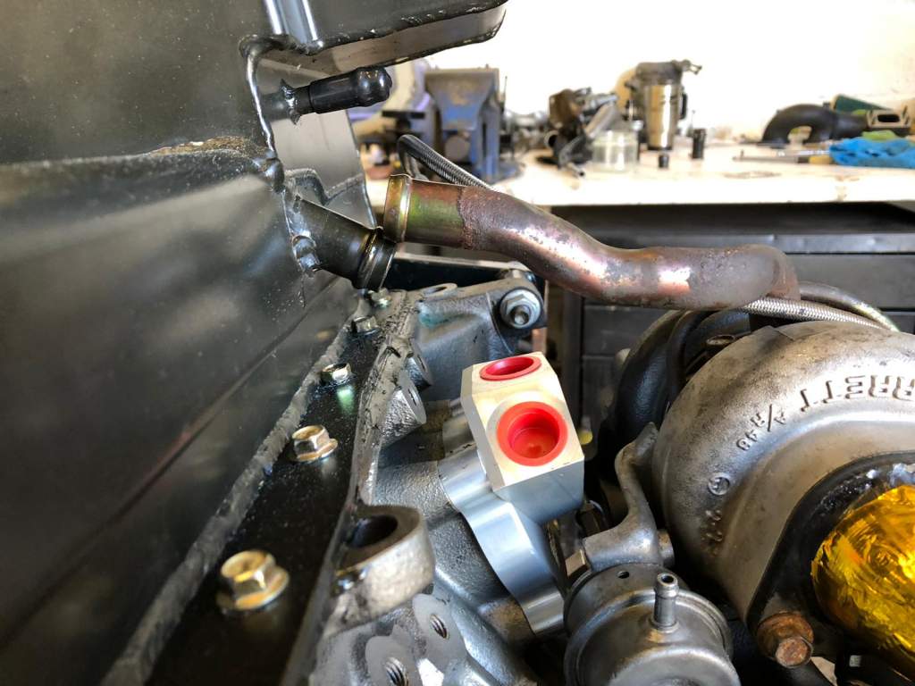

Onto installing the turbos and the issue became apparent

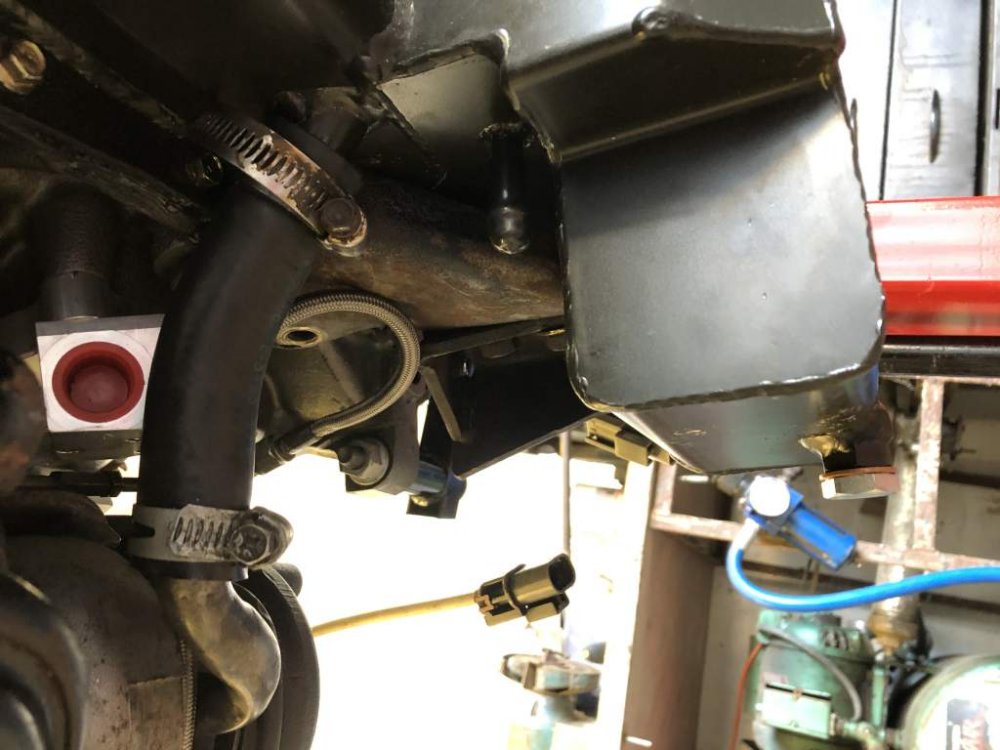

As with all after market parts, tweaking is always required, and I come to expect it. So to solve this I cut down the drain pipe just before the upward turn, flared the end and used a section of reinforced rubber hose to join up the drain to the sump. Didn’t have chance to take a pic as was a little stressed out by this point.

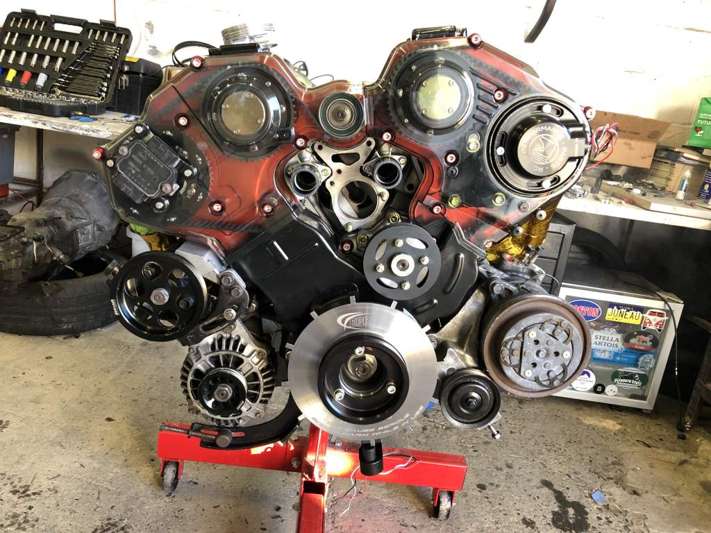

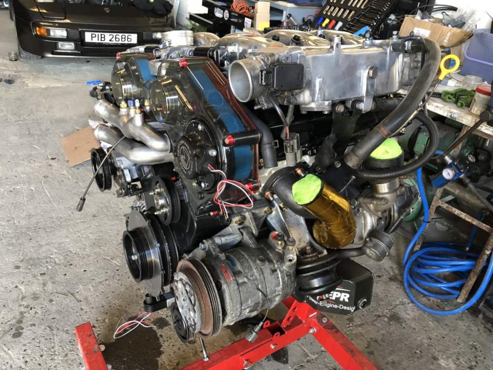

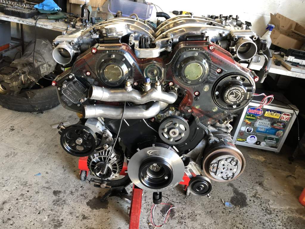

So as it stands, the engine currently looks like this
Plan for tomorrow is to get the ancillaries back on the engine and get the belts on. Then I’ll make a start on the wiring loom and refitting the interior.... hopefully tomorrow will be a little less stressful!

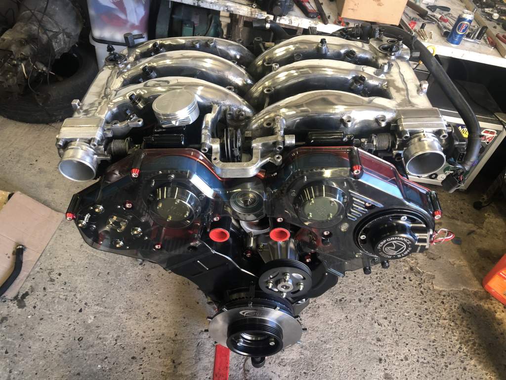

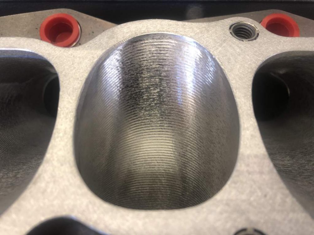

Also took a few pics showing some CNC details I love on my engine
As promised, here’s a pic of the turbo drain modification

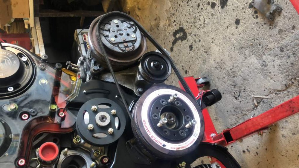

Managed to get the ancillaries on, but noticed I’ll need new aux belts (forgot the ATi Damper isnsame sized as stock, while these belts were for my underdrive pulley)

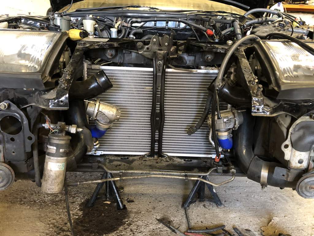

New AC condenser went in

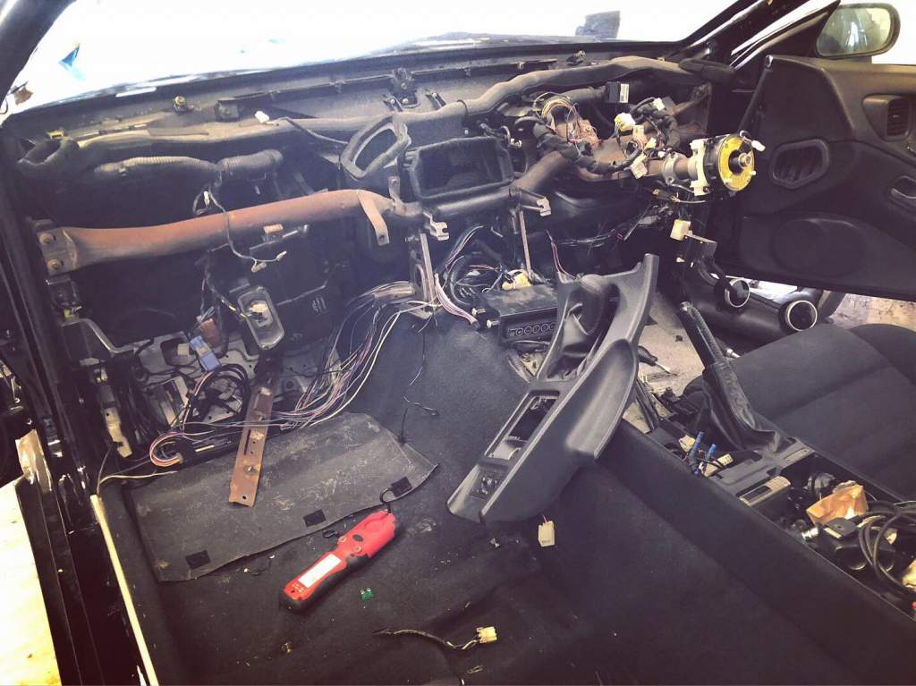

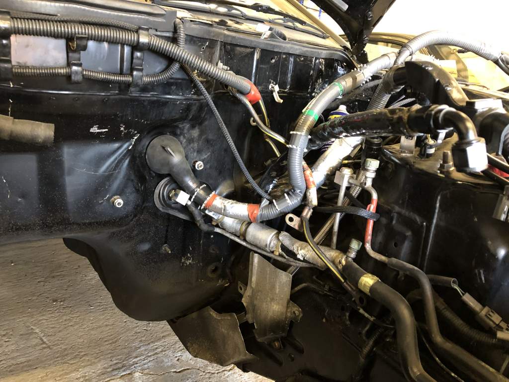

And I started on the wiring loom install
Tomorrow I’m planning on cracking on with getting the AC matrix and blower back in and start getting the dash back in

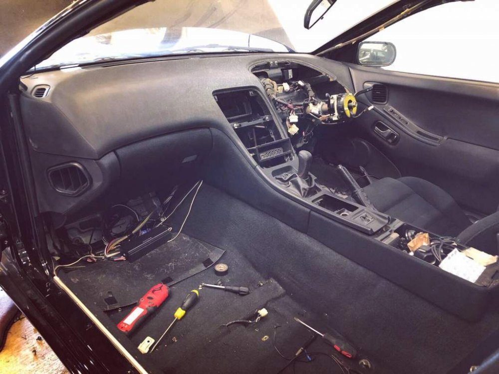

Reasonable progress today
Took a bit of time to swap the brake pedal assembly over for the cruise control as well as sorting some of the wiring out under the dash.
Hopefully the rest of the interior will be back in tomorrow

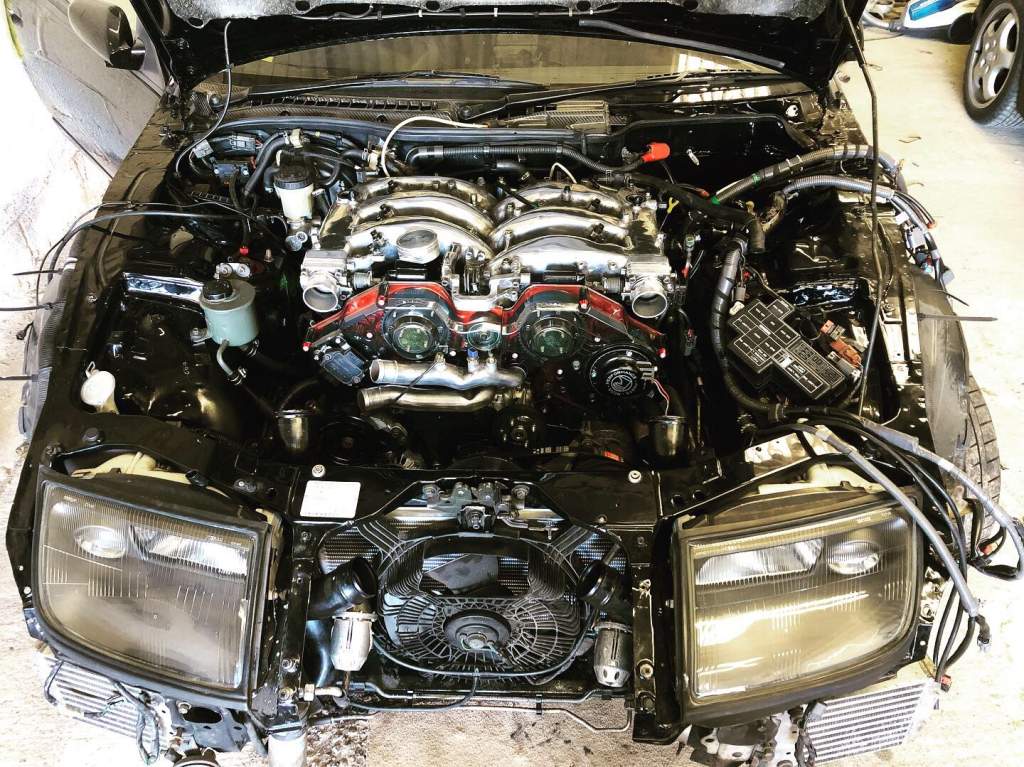

Well bar the aux belts, it’s ready to be installed

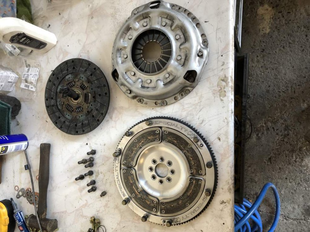

Gave the clutch and flywheel a bit of a clean before installation

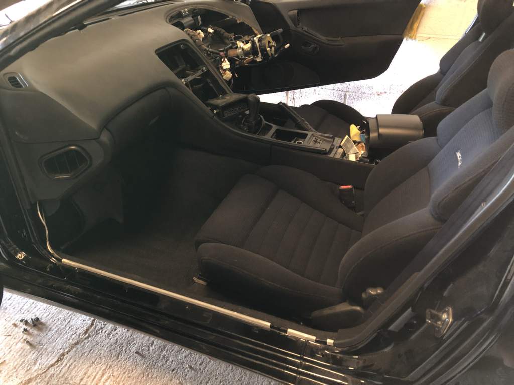

And did a little more interior work

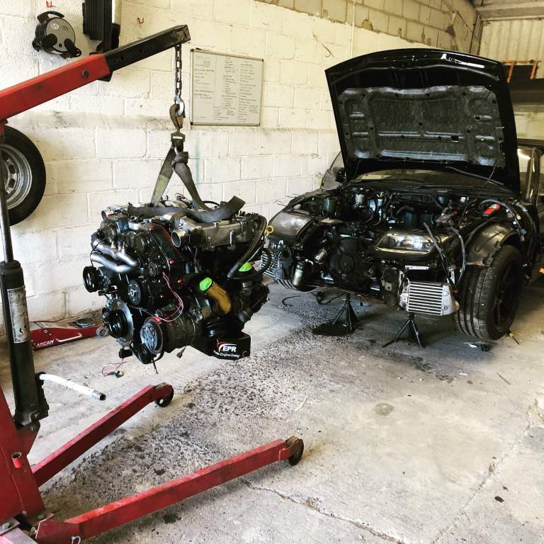

Will finish the interior tomorrow while I wait for the belts to be delivered, and being well the engine will be back in the engine bay tomorrow
