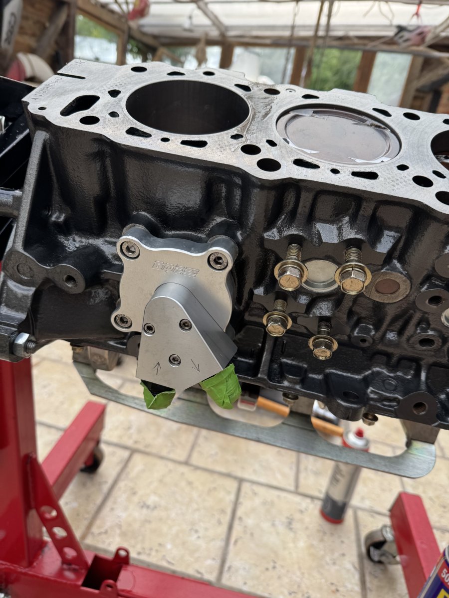

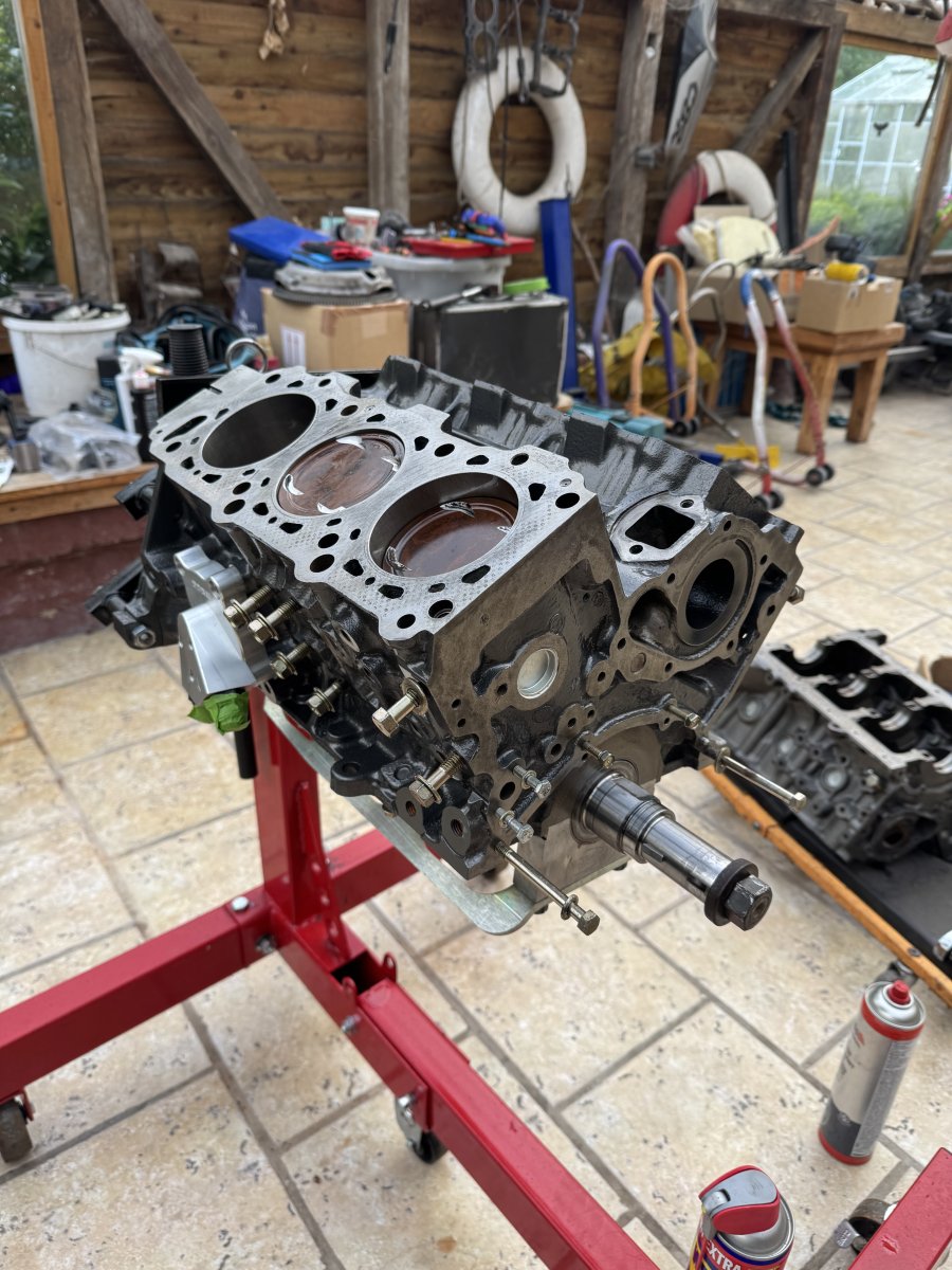

The Z was stored off the road from Oct 2013 until March 2015. I’d had a major knee operation at the beginning of 2015 which meant I was going to be off work for 6 months. I’d saved up enough to start thinking about a parts list to rebuild her and frankly, after a couple of months of staring at the same 4 walls, I was going stir crazy! I employed the help of a good friend and decided to pull the engine and see what was what.... just a head gasket my arse!
