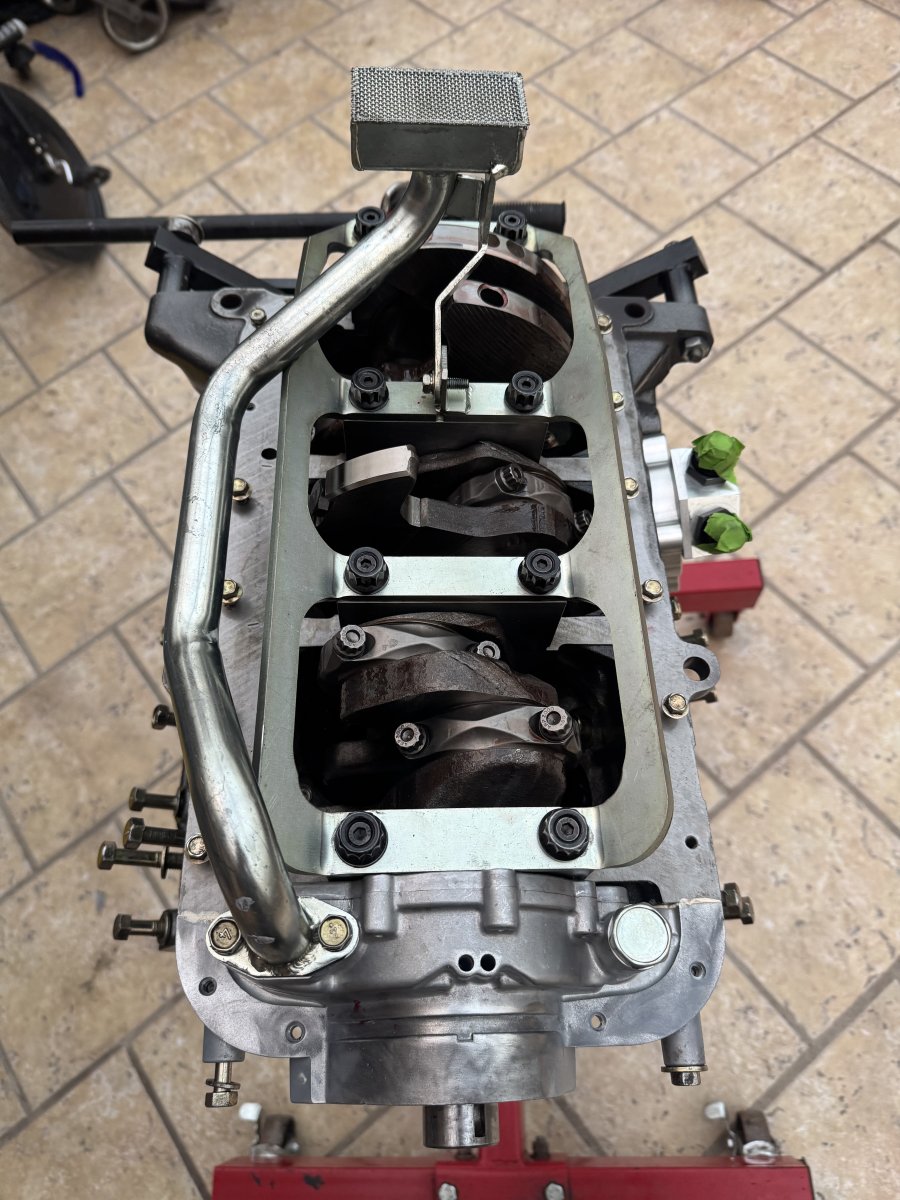

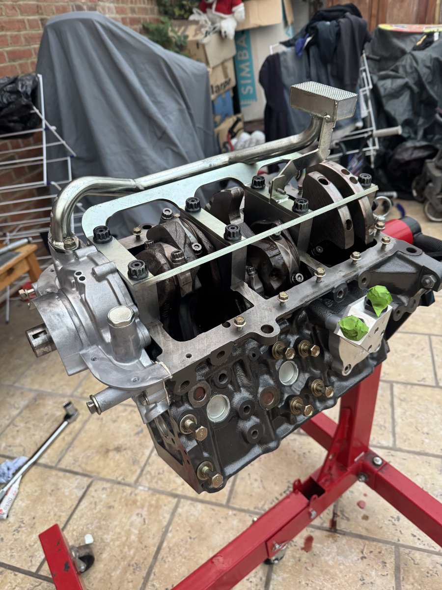

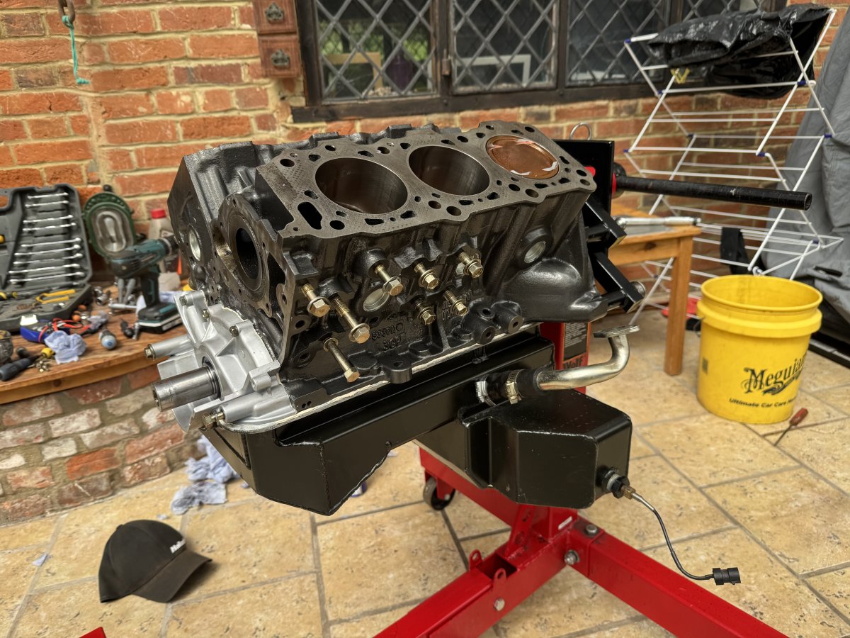

Pistons and rods installed. Just waiting on a set of STDX King rod bearings to make some adjustments to my big end bearing clearances…. Unsurprisingly, the STD size bearings EPR used produced 0.0017” clearance not the 0.0035” quoted in the build sheet. Targetting 0.0025” for this build. Also reinstalled the @brettdempseyengineering oil tree. Oh and I will never use a ratchet piston ring compressor ever again, these ring compression sleeves are SOOOOO much easier to use!!
  • 4 weeks later...
Bottom end is now complete.
Hopefully get it back to my unit soon so I can start work on the heads and get the long block complete

Bit of a backward step this yesterday.

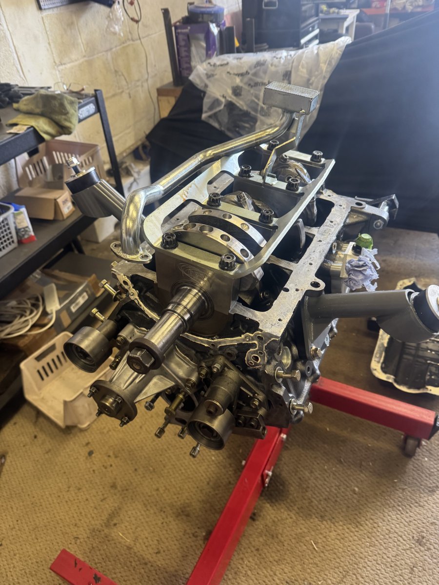

Got the short block back to my unit and installed the BDE engine mounts, water pump etc. After spending a ridiculous amount of time clearing the crank timing gear (wasn’t smooth going on the crank snout) I span her over to start working out true TDC, when I felt a gear like notchyness at a certain point in rotation. Given it was smooth as silk when I span it over prior to pump install, I instantly thought oil pump. Removed the sump and pump, and all spins over smoothly again.
Pump was a replacement sent by EPR immediately after its failure, and clearly wasn’t new as it had very little assembly lube inside it. Having taken it apart I can see it galling inside the pump on the leading edge of the small gear, so in the bin that goes and a new pump on order….. dear lord they’ve got expensive!!

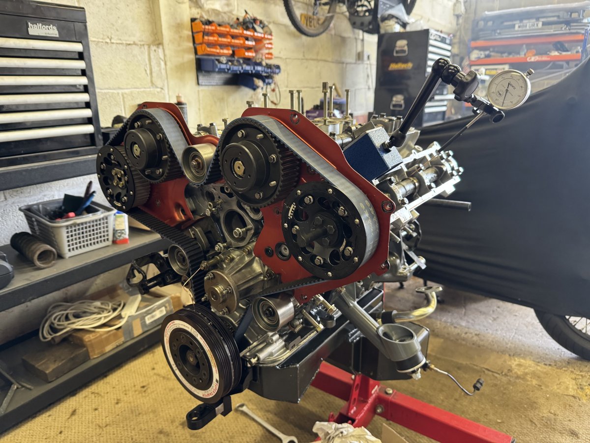

Spent some time finding true TDC ready for timing the cams up.
New oil pump arrived courtesy of @conceptzperformance (brilliant service as always) and got the cylinder heads on.
Next job will be set up cam timing and measure piston to valve clearance. Once complete I can order the new set of head gaskets and start the final assembly
More progress. Verifying the cam timing and found the exhaust cams were off by 3 degrees. Surprised that the intake cams were spot on where the should be considering the new block and heads being skimmed.

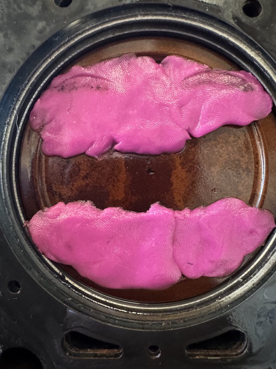

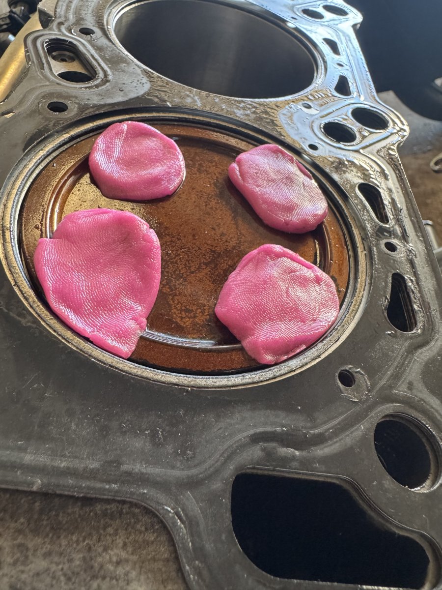

Next job is adjust the cam timing to get it to spec, then pull the heads off and play doh the pistons and check Piston to Valve clearance. Will also advance the intake cams 10deg to simulate VTC activation and make sure everything has plenty of room
Haven’t messed with Play Doh for probably 40 years 😅. Cam timing has been finalised, so was time to check piston to valve clearance. Turns out I’ve got LOADS. 4.4mm on intake and 4.9mm on exhaust. Finally day of tinkering complete before the family holiday to Sicily. Straight back to it when I’m back, and hopefully take delivery of my new Singapore swirly boys
