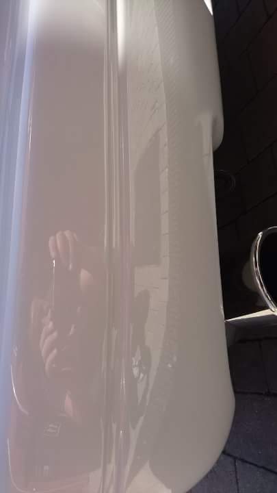

I'm very excited. The rest of the car will look almost the same....except for one thing...the paint!! I'm totally done with pearl white paints. They can look nice, but almost all of them look cream/beige in off-light situations and that has started to bug me. The rear quarter of my car is a very slightly different shade on my passenger side for reasons unknown and the previous paint shop just couldn't rectify it; some keen beans may have noticed that when they've seen the car in person! Trying to rectify damage or repaint areas with pearls is an utter nightmare as you end up chasing the paint round the car in an effort to blend.......soooooo......the new colour is going to be a metallic white which is a paint I'd not really known about but had wondered whether one existed. It turns out quite a few do and I've had the colour chips through today of those that I'm interested in comparing. The beauty of these new metallic whites is that they lay like a traditional metallic so you don't have that pearl mid-coat that is the thorn in my side. Metallic whites don't look beige or off-beige/cream out of direct sunlight, yet they still sparkle in the sun like a pearl coat, some more than others. It's almost like a modern take on QN0 which is a pearl white used on 94+ Z32s, but with half the maintenance and a better look.
Although mine's in good condition, a new t-top bar is going in and rear screen top trim and other new things are going on. I have boxes and boxes of new Nissan parts.
The colour - Jaguar's glacier white metallic as Nissan don't do anything similar. I looked at a VAG metallic white also, but this didn't have much metallic in. So the Jaguar colour has been chosen as of today! It's a stunning colour and really quite subtle. Range Rover also use this same colour code (2201/NAK) under the 'Yulong White' moniker. I thought about a straight-white, but I owe it to the car's origins to keep a special finish on it.
Here are a few images of the colour in various lights.

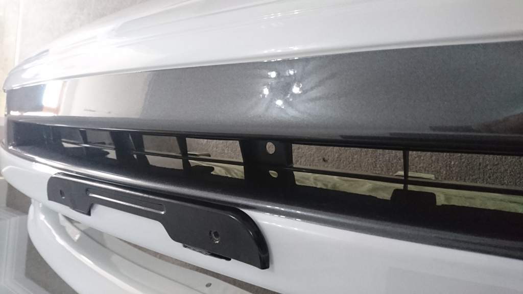

Is your moustache black Si or the stock graphite colour?
It's graphite like the mirror bases. The white screws up the contrast on the phone which is why it looks darker than it is. It's exactly the same colour as it used to be.

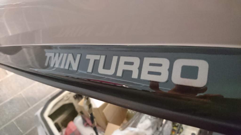

Genuine Twin Turbo badge for early models. Nice subtle colour to it rather than these chrome/bright silver reproductions. Not cheap, but they do look nicer IMO.

Could you refresh my memory of this colour code please?
I thought that would be case. Couldn't see you going black after recent returns to OEM. She's looking good mate.
1G3

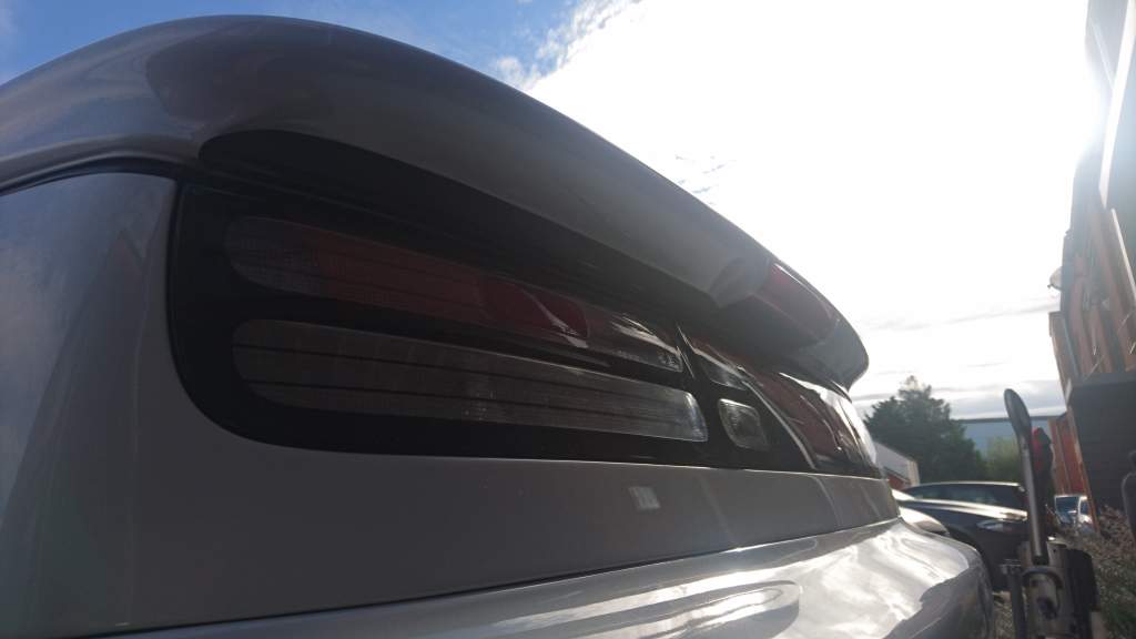

Few photos - almost finished. Just the bumper corners to secure and still waiting on this ******* windscreen!
