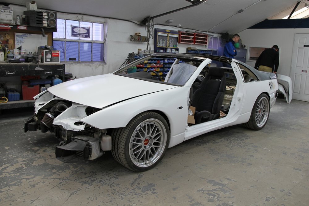

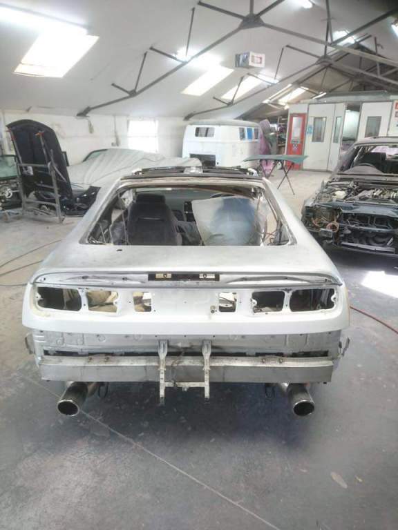

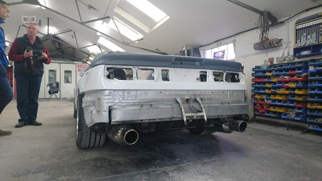

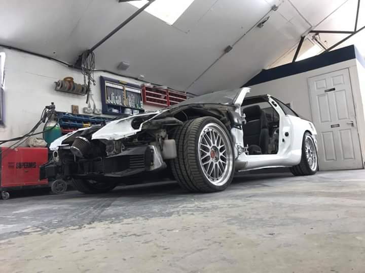

Progress is coming along. Looks rather naked here! I think the glass is coming out next week. Doors and bonnet are fully stripped and prepped and awaiting their first coat of primer. The replacement hatch has been fitted and aligned to check for shape. The glass has already been removed from this so it's fairly straight forward.
Antenna cover plate has been removed. Just some light reshaping to get the leading edge looking smooth and a proper shape.

Looks like an impressive make-over in progress.
Can't wait for the next instalment.

Progress is coming along. Looks rather naked here! I think the glass is coming out next week. Doors and bonnet are fully stripped and prepped and awaiting their first coat of primer. The replace.dnt hatch has been fitted and alighted to check for shape. The glass has already been removed from this so it's fairly straight forward.
[ATTACH=CONFIG]105570[/ATTACH]
[ATTACH=CONFIG]105571[/ATTACH]

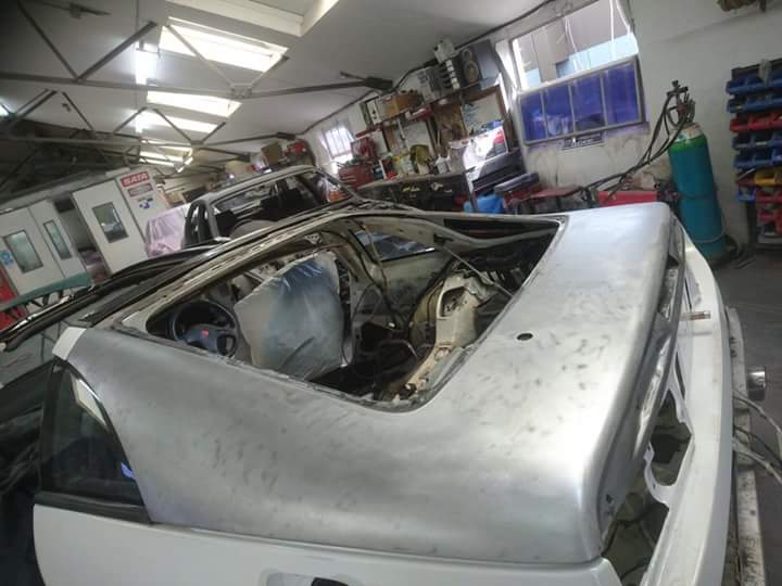

Following fitment check the replacement boot, most of the skin has been bare metalled. Just the top section and the screen facing areas to finish.

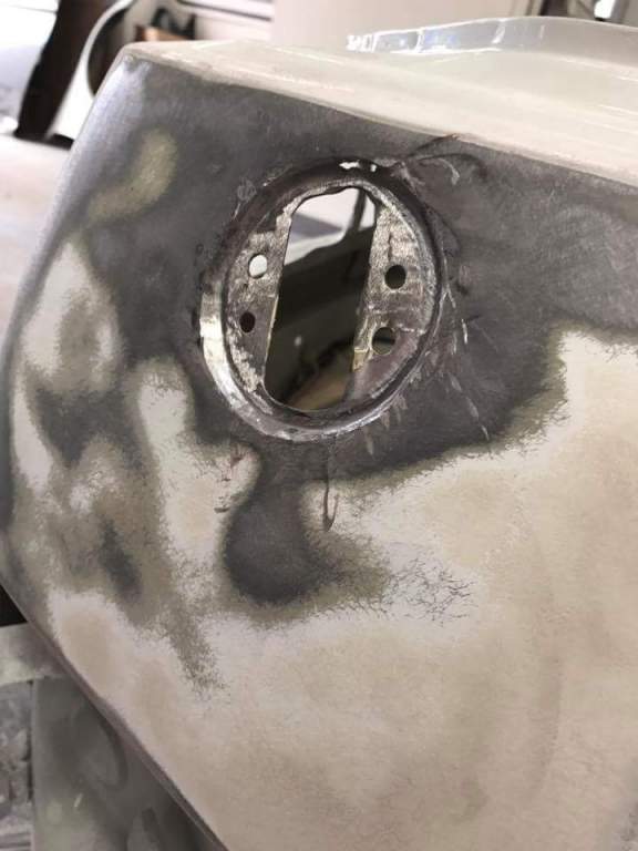

No, I won't be using those leading edge fixing points. I'll be sealing up the clip holes in the spoiler to prevent water ingress and the spoiler will be bonded on, again to seal it completely. I don't want it blistering in 10 years. :)
It will be bolted to the lower edge however where the perspex strip would have gone as the screw holes are present and correct.
I believe this to be a fairly new replacement tailgate from Nissan hence it not having any 'pre-drilled' holes and the fact that it is totally rust free - only US 2+2 models and certain 98+ Japanese models came without spoilers and associated holes. If you were to order a new one (obsolete now) from Nissan, it would have come with no holes. This part was never available as a pattern part either.
The spoiler fits like a glove so bonding will be fine. Nissan used clips and body tape as a production operation, but this is inherently why the spoilers fail.

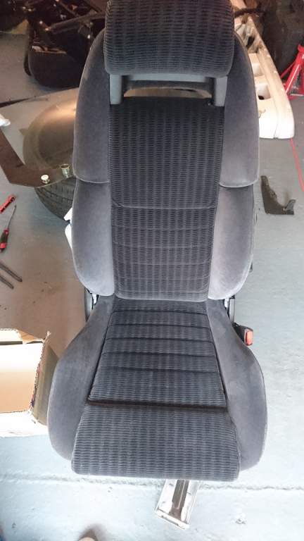

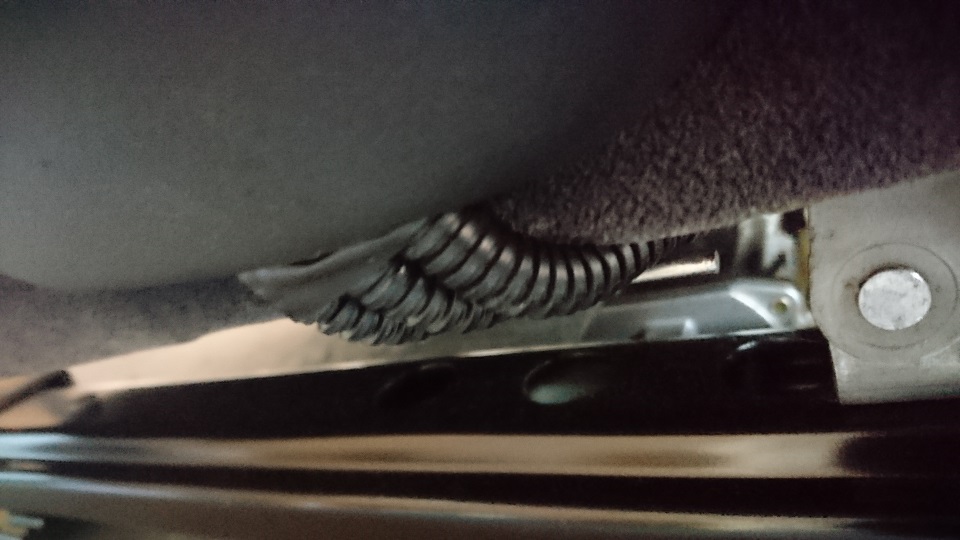

Today I thoroughly cleaned up the drivers' seat since I had the bolster rebuilt and replacement foam. It still needs a vacuum, but it is at least clean now.
Did all the plastics too. Seen many Zs with these areas looking a little grotty.
Also the rail brackets and underside. These all discolour - now look a little smarter.
Happy with this now, it's probably as good as I'll ever get it.

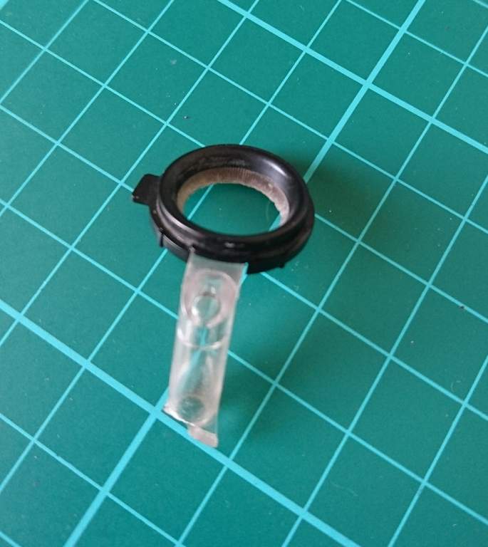

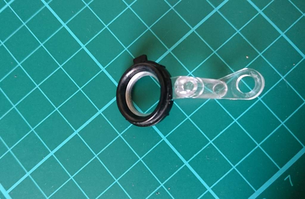

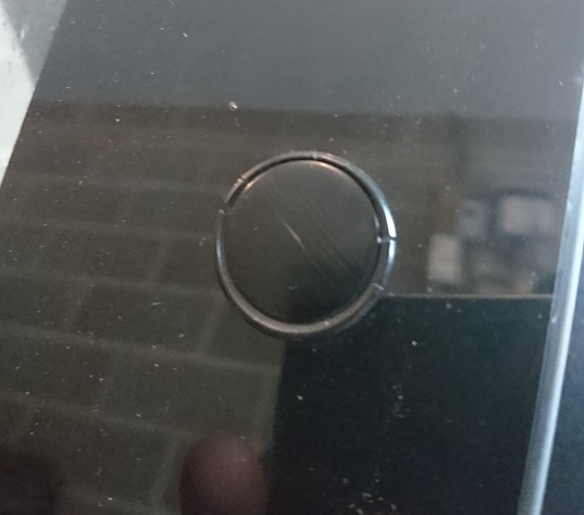

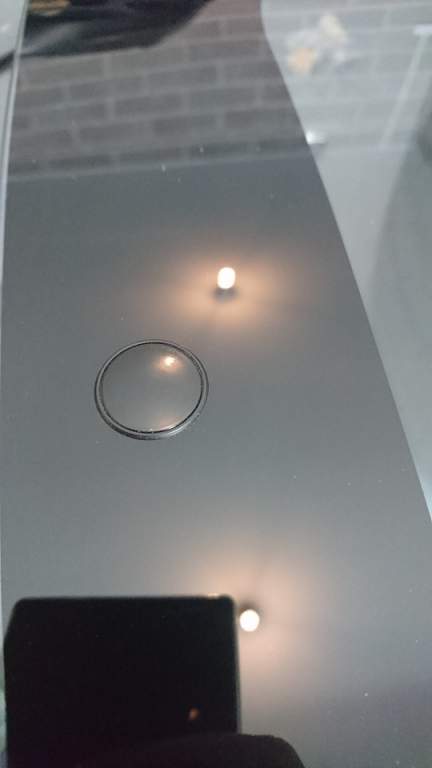

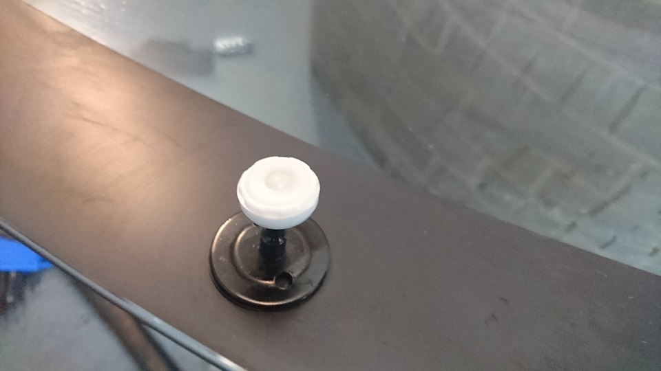

I also replaced the window rollers. I'm pretty sure I did the top ones a while ago, but since I was replacing the exterior button bolt for the top roller, I thought I might as well just do the whole lot on both sides.
The lower ones are fairly easy to do. The ball inside was lubed using a ball joint grease. These were screwed on using a small dab of thread lock

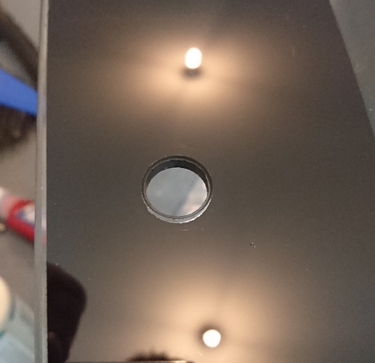

Then came the upper window slider and bolt. My glass is in very good condition, just this bolt and washer that made it look a little untidy.
Took the roller off which was easy. Then attacked the screw washer and bolt with this thing and a touch of penetrating fluid on the thread.
It did spin and I considered cutting a notch into it, but since the threads were ok, I thought if I kept working it, it would eventually loosen and come off and it did.
Little bit of dirt/scale/polish residue here.
Polished up using an awesome glass polish called Ceriglass.
Always been pleased with the condition of my glass. Hard enough finding blue glass anyway, let alone ones that have virtually no scratches on it.
New bolt and washer in - looks so much better. I love little 'detail' jobs like this.
....and eventually the roller.
I do have a question for those that have replace this bolt and washer (AndrewG maybe). There is play between the washer edges and the bolt, maybe up to 2mm. There is no way of centralising this. Did you loosen the top bolt on the runner when re-fitting so that the variation doesn't cause any damage to either the roller or worse case, break the glass.....

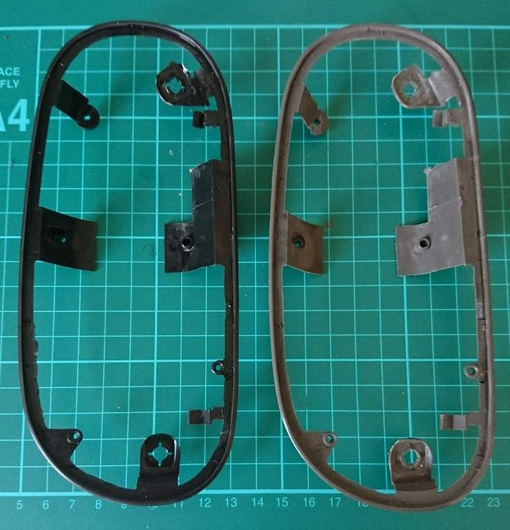

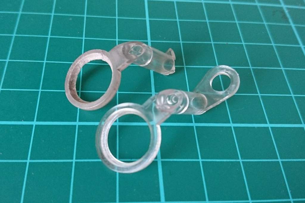

Some other detail parts today. Nothing that exciting but I got chance to pull apart a 96 car today, there wasn't much in it that I wanted however something I've been looking for, for ages, were the little lock surrounds on the door handles that fade and degrade! They also break very easily and both mine were in an appalling state.
They both look like this and despite my best efforts to rescue them, they look like shite. You can't buy them separately.
Despite the poor condition of this 96 car I was pulling apart, the door lock surrounds are near pristine!
This feeds my OCD and makes me super happy! It's often all about the detail!

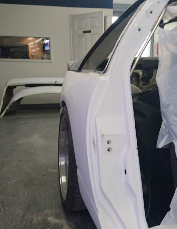

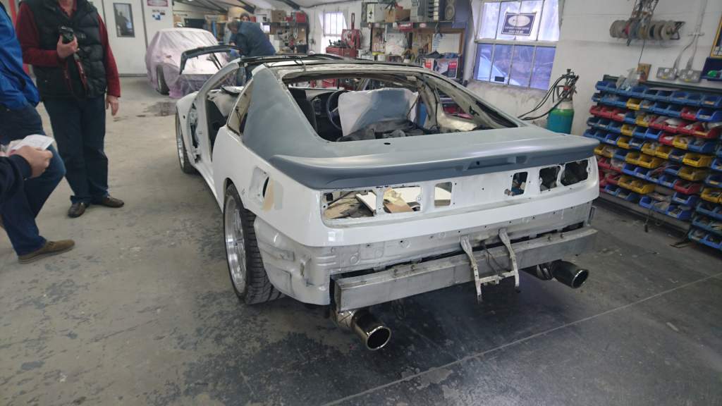

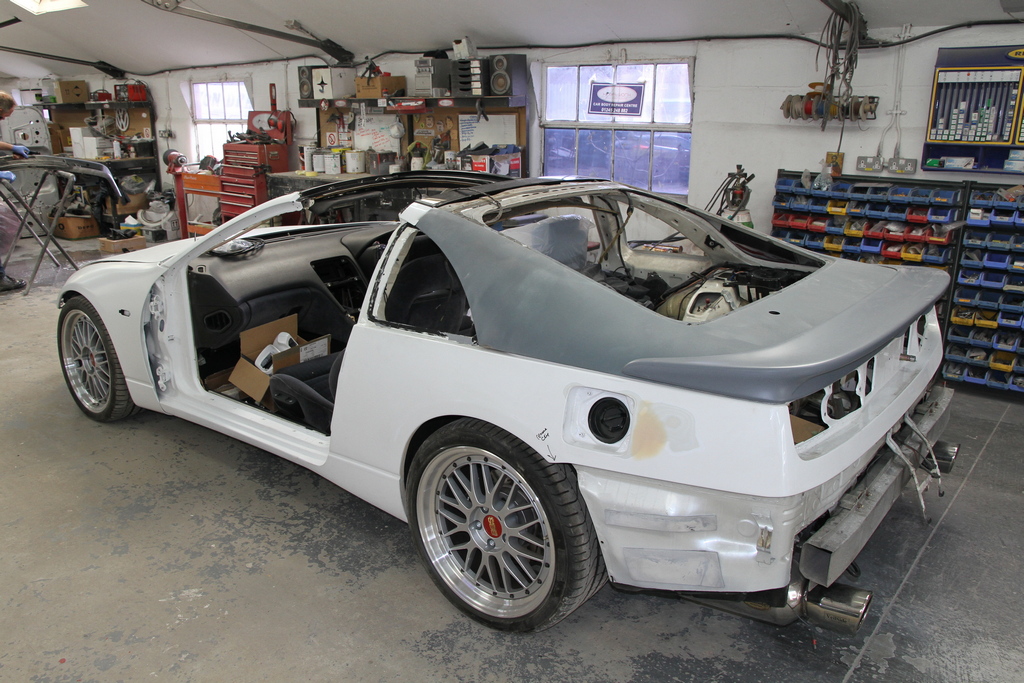

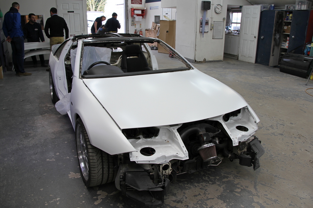

Met up with AndrewG and Joel today at the paint shop. A little slow going although the lower part of the car has a white primer on it, as does the front end. The glass was removed late last week, so final prep on the top should be going ahead shortly. Some parts will be going in for paint next week.

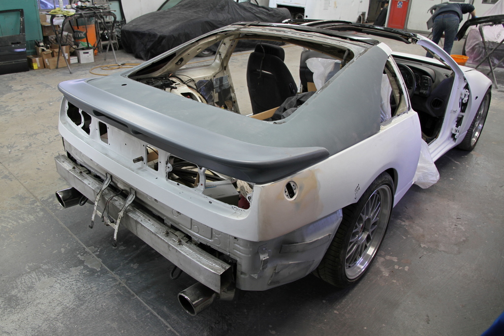

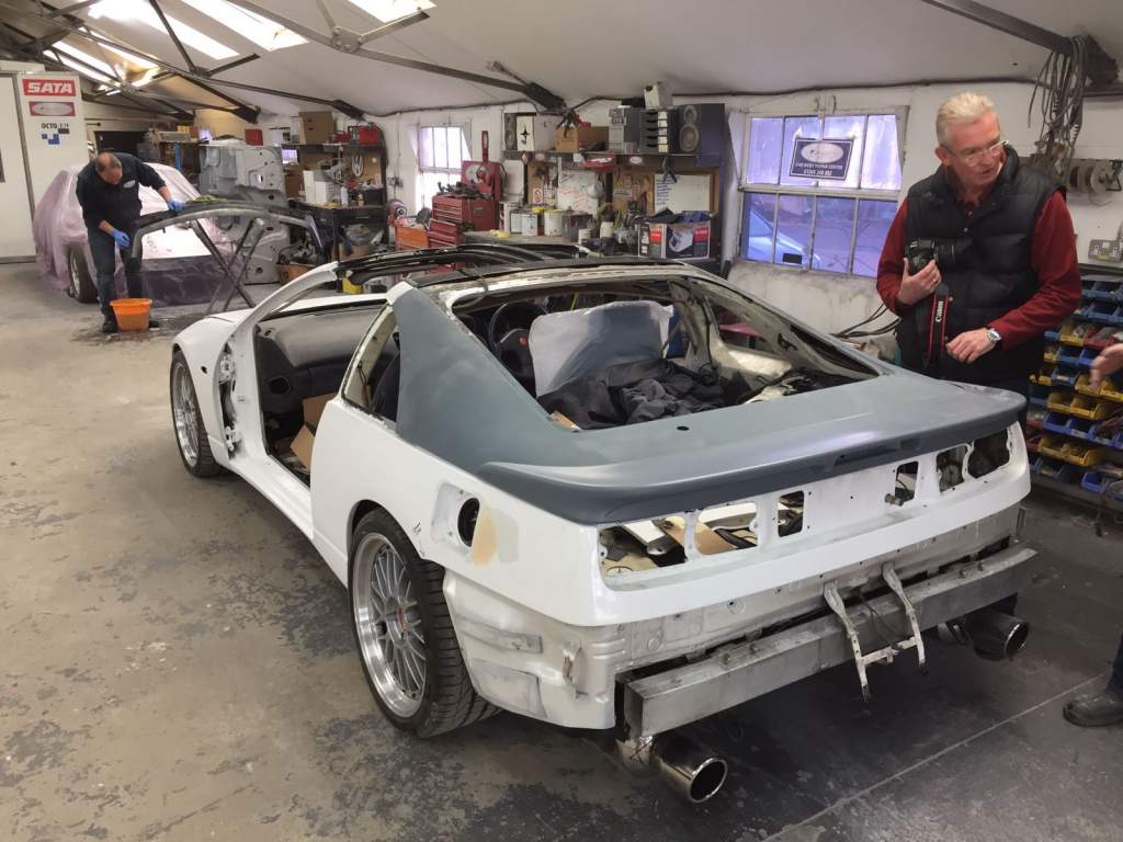

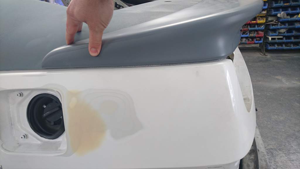

Test fitted the spoiler today, first time I've done this, just to run through with the painter a number of details and how its going to be sealed up and bonded on. Fits like a glove!
Something you never get on replicas. Well worth the money on the genuine article in my opinion.

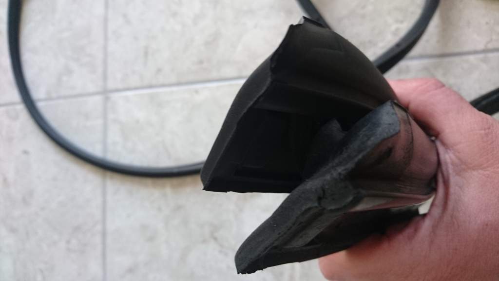

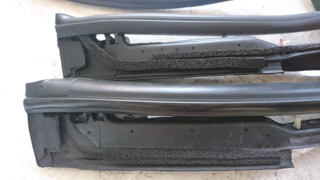

Also, one of the door rubbers turned up today. The other side is now no longer available from Japan, but Z1 had one in stock luckily and that's now on its way over
The new seal is lovely. Should fit really nicely. New one on top which looks a little 'fuller', old one slightly saggy and degraded a little.
