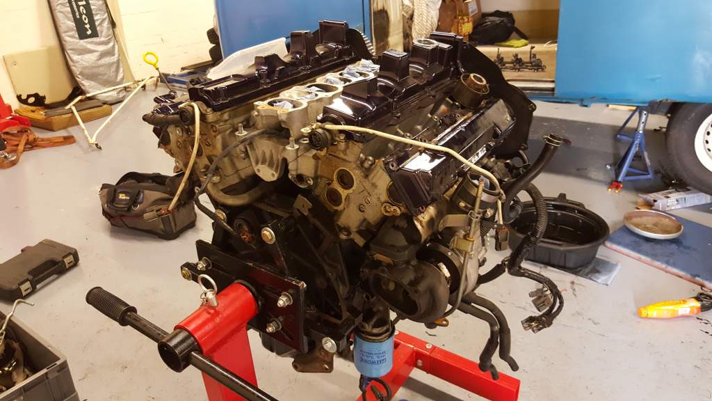

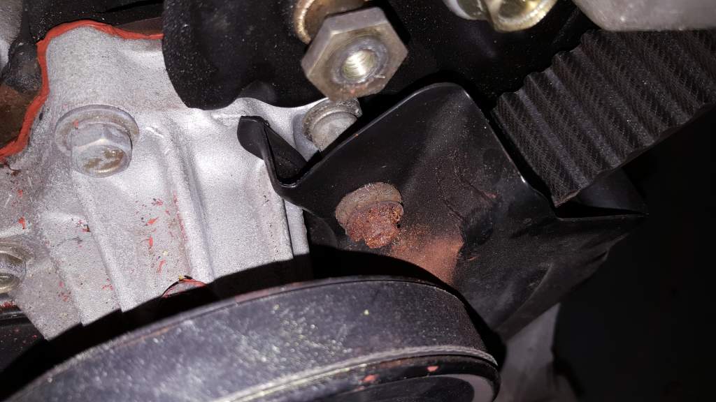

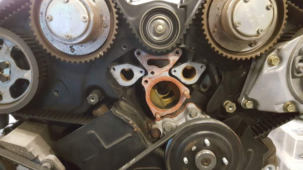

Back to my engine cleanup progress today and managed to get that snapped alan key head out.
After trying many various things it came out using a bit of sparky tape stuck to my finger :)
Managed to get the water pipes out too so I can give the whole area a clean.
Looking at the area I thing there has been a previous water leak as many of the bolts are in bad shape.
Also a rusty looking silicon has been used and I can see it on the water pump too.

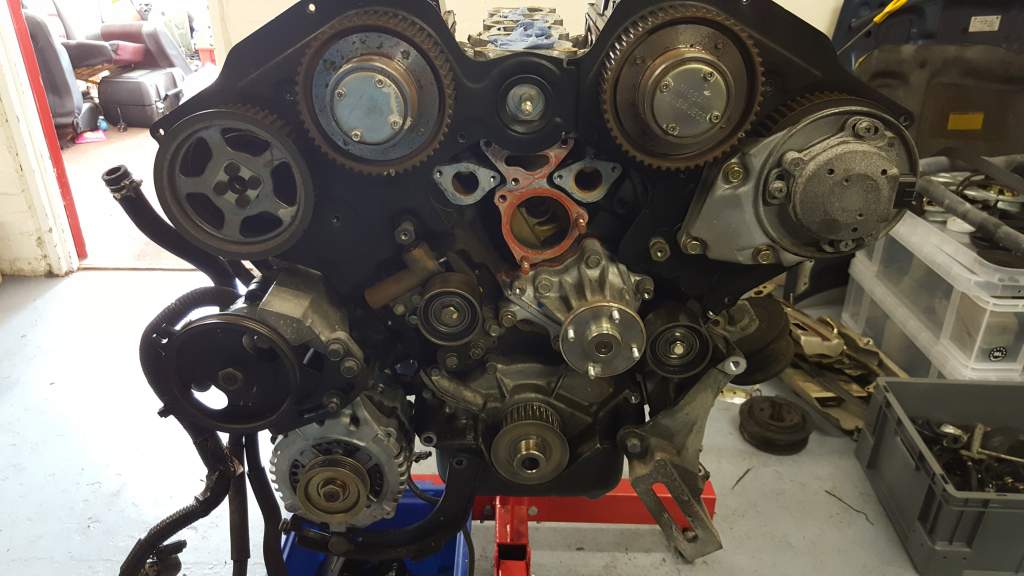

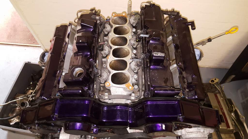

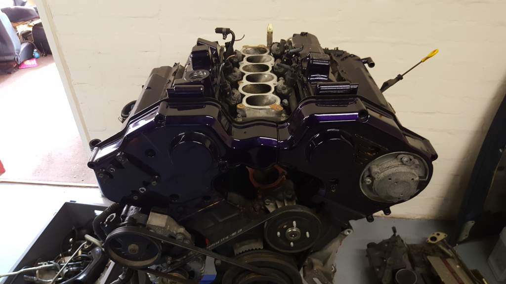

Colour scheme on this build is staying the same as the last so I stuck the purple belt and cam covers on.
Depends how they clean up I might use these or I was thinking about just stripping the cam covers that
I had on this engine in the blast cabinet then getting them redone in a fresh purple paint.
Few area on the paint i'm not happy with so these might get overhauled.

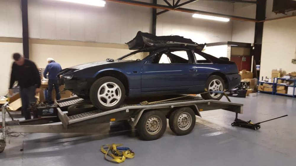

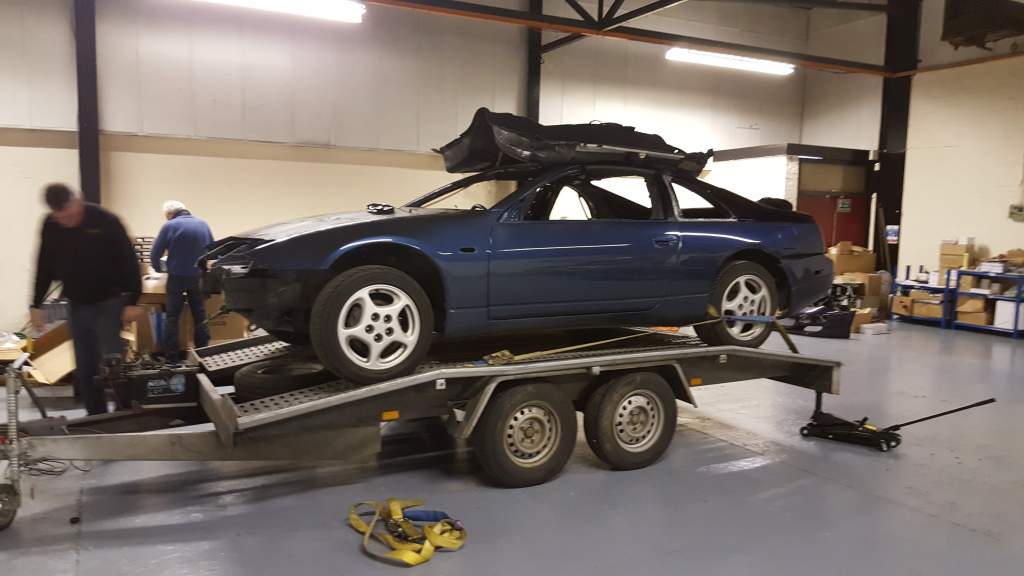

Work has started :)
[ATTACH=CONFIG]105396[/ATTACH]
Looks so naked. :thumbup:

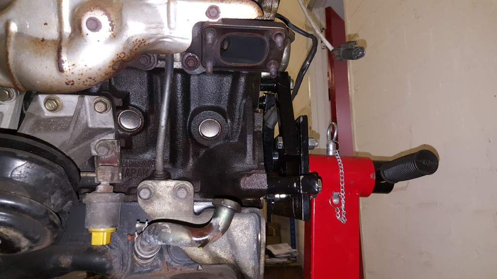

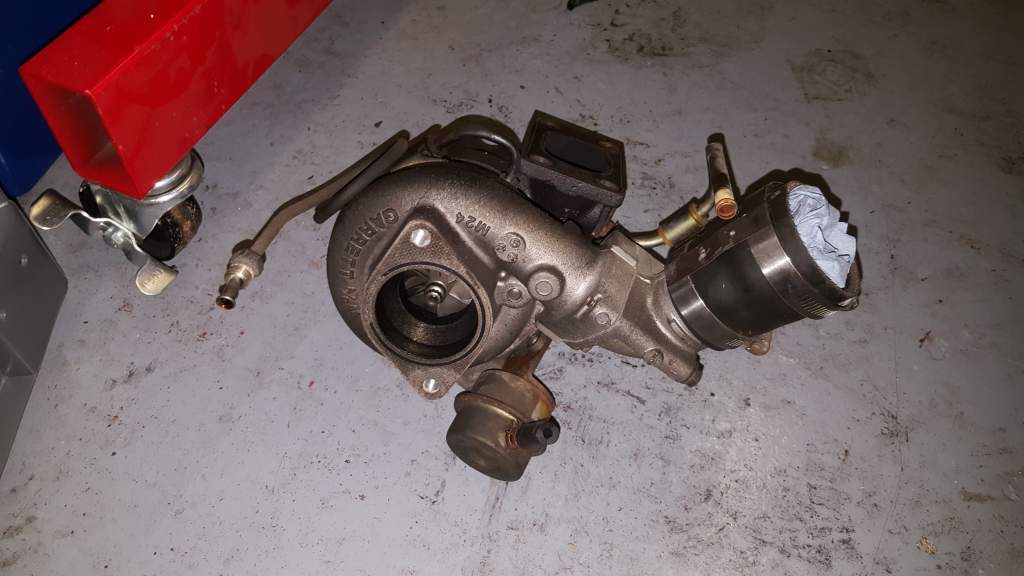

Still have a stuck turbo and its held on by one bolt, issue I have now is the spanner keeps slipping.
I may need to use some sort of cutting disc and slice the bolt open to get it off.
[ATTACH=CONFIG]105391[/ATTACH]
Which bolt is it lee?
Bit tight that one isn't it, iirc the manifold restricts room around it and the rear housing is in the rear way from below... don't think a nut splitter will get in there. I'd be inclined to heat it cherry red and then hit it with a sharp cold chisel. Frustrating.

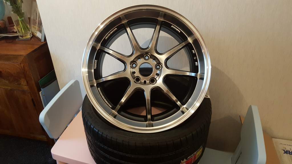

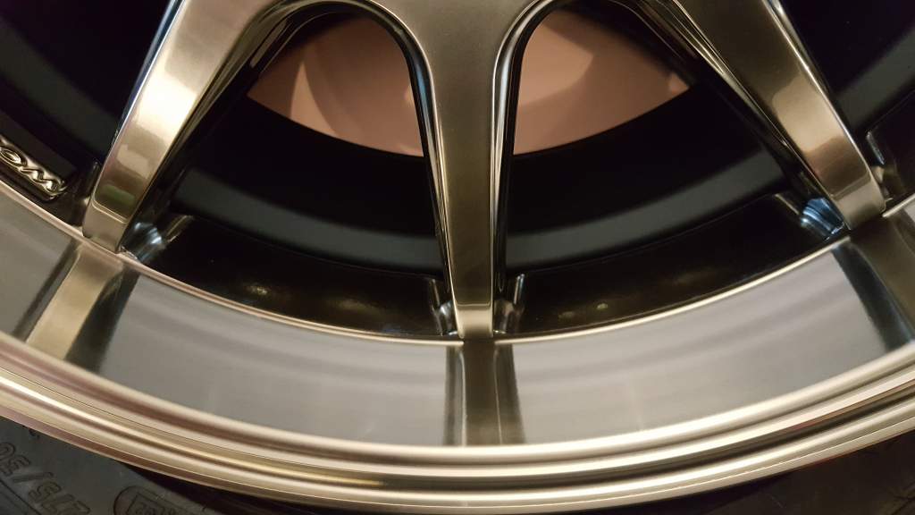

The workshop asked to bring my wheels in for a test fitting so had to get them out the loft.
They have been up there for over a year now so after getting them down I dusted off the boxes.
Couldn't help myself; got them out and took a few pics to show them off again :)
All boxes up again ready for transport in the morning.
Very nice and shiny
