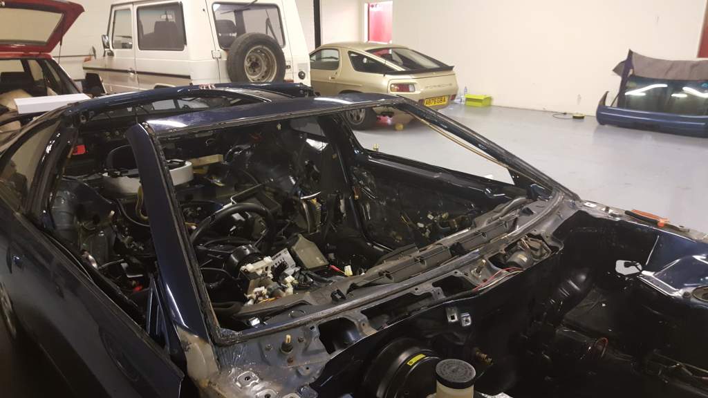

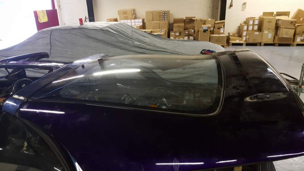

Great work, how are you planning to take the front and rear screens out, I will be doing mine at some time.
2004 BMW Z4 30i
1991 Nissan 300zx TT Project
1997 Jaguar XK8 Scraped ☹️
I have a removal kit, its basically a cheese wire with two wooden handles.
The current tailgate is not the one i'm using as I recovered the tailgate off the last zed, although the glass will be getting removed.
I also have a brand new front screen stashed up my loft which I also removed from the last zed.
Cool will look into getting some tools, I have a complete set of blue glass to install.

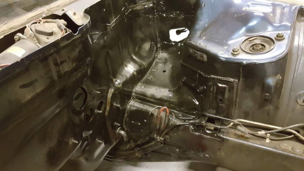

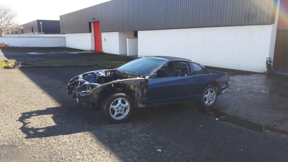

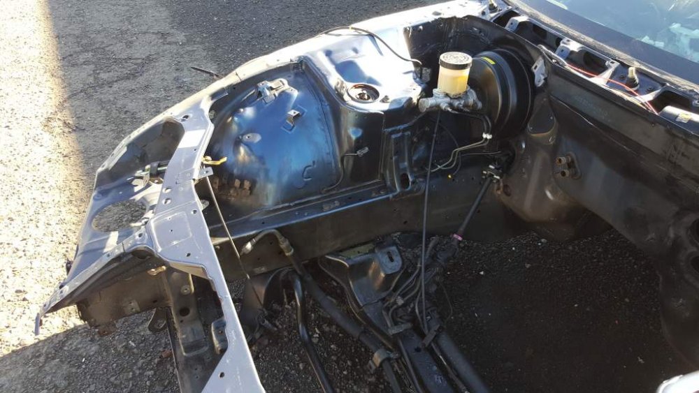

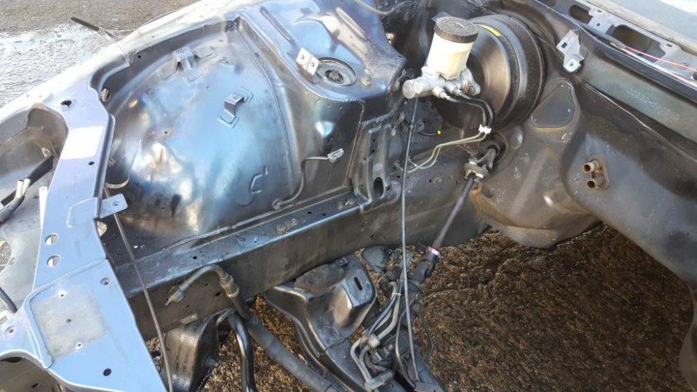

Had the zed out in the sun today, nearly, for the first time in over 6 months.
I took the jet wash to the engine bay area to clean as much oil and other crap off.
Originally planned to get it all steam cleaned but couldn't find anywhere close to hire a cleaner.
After it was done I wiped all the excess water away with a towel then let her dry in the sun for an hour.
Still slowly working on the zed and prepping it for its respray :)

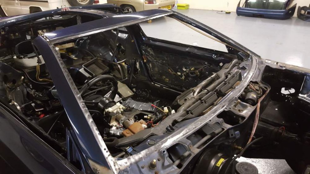

Good luck, what parts can be saved when taking front and rear glass out.
2004 BMW Z4 30i
The side outer trims can be kept if you remove them carefully but you will need new retainers which are glued in to the
sides of the metal of the left and right sides of the front windscreen.
For the back likely replace all the trims unless you can figure how to get the glass out without damaging anything.
