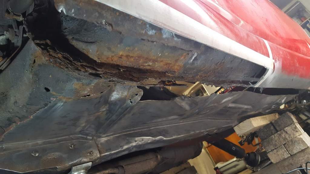

first sign is a fuel tank leak, so began the process of removing the rear tank,
looking under the rear arch behind the bumper, it has rotted through, this has been repaired before but again has rotted through,
does anyone have any pics or experience with repairing this section?
looking under the zed it looks like I will be dropping the subframe and using a product called POR 15

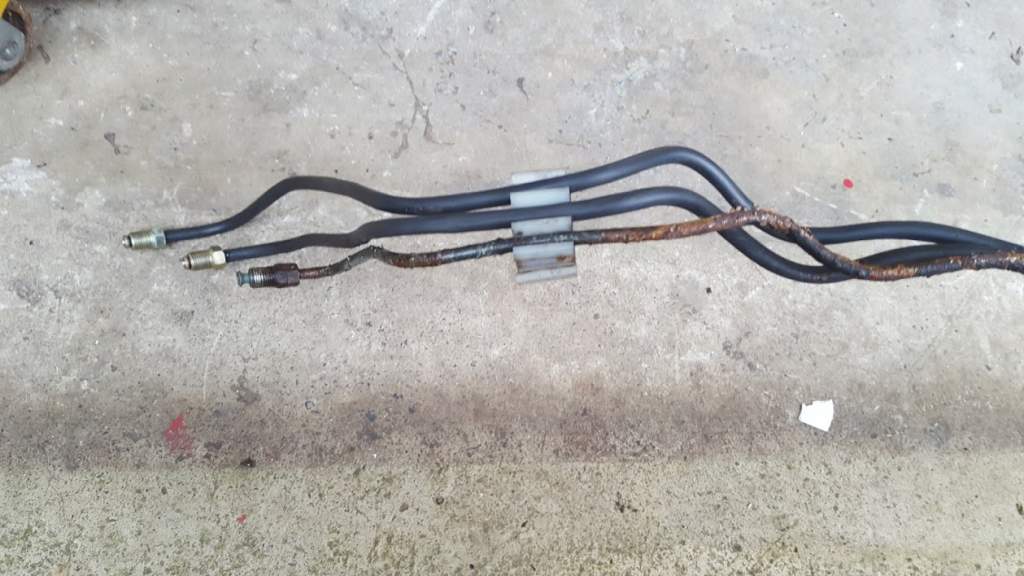

I have also been redoing the brake lines using Kunifer pipe 3/16 with 10mm fittings
I removed all the pipework and I have been able to make a copy as I go along, and I have also covered sections in heatshrink for that factory look
here you can see the new next to the old

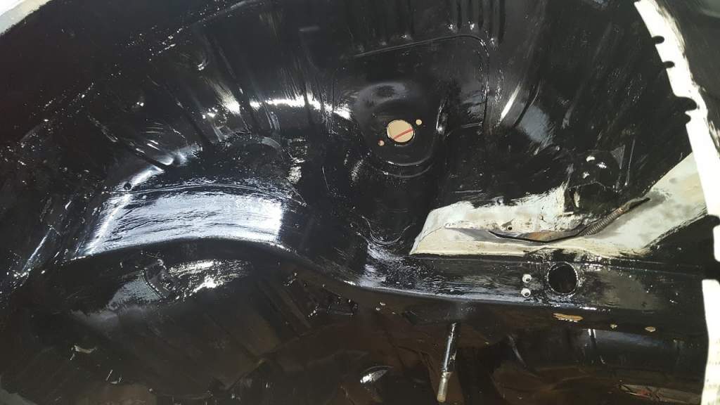

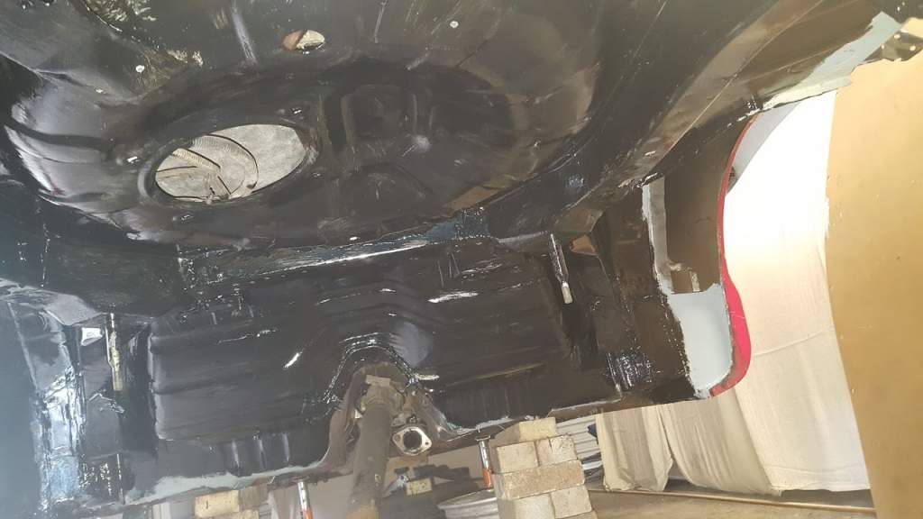

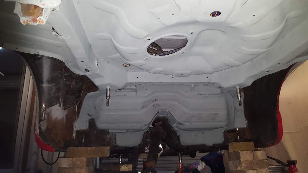

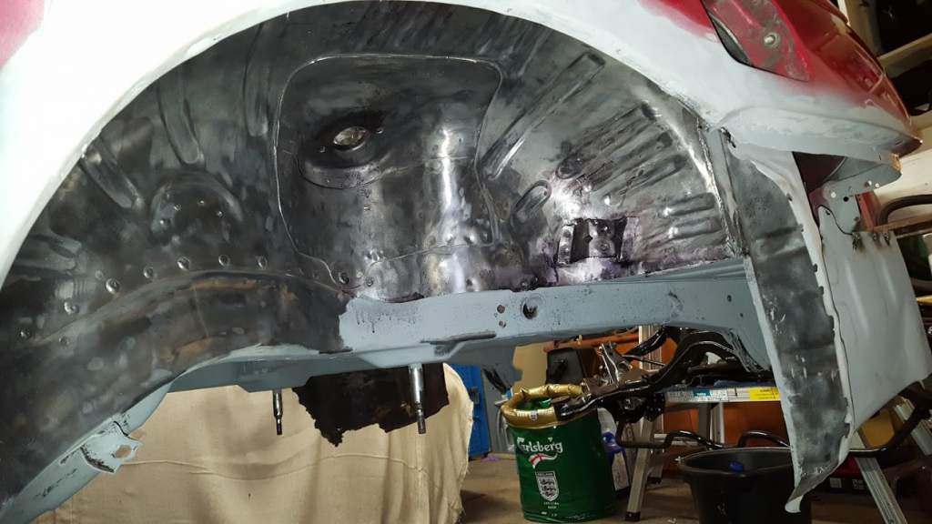

Had a chance to do a little more, so after battling with the underseal, best way i found was with an oscillating
Multi tool scraper and then a wire wheel on a grinder.
Once down to the bare steel any rust was dealt with using dinitrol rc900
Then i used bilt hamber electrox zinc primer thinned down using there xylene thinner and applied
Using a brush
Next i will use bilt hamber epoxy mastic & dynax s50 inside the sills and box sections ect,
Lots more to do but just a quick pic to show progress
Thanks guys

I managed to clean up the passenger side arch today, all rust spots again treated with dinitrol rc 900, then I will do the zinc primer then epoxy mastic

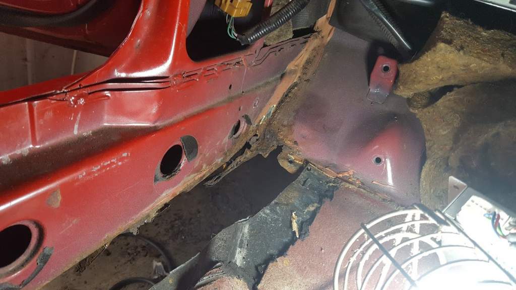

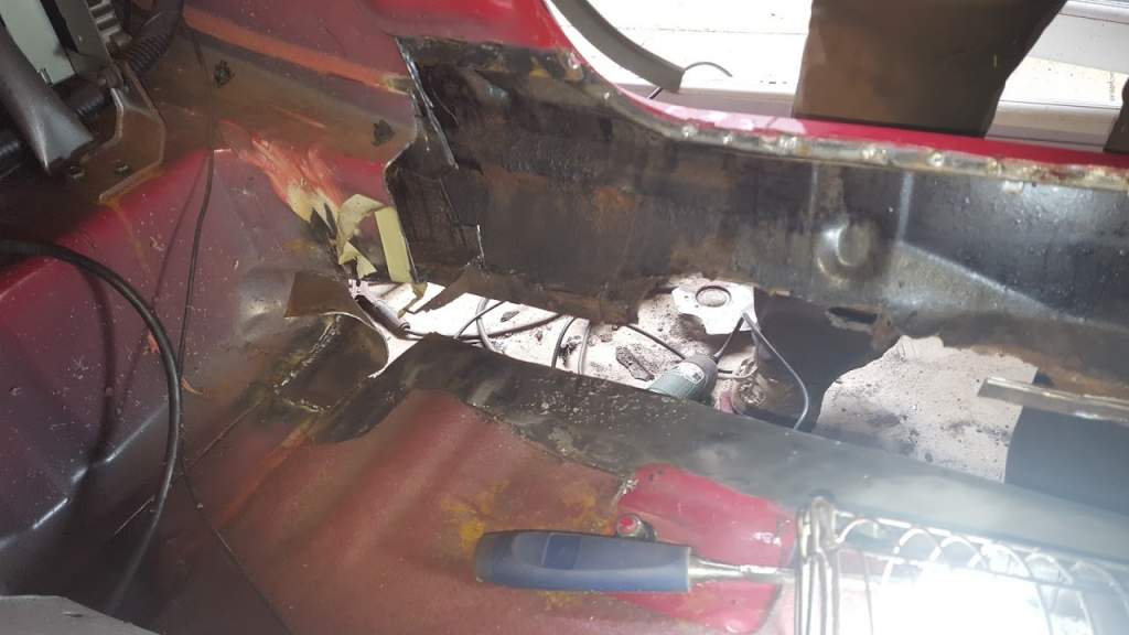

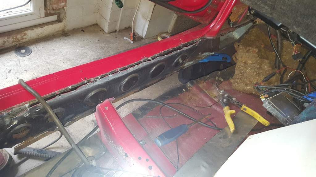

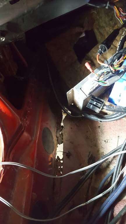

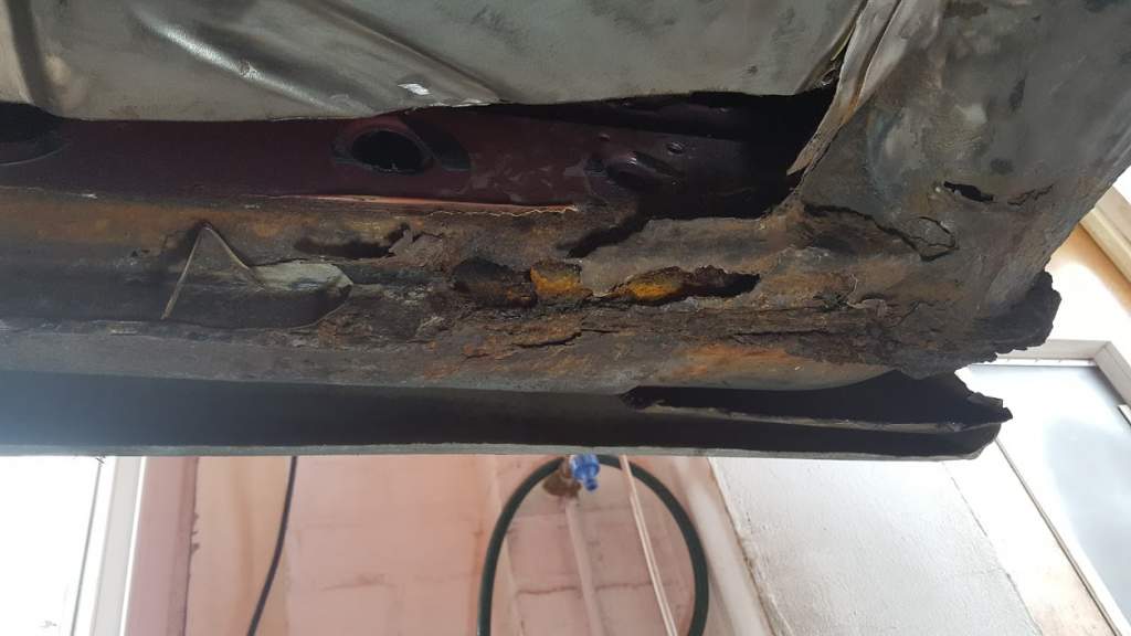

More update, I have had a look at my sills and the floor section is rotting away from the side sills,
so I am going to have to strip everything out, cut sections out of the floor and weld in new steel, Sills don't look to bad but there are sections to repair
biggest problem I have is the side skirts from zcentre and I have blended them into the body work, so the only way I have of getting to the sill is to cut a section out of the fiberglass side skirt as low down as possible
Edited by FASTREDZ
Keep at it mate your getting there. That floor pan shot makes me want to pull the carpet up.

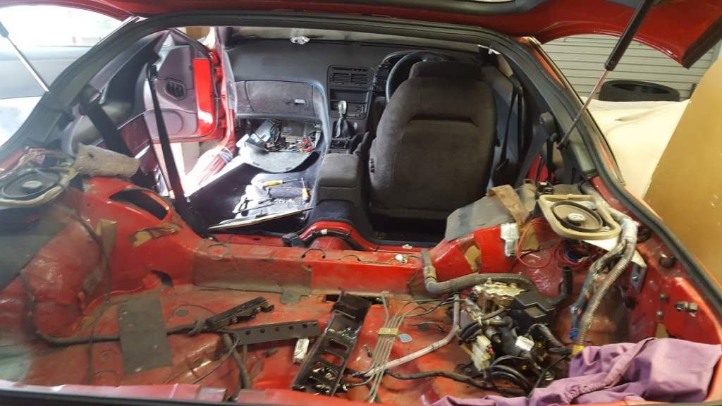

P.s. unsure of what rear arch welding you have left but be wary.. welding too high in the arch behind the rear passenger seat I encountered some kind of felt padding by the wire loom. I say encountered. I mean took my welding mask off after a nice job and looked inside to see it on fire
Almost thought it was my car there looking at the pics! In exactly the same situation. Pipes done but onto all the welding now, front sills/floors too. Keep it up!
I,ve had some pretty big flames come out of the inner arch box section :) I know where you are with the loom and padding its quite a job checking whats going to catch fire next and keeping an eye on things,

Im using billit hamber dynax seam on all the seams including any welds runs, weld through etch primer on any seams, painting everything in billt hamber zinc primer and then bilt hamber epoxy mastic on top finished with bilt hamber s50 cavity wax on all the cavitys, I hope this time it will not rust again,
very interesting to see that wherever I had previous weld runs this is where the rust has attacked the worse.

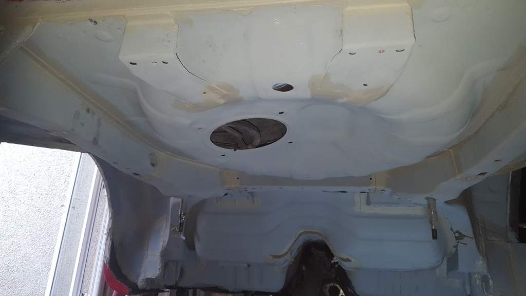

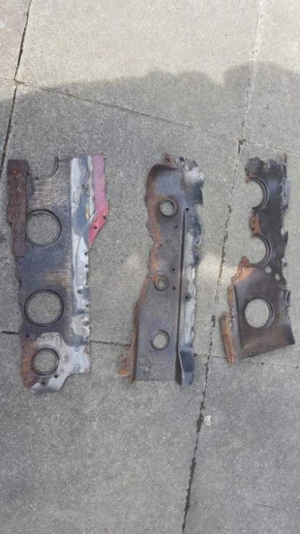

So continuing on with my inner sills,
I found the best way to tackle this job was to work from the inside out, I have the fiberglass skirts on the outside blended in so I don't want to disturb them
so I cut the rusted section out of the floor, then unstitched the inner sill and the middle sill to gain access to the outer sill
I have made new panels using galvanised steel
then I got to do some of the underside using the bilt hamber epoxy primer...nice stuff
