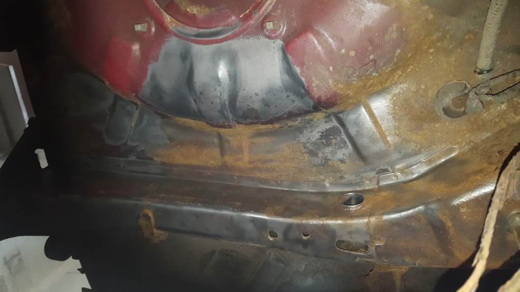

first sign is a fuel tank leak, so began the process of removing the rear tank,
looking under the rear arch behind the bumper, it has rotted through, this has been repaired before but again has rotted through,

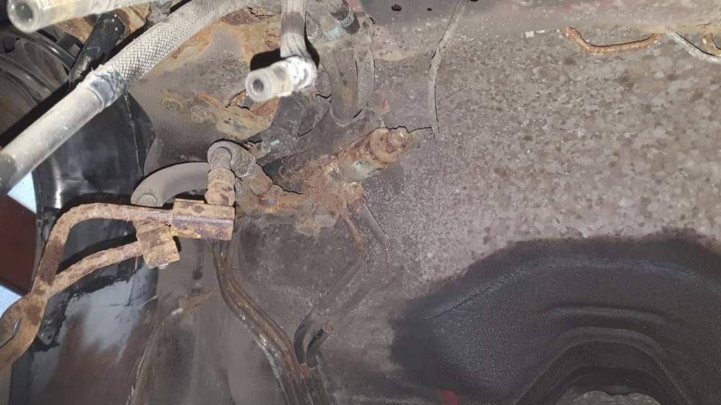

any help would be greatly appreciated regarding dropping the rear subframe, and redoing the brake pipes, do these need to be done as
a complete section front to back, or do you join them somewhere, ive tried the search function but I need a little more help with the brake pipes
and hicas pipes that seem to have rotted

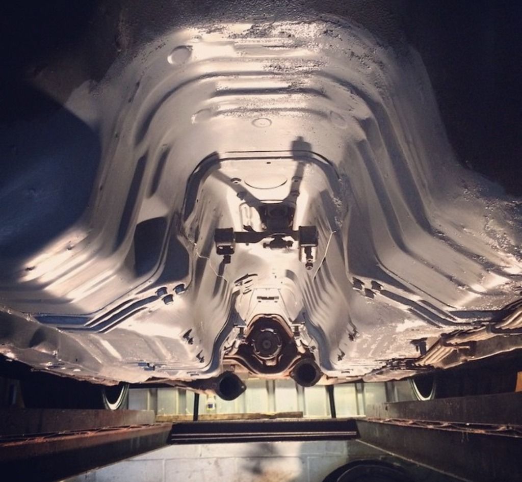

When I worked in a body shop we use to use heat an a scrapper to remove underseal before welding
Wow that's really impressive work, how did you manage to strip all the underseal, im looking to do mine too, did you strip it too bear metal?
im thinking of using bilt hamber epoxy mastic.
http://www.bilthamber.com/epoxy-mastic
I used a still wire wheel on an angle grinder to get off the old underseal. I took probably 50% back to bare metal where I found surface rust had crept under the old underseal and caused a bit of surface rust. Everything I took back to bare metal I treated with an acid etch primer, everything else where I took it back to the original factory etch primer, then sprayed on a couple of coats of Zinc 182 paint for a bit more protection.
For underseal I used U-Pol Gravitex, purely on recommendation from friends and people who I know that work in classic restorations. You can also paint ontop of it if you so desire to give it a REALLY clean look.
**stiff wire wheel**

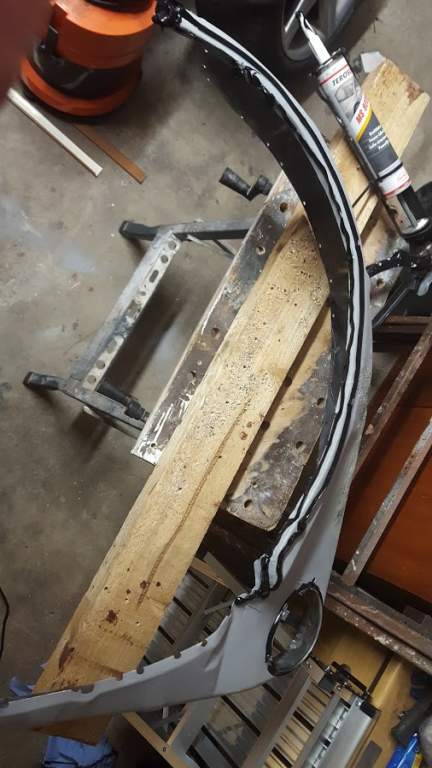

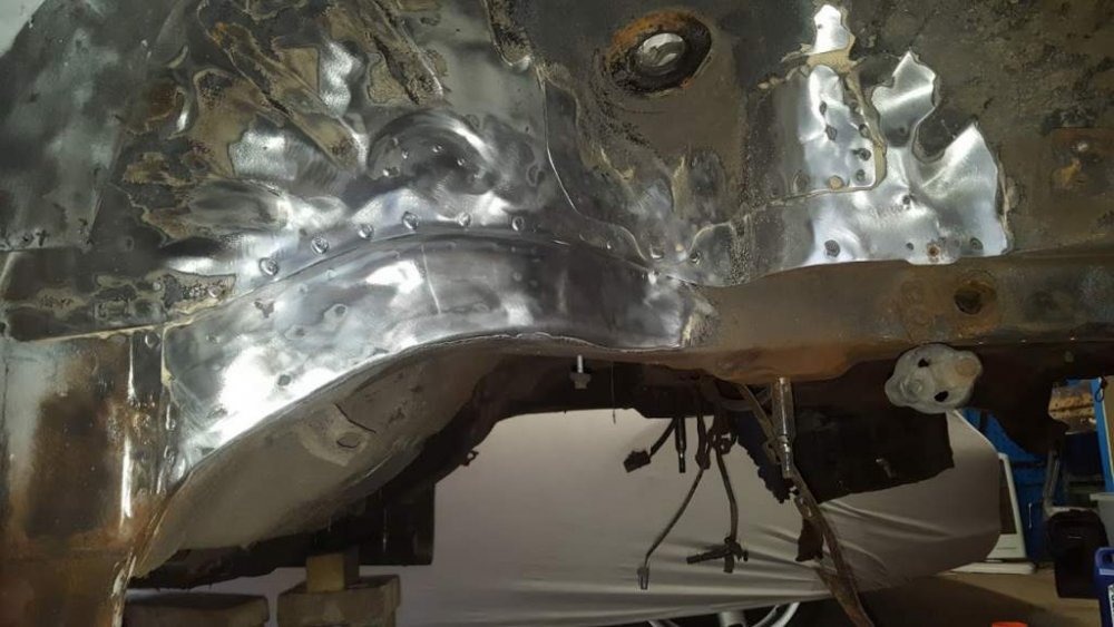

Quick update on the work so far :)
ready to be bonded in
bonded in and set

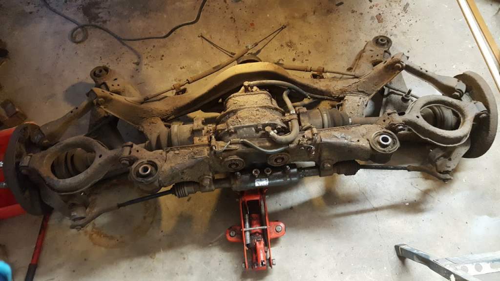

so ive decided to drop the subfame also

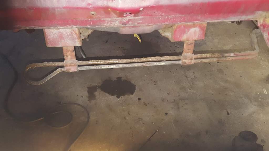

underneath you can see the hicas solenoid and pipework that is rotted hopefully someone has a spare one for me to replace mine
rear diff cooler pipework

it all started out from a bubbling wheel arch and very soon turned into me cutting out every piece of bad rusted steel I could see

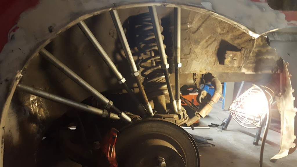

I took measurements of the rear arch so im kind of crossing fingers it will ft ok, ive only replaced the inner arch
And the box section at the rear of the arch section under the rear bumper,
I still need some bodywork before refitting the rear bumper.
ahh ok fingers crossed it fits fine chap,any reason you cut the arch at the swage line ?,i know its easier to remove less metal but forming an arch line will be harder in filler.Keep the updates coming i hate seeing zeds broken for rust if they are saveable :yes:
I cut about 15mm from the swage line allowing a bit of an overlap, ive bonded the repair arch back in place and will also
Be welding it too so hopefully no rust will return.
Shockingly all the rust i found was actualy rusting from the inside out.

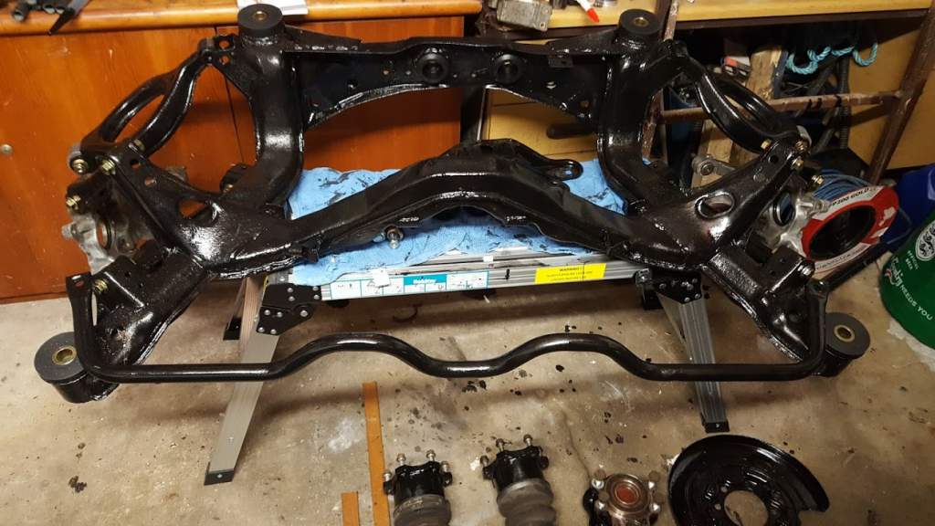

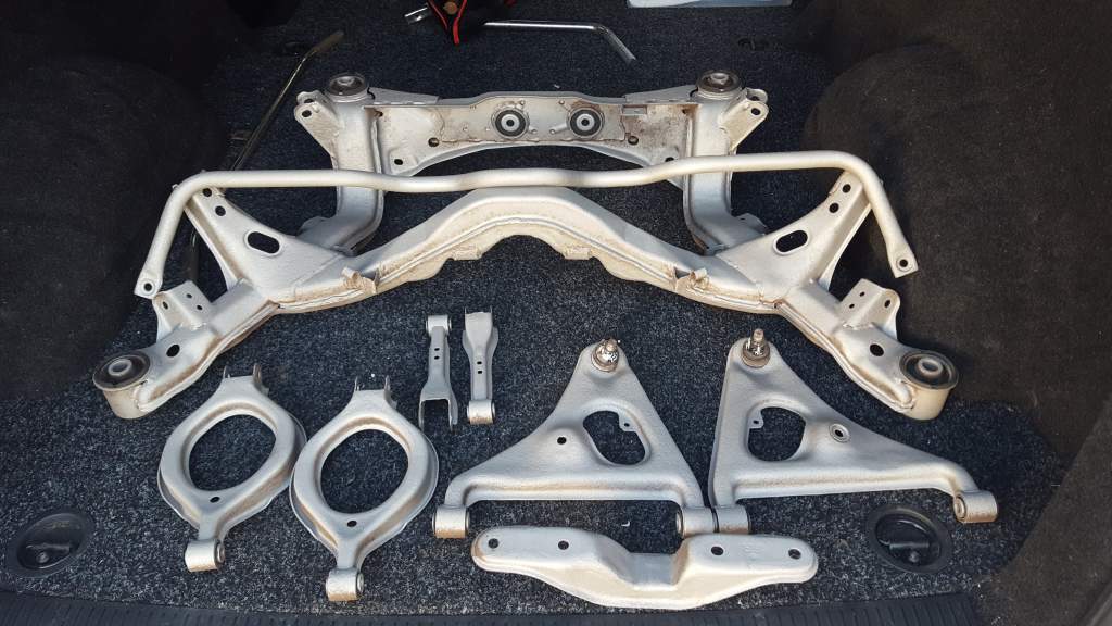

So after dropping the subframe i have stripped it and had it blasted ready to be coated with por 15
I managed to get a set of rear hubs from banzai breakers that were already poly bushed so thumbs up

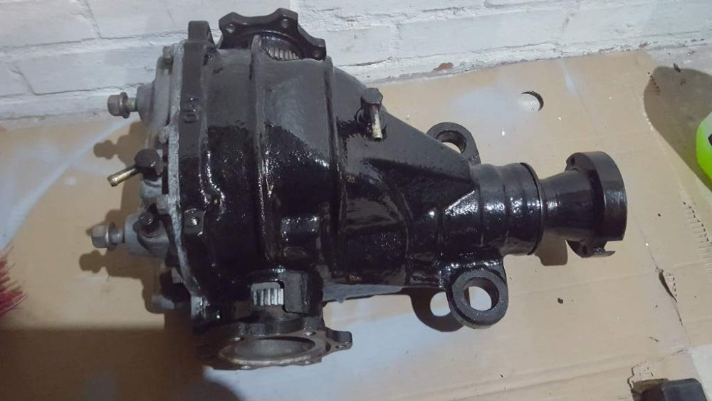

Diff also cleaned up and coated with por 15
Since my subframe is out of the way could anyone help who has replaced all there solid brake lines
Front to rear all mine are corroded so im looking to replace them all in kunifer 3/16
[ATTACH=CONFIG]104035[/ATTACH]

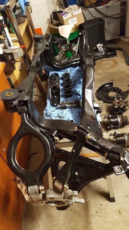

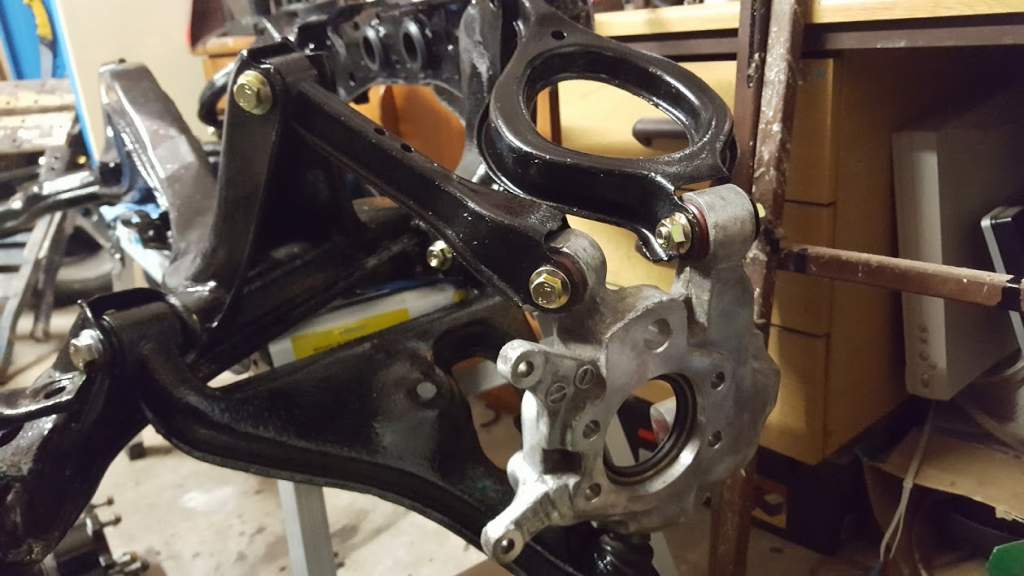

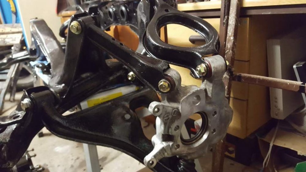

Ok so I have done a little more work on the subframe :)
The paint I used on the subframe was POR 15 and this stuff so far looks really good stuff, dries rock hard, after the frame was sand blasted, I used
metal prep as per por 15 instructions, then paint on the por 15 gloss black 2 coats, if any of it will get any uv rays you will need to top coat it with something like chassis coat por 15, I used that on my rear arms as I think that might get a little sun
the subframe bushes were a challenge for anyone thinking of doing them, there is a shell in there that needs removing but the outer shell needs to stay in.

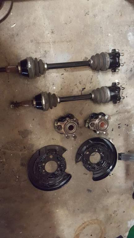

also painted my driveshafts, hubs and rear disk dust guards, I also opted for new zink plated bolts for the subframe seeing as its going well,
[ATTACH=CONFIG]104213[/ATTACH]
[ATTACH=CONFIG]104214[/ATTACH]
[ATTACH=CONFIG]104215[/ATTACH]
[ATTACH=CONFIG]104216[/ATTACH]

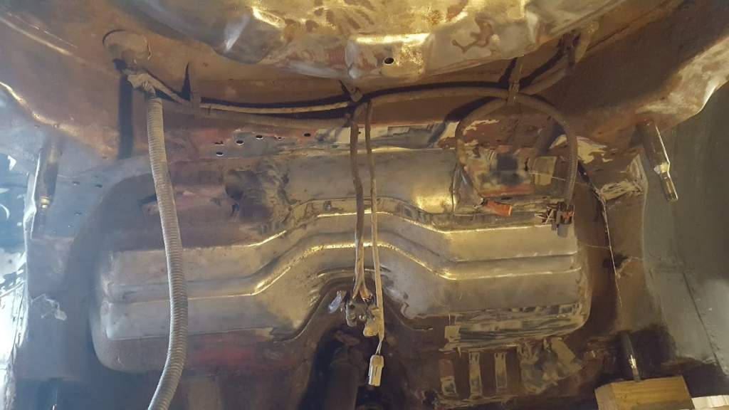

So I have been doing some more work on the zed, I have been attempting to remove all the underseal, wish I hadn't started now what a nightmare to remove,
trying with a heat gun and scraper and then a wire wheel and grinder,
