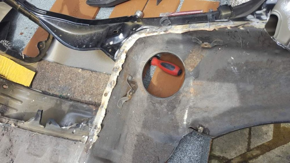

Big thanks to Bazz for the donor rear section :) this is the progress so far, a bit daunting but nothing ventured ....
this is the donor section
Cut the inner arch section off to reveal the outer half of the inner arch section
clean where the spot welds are so I know where to drill them out with a spot face drill
clean the inner arch section to reveal more spot welds
So the idea is to completely replace the rear arch section as you can see, yes it wont go in as intended during production as I cant get to the inner spot welds so a seam weld will have to do, but as my inner arch has rusted to nothing I thought this was the best way forward,
I really would like to use a panel bond adhesive to put the section back in as it will not rust in the seams again, the struggle is to remove the inner arch lip from the outer arch lip, this is the lip that goes around the wheel, I don't want to damage the outer section at all so what the best way to separate these?
anyone here work in a body shop?
Onto the outer arch section, after redwine300 inspirational post ive decided to do a similar thing...Gulp here goes
