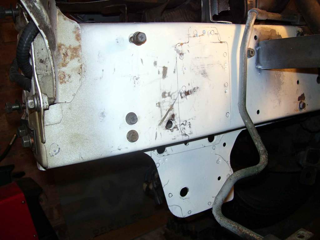

So, today I started the dismantling of the front end, and within a couple of hours I had removed the front bumper etc'
This was done on the driveway, and I hope to complete the rest of the work in the garage, hopefully.
I have reached the point where I am unfamiliar with most of the critical items that now stand in my way, and would seriously appreciate some advice as to how I should proceed.
First question/concern that springs to mind is... Can I continue successfully with the car being in the garage?
The last thing I want to do is get half way through the strip down only to find that I do not have the correct access.
The car is drivable at the moment, but once I start taking various parts off she will become immobile.
Your help and advise would be very much appreciated.
Please see photo's attached...

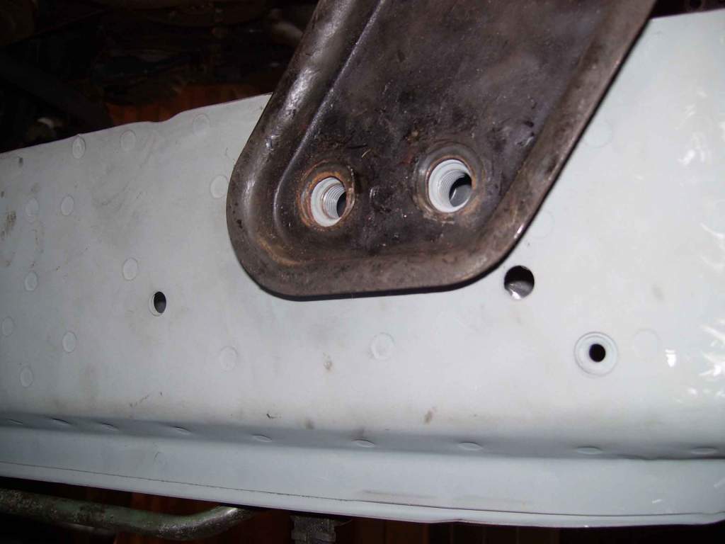

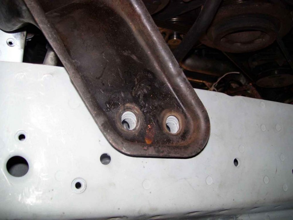

This or these will really help your situation in getting tensioned holes to line up...Podger bars,i use them all the time:yes:
Thanks Lymon.
Hopefully I will get time to bolt up the bracket to the crossmember and chassis rail without it being attached to the suspension arm today.
As you say, if I understand correctly, the issue will be move the suspension into the correct position so as to engage the 2 connecting bolts.
I guess it is my lack of my understanding that is the main issue.

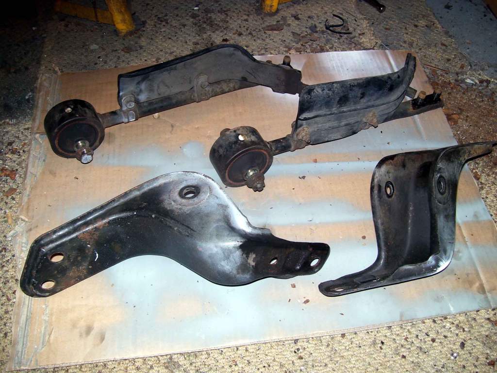

yes but if you used tein arms like mine not the cheap crap ones, you can then set the caster just right after you have done all this, and the problem will be gone good luck with this what ever you do :thumbup1:

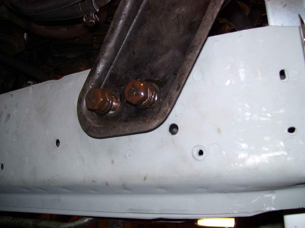

Well after a couple of hours wrestling with the bolts connecting the brackets to the tensioner rods, they are finally apart!
Now I can offer up the brackets independent of the rods and hopefully there will be no mismatch.
Watch this space.
Before you do up the bolts (arrowed) put a jack under each hub and lift up to the point that the suspension is just lifting the car.
That way you will not put the bush in tension (pre load) when the suspension compresses under normal load and the bush wants to
twist but can't as it has been tightened up with the suspension dropped.

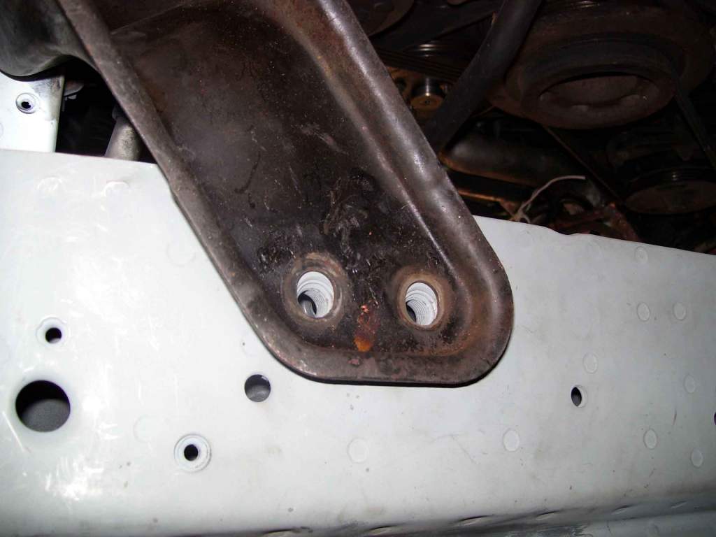

Eureka!
I have now managed to loosely fit the left and right hand tensioner brackets to the crossmember and chassis rail.
Looks like I may have to position the crossmember a little better just to get both side as good as each other, but nothing serious.
Can't thank you guys enough for the advice so far, (please keep posting) particularly Lymon and Slick Pete. :thumbup1:

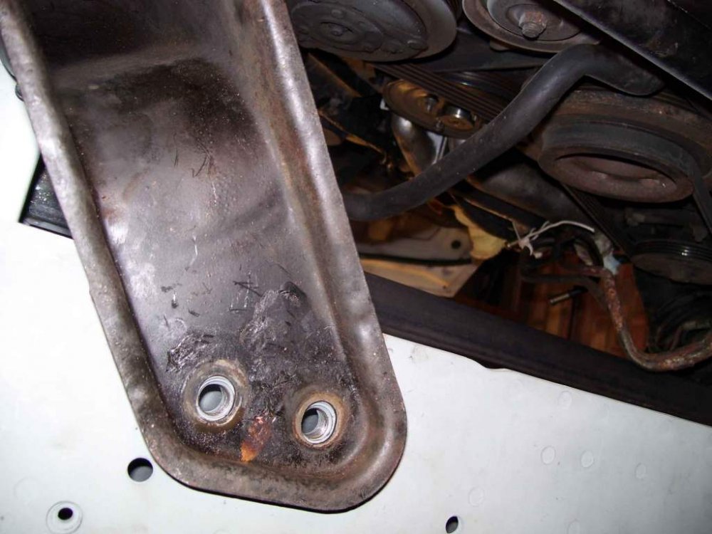

Well after a bit of fiddling, I managed to get the second side to line up as well as the first side.
Not a lot of progress I know, just needed to feel happier about the alignment.

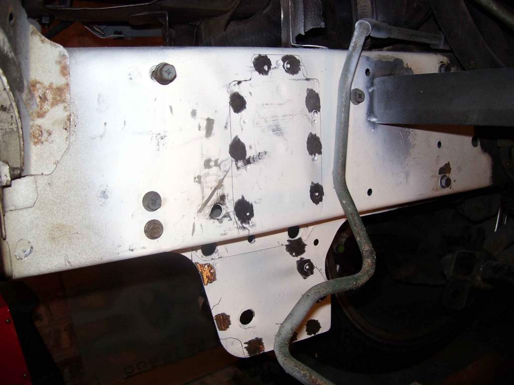

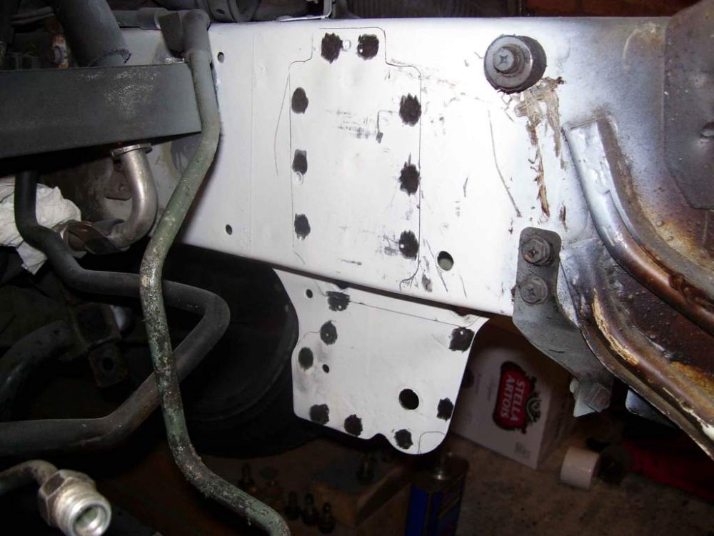

That said though, I have been prepping all of the spot welds by way of grinding back to bare metal in readiness to fire up the mig.

Not a lot to write home about I'm afraid, just some spot weld preparation whilst I await news from the Vendor.

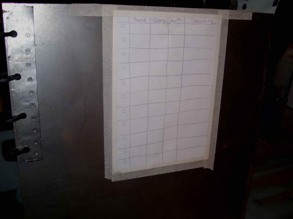

Don't get too excited, but I will be welding tomorrow.
Only my set-up piece mind, just want to be deadly sure of my setting before I make a start in earnest.
Be patient guys, it'll be worth the wait I promise.
