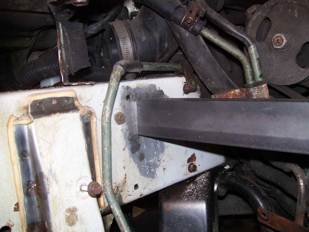

Just a quick update, nothing much mind.

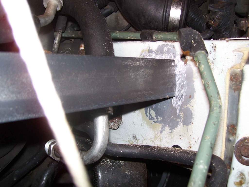

Prepared the joints for welding and positioned the support brace, I will tack it in to place tomorrow morning.
Didn't want to be worrying about burning the garage down during the night.
Errrrmmmm, just my tuppence worth mate but I wouldn't weld that there.
Those legs won't move with the front subframe still in place,I personally would drill that angle iron and bolt across the front of the legs.
:ninja:
I agree with you Mantav8, but I am going to have to compromise I'm afraid.
Two reasons really,
1. I will have better access when welding, and 2. more importantly, I think it is a matter of bolting the stable door after the horse has bolted.

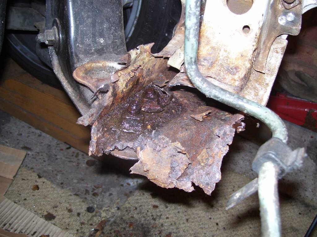

Looking at the existing crossmember, it looks as though it has collapsed inwards already due to its weakened structure.
If the crossmember has collapsed inwards how will you correctly fit the wider replacement if you have welded in the support bar?
Fair question Andrew,
I figure that welding in the support bar is just for damage limitation really, it may move even more, I just don't know.
Once the old piece is out, I will offer up the new one up and see just how much it has moved.
From there I guess I will have to spread the chassis rails somehow after first removing the support.

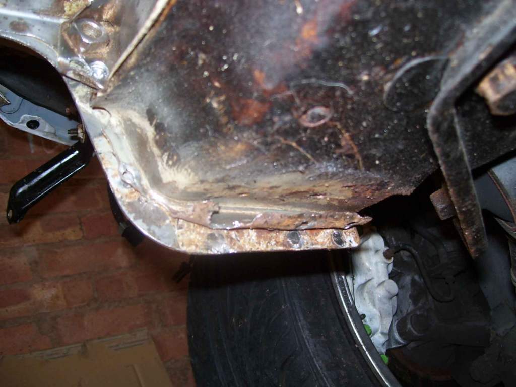

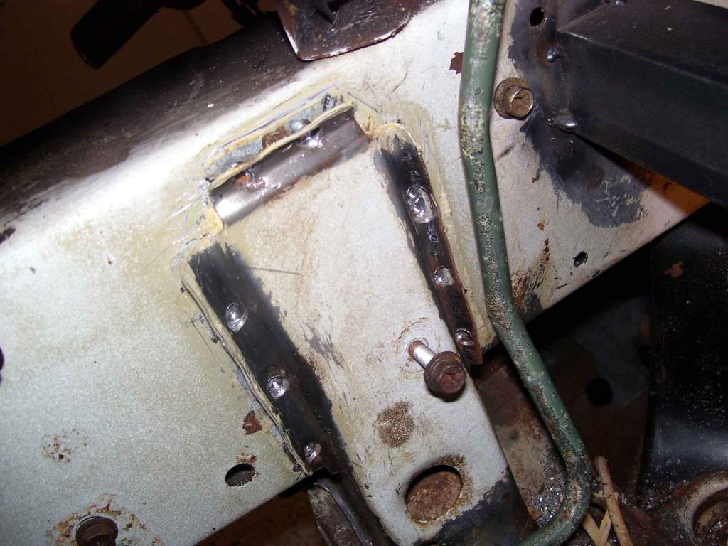

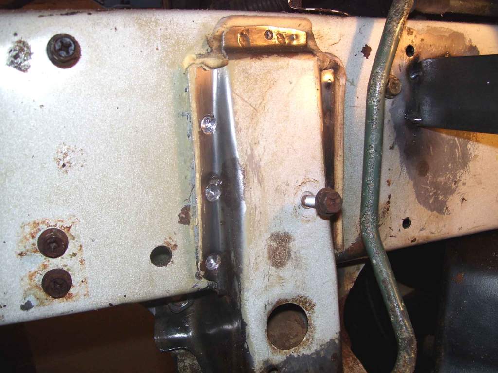

Started the long road of spot weld removal today, it's going to be a long night.
Can't wait to get the rusty thing out.

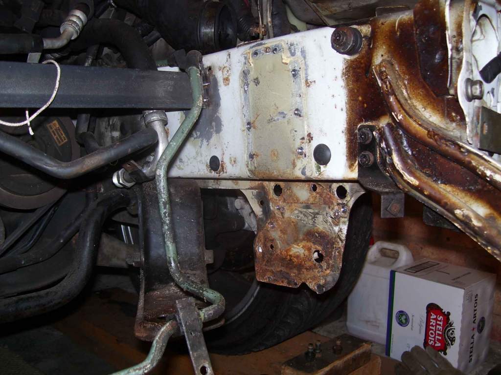

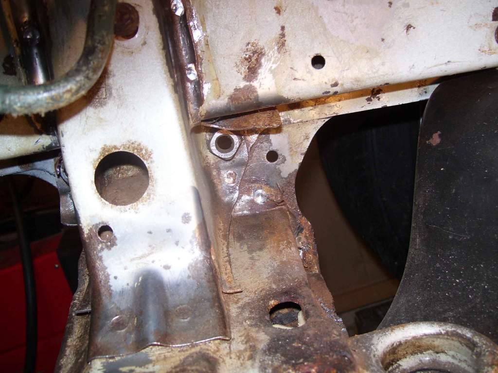

Well, after what seemed like an eternity, I managed to locate and drill out all the spot welds on the drivers side.
Even the hidden one that had to be drill from the other side.
Here's a couple of pictures just be for I removed the first half.
Well done Dave! When does the replacement turn up?
Tomorrow! :hyper::dance:
This is good work, nice to see someone tackle a job correctly :thumbup1:
Thanks mate, appreciate your comments. :thumbup1:
And?-did the legs move?, looking good mate.
No movement at all when I cut through the middle of the crossmember, thankfully.
Just hoping that there hadn't been any movement when the initial collapse happened.
I guess I'll know for sure when I offer up the new one.

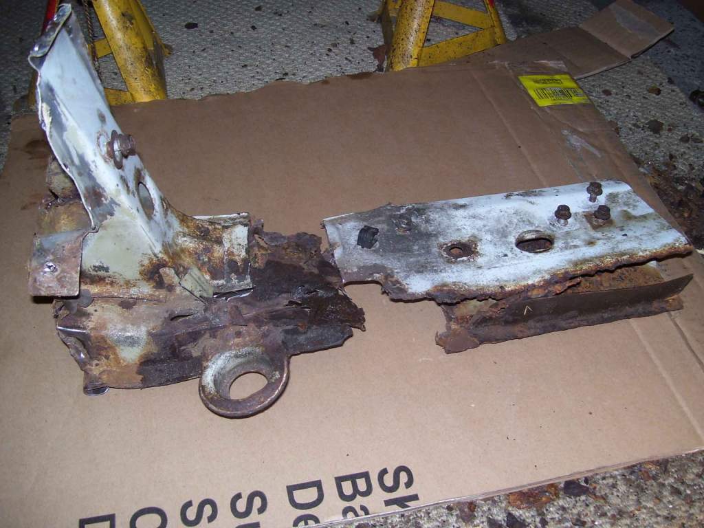

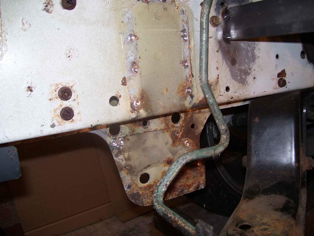

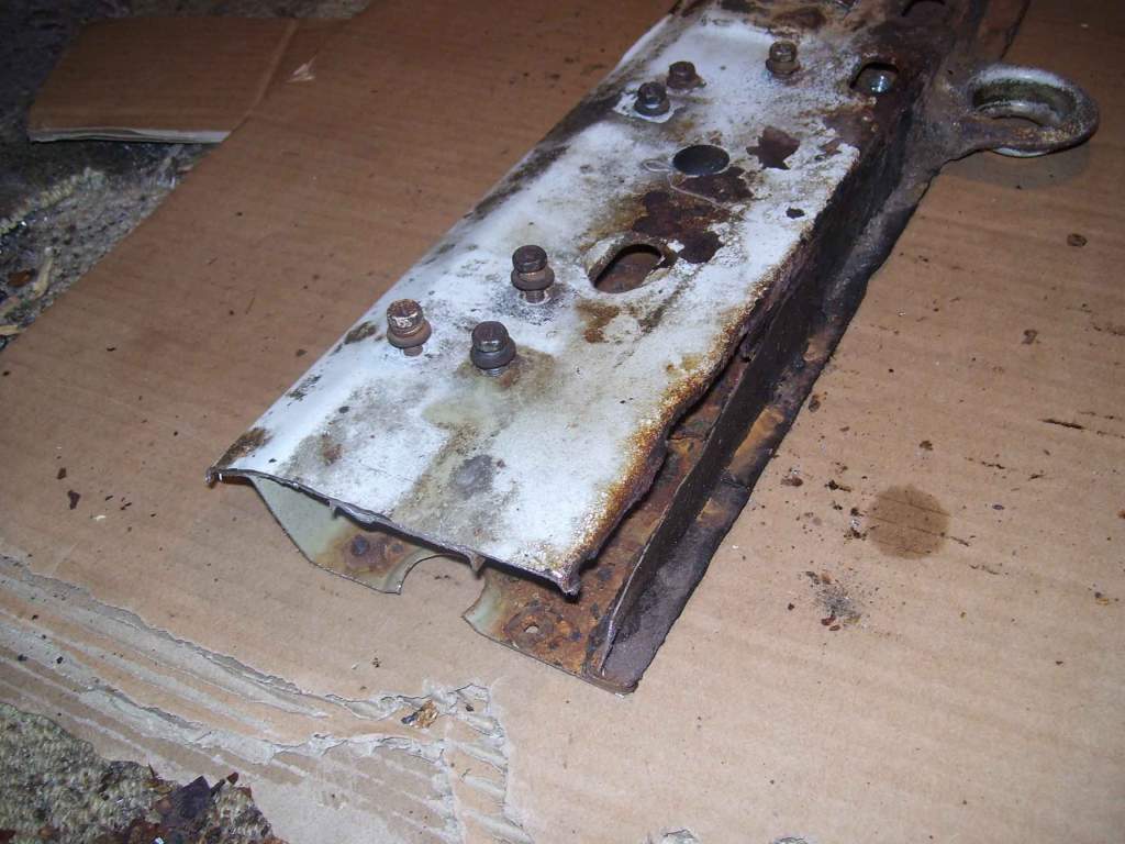

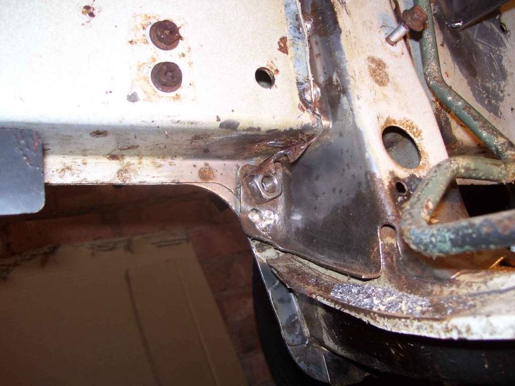

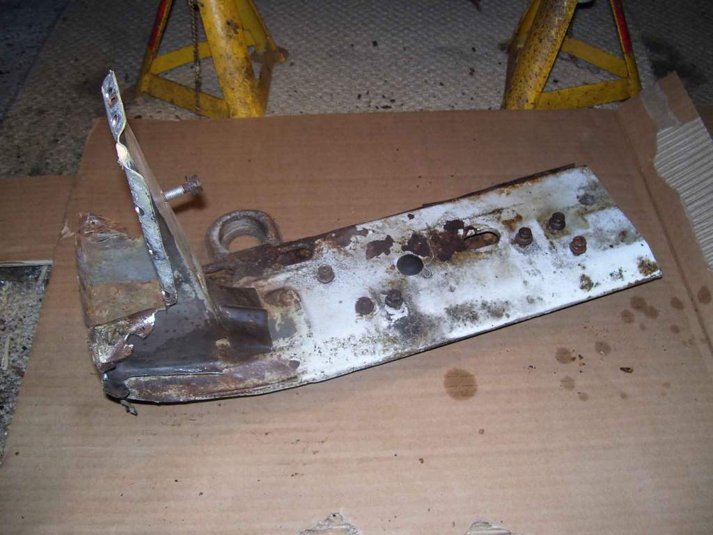

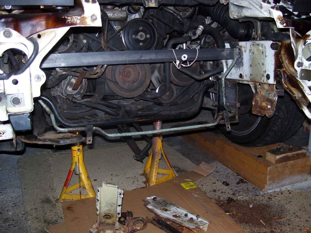

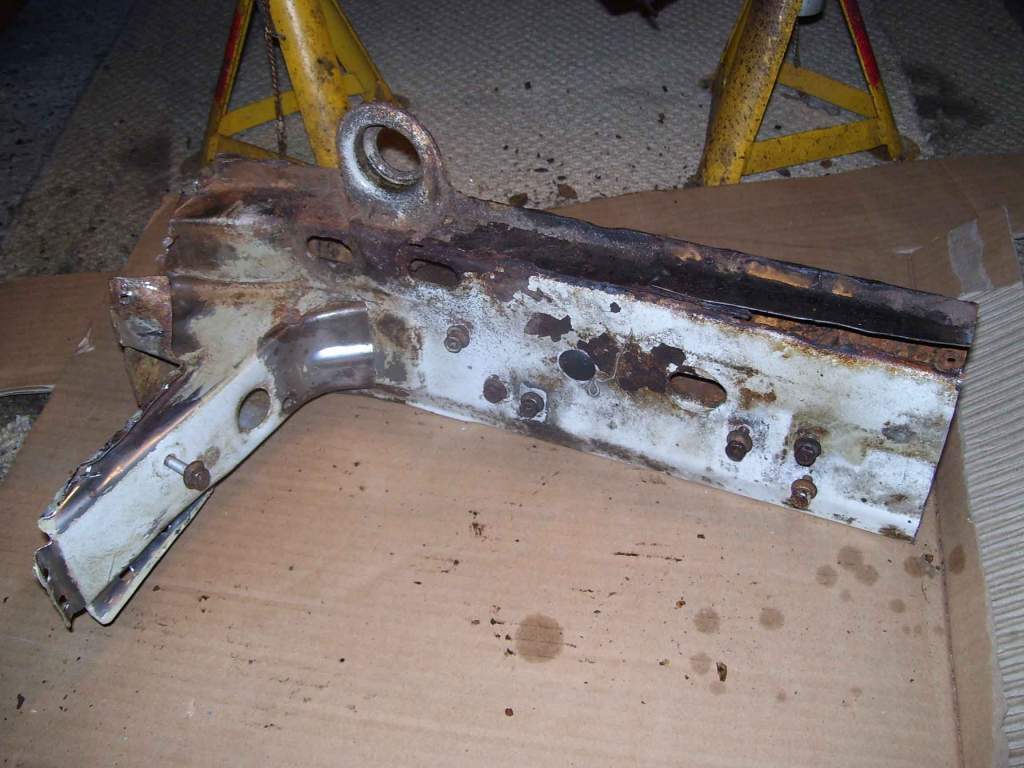

Thanks guys, I do appreciate your thoughts and encouraging words, especially after tonight's escapades.
I thought the first side was challenging, but it was nothing compared to this side.

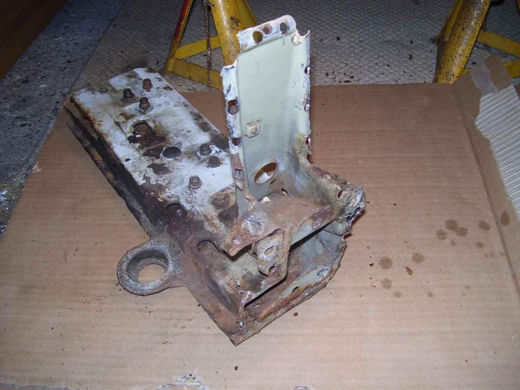

Why change the number and position of the spot welds? not to mention the hidden ones.
Anyway, after several hours attacking the little blighters, I then discovered that the bolts attaching the damn thing to the tie rod bracket were just spinning, the fixed nuts had rotted though and yet somehow were still retaining the thing.
Still it's off now and thankfully the chassis side of things seem to have stood up well.
