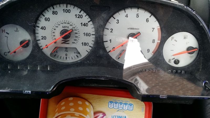

The speed sensor talks directly to the speedo cluster which THEN sends out a speed signal to the steering ECU, HICAS ECU and so on.
These speed convertor chips are essentially just a divider, they fool the JSPEC cluster by reducing the signal from the speed sensor by 1/3rd, hence reading the equivalent of MPH instead of KPH.
The trouble is that this reduced signal is also passed on to the other ECUs which makes for lighter steering as it thinks the car is going slower than it is. The same for the HICAS response.
Using a UK cluster leaves the speedo signal at 100% and so the signal is passed on to the other ECUs at the correct value, so the speed related steering assistance and so on are as Nissan intended.
Simples!
I suspected that a converter was messing things up as described by FunkySi and lonezedder. That makes sense.
So the options are:
1) converter - needs an mph sticker, looks weird (sweep is changed) and messes steering / HICAS feel. Removes the limiter, I think.
2) mph dial face on JDM clocks - no misreporting to affect steering, HICAS, need to get at clocks, removing / replacing speedo needle not easy for cack-handed like me. Keeps limiter and speed bing on cars which had it (me, I like it, but I'm odd)
3) UK clocks - needs getting at them (and cutting the track or have I misread?), cost and either your odometer is reading wrong or you need to find someone you trust to do the odometer thing (and, more importantly, document it enough that the person who eventually buys it from you, trusts you). Removes limiter (180 km/h = 112 mph) and, I think, bing.
4) keep JDM clocks and use different speedometer (satnav, ECUTalk, aftermarket) - could be free, doesn't need binnacle disassembly, doesn't mess with steering / HICAS, doesn't make needle sweep look odd and - for those with gold-faced clocks, is about the only answer. Plus there is no issue over "what does the tripmeter say" it's all kms (not part km, part mph or clocked).

I could be wrong, but unfortunately I believe that the UK clocks are only compatible with s1 and s2 cars, possibly s3.
S4+ have completely different arrangements at the rear so plug n play is not possible. I sure some very clever bright spark could make it all happen though.
I suppose to keep everything as Nissan intended in terms of steering weight etc, the best bet would be to change the dial face for some 0-120mph dials, I've seen a few of those and it still looks better than the standard JDM face some how as they have both mph/kmh scales.
The speed limiter is obviously still active though, but maybe its not a bad thing these days - 112mph is plenty fast enough and it might save you from having to prove your car and blowing the engine at some stage!:lol:
If later clocks are anything like the r33 ones due to the later electronic hicas, then I can recalibrate them into MPH, while keeping the speed signal unaffected. I'd need to see a later cluster to confirm though.

Yeah the plugs are different on Series 4 and later. Why Nissan felt the need to do that and to delete the boost gauge is beyond me! Any pennies they saved deleting the gauge must have got lost retooling for the plugs. It's a right pain if you want an OEM boost gauge because you can't swap in an earlier set of clocks, UK or not.
You have misread. You do not need to do anything.

Well, apart from finding a set of UK clocks, taking the binnacle apart and changing the UK ones from the JDM ones. Plus recording your km / miles old and new tripmeters well enough so that you are believed.
Why do people need to cut the track on the back of the clocks - is that just for adding a converter to JDM to read mph?
No idea, that's a new one to me.
As for fitting, it takes me the best part of 5 minutes to remove a set of dash clocks. The rest is easy enough too. :)
The track cuting is for the convertor. Never liked that solution myself as it's messy. Much better to splice into the wiring.
