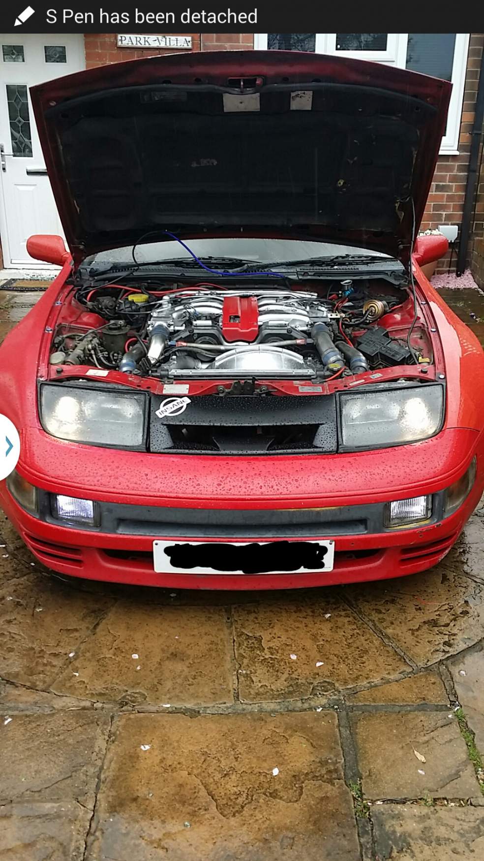

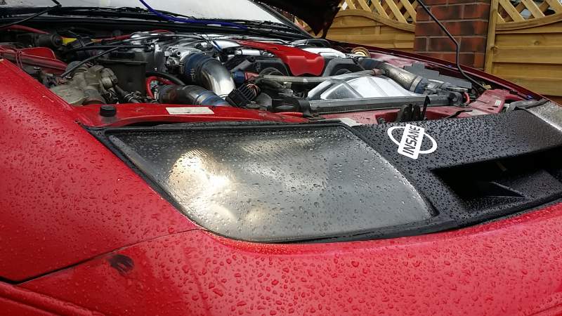

Series 2 ptu installed aswell as a new fuel filter and osram night breaker bulbs. Also an abflug front nose. Runs much better but still a slight miss.
checked the spark plugs and they are NGK plugs but cold ones and because of the idling I do because of traffic they have fouled... getting some standard ones delivered today see what that will do :)
Abflug nose looks spot on mate, do you like it? :thumbup:
I quite like the ABFlug nose panel as far as aftermarket nose panels go.....the 'Insane' sticker really does it no favours though unfortunately.

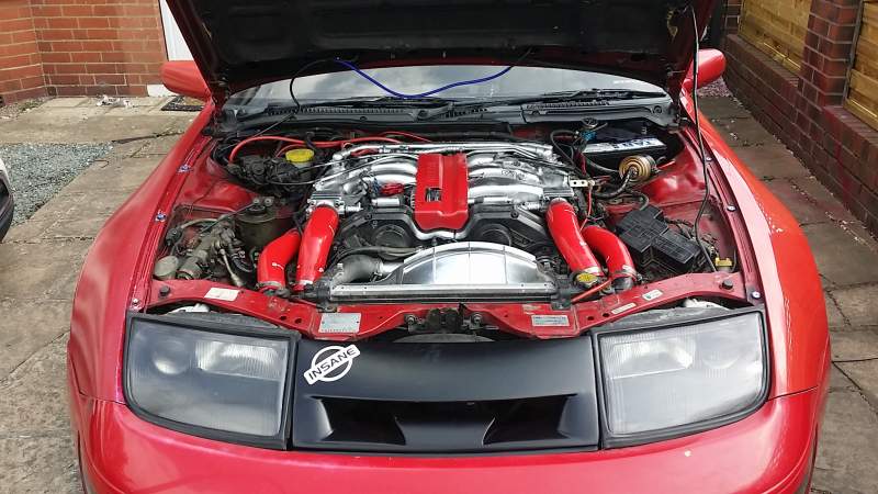

What's with the joining pipe between the two intakes?
Baz love it mate thankyou and that joining pipe is like a balance bar but the car doesn't really need it as it's balanced further up as we know
New silicon hoses. Looks better than the hard pipes imo
